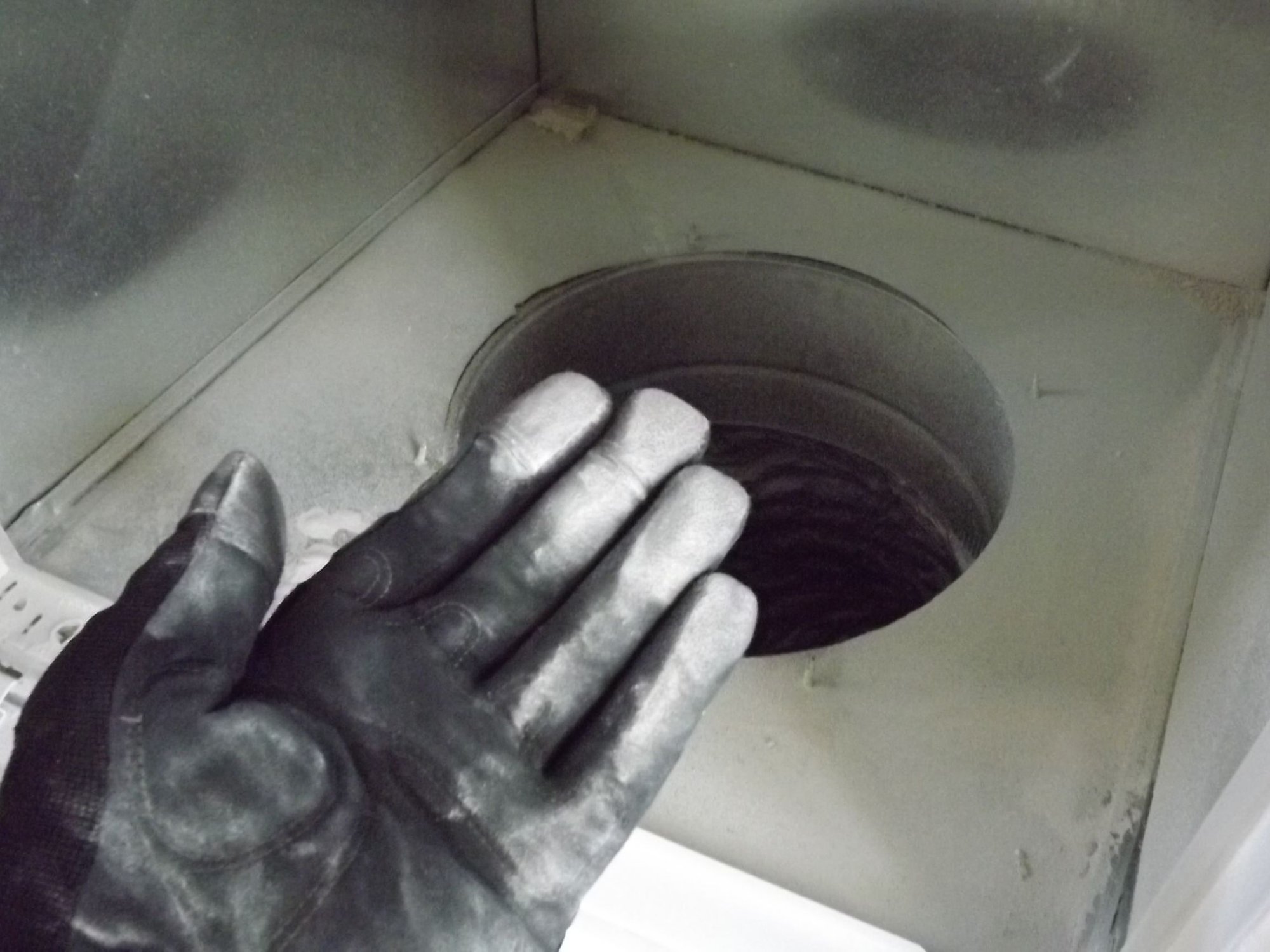

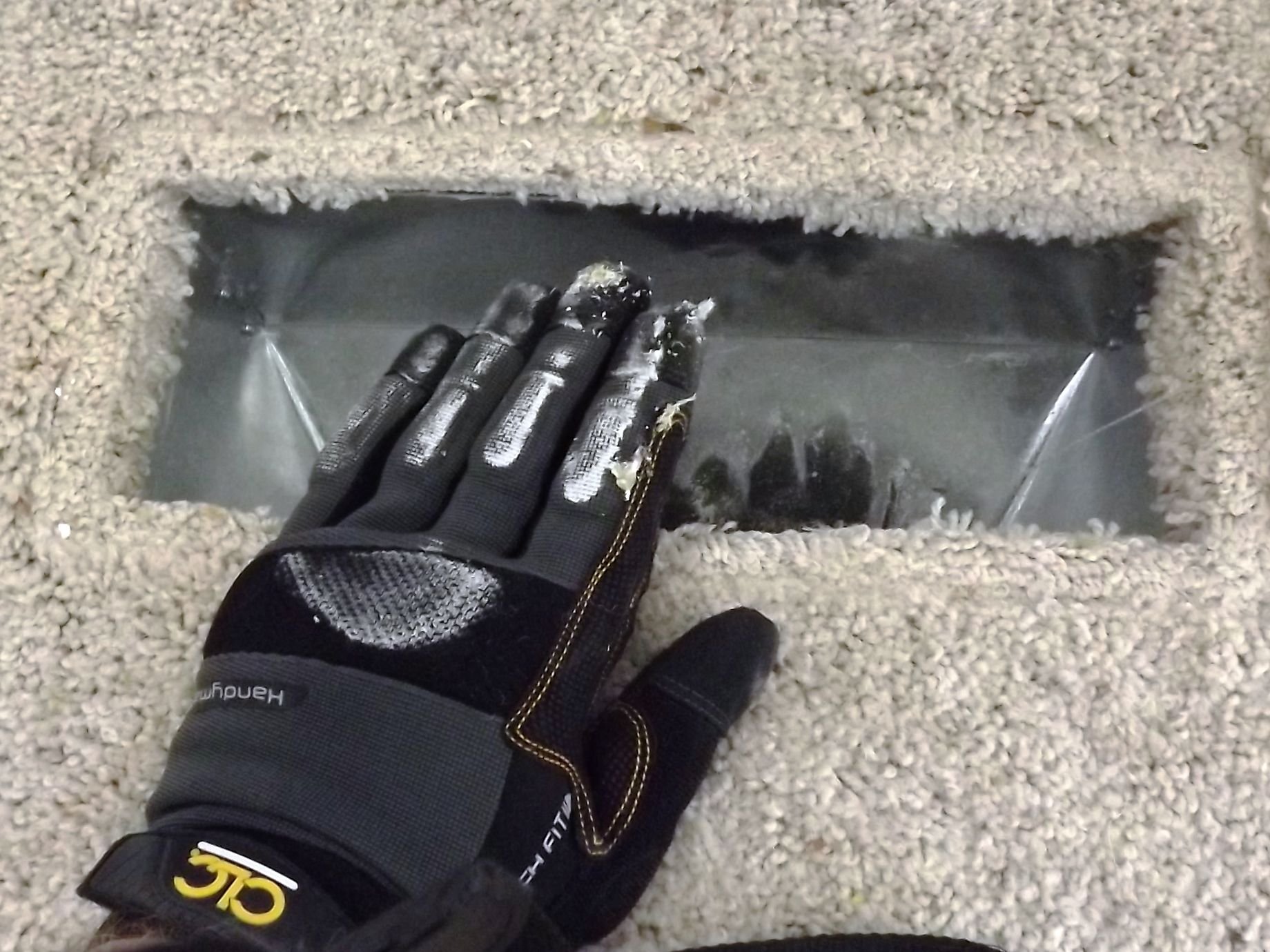

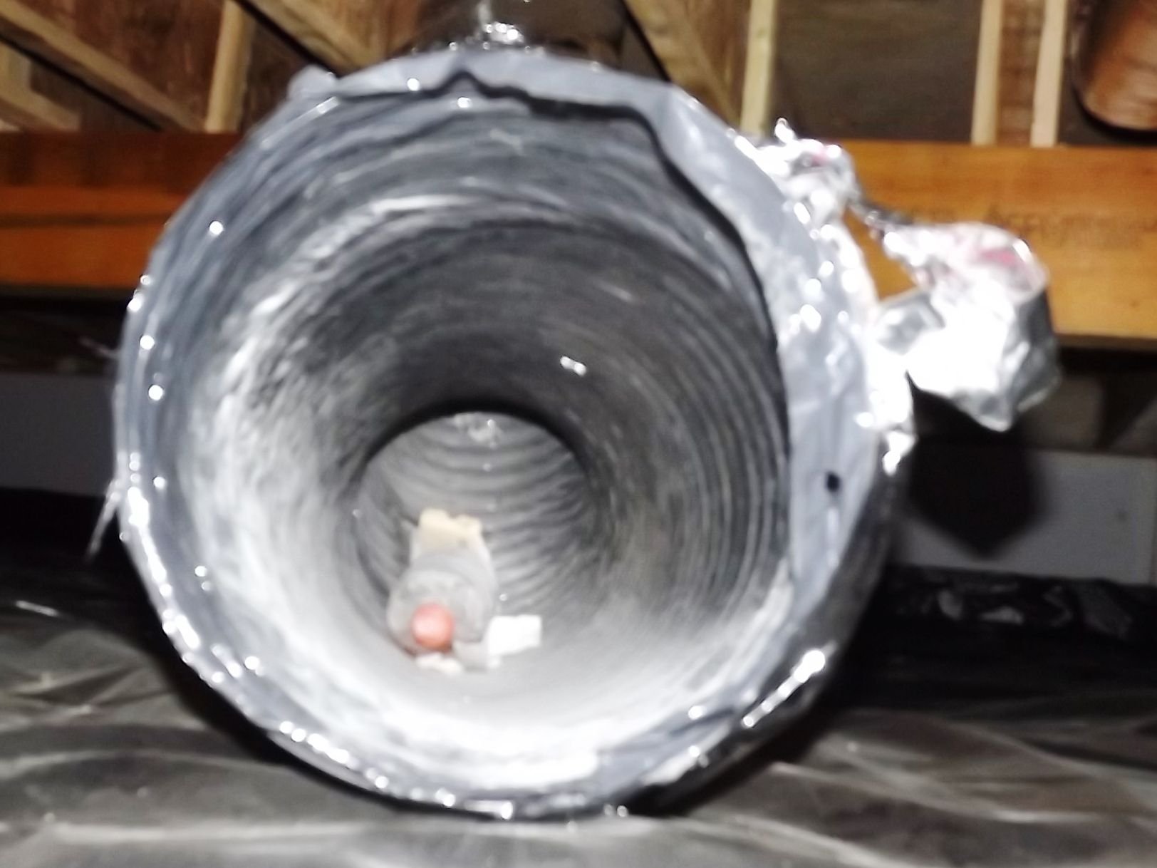

And always check downstream of the filter to make sure there's no construction debris to be recirculated to your living area forever. These images were taken in a DE home billed as a "Health House". The duct is a return duct between the wall-mounted filter and the air mover that separated due to improper installation. Note the debris inside, to include a plastic beverage container.
