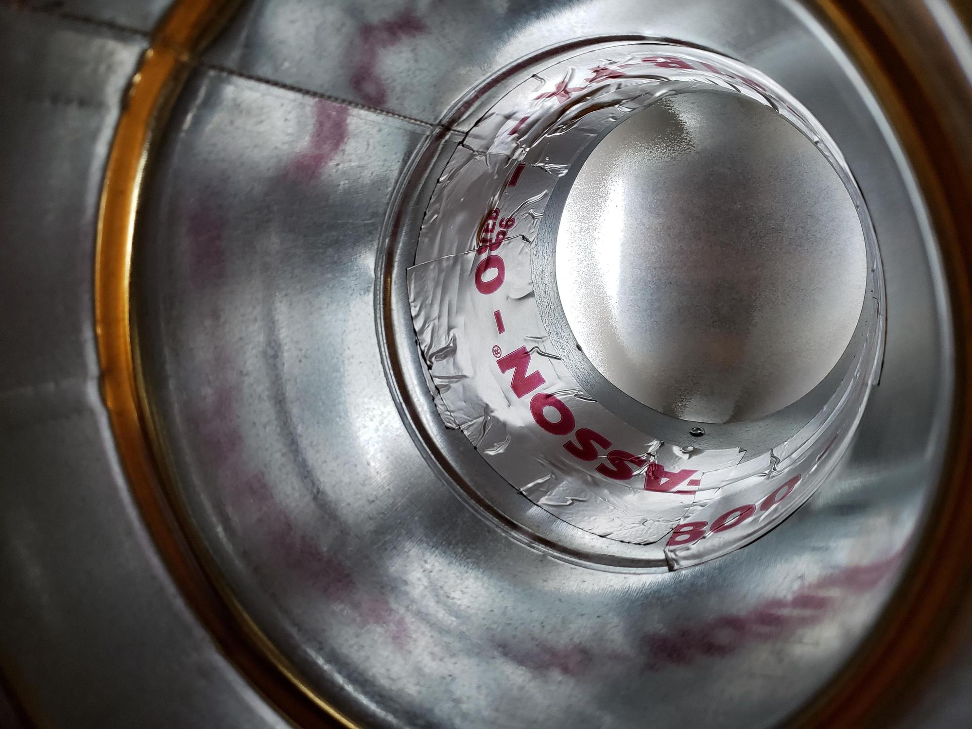

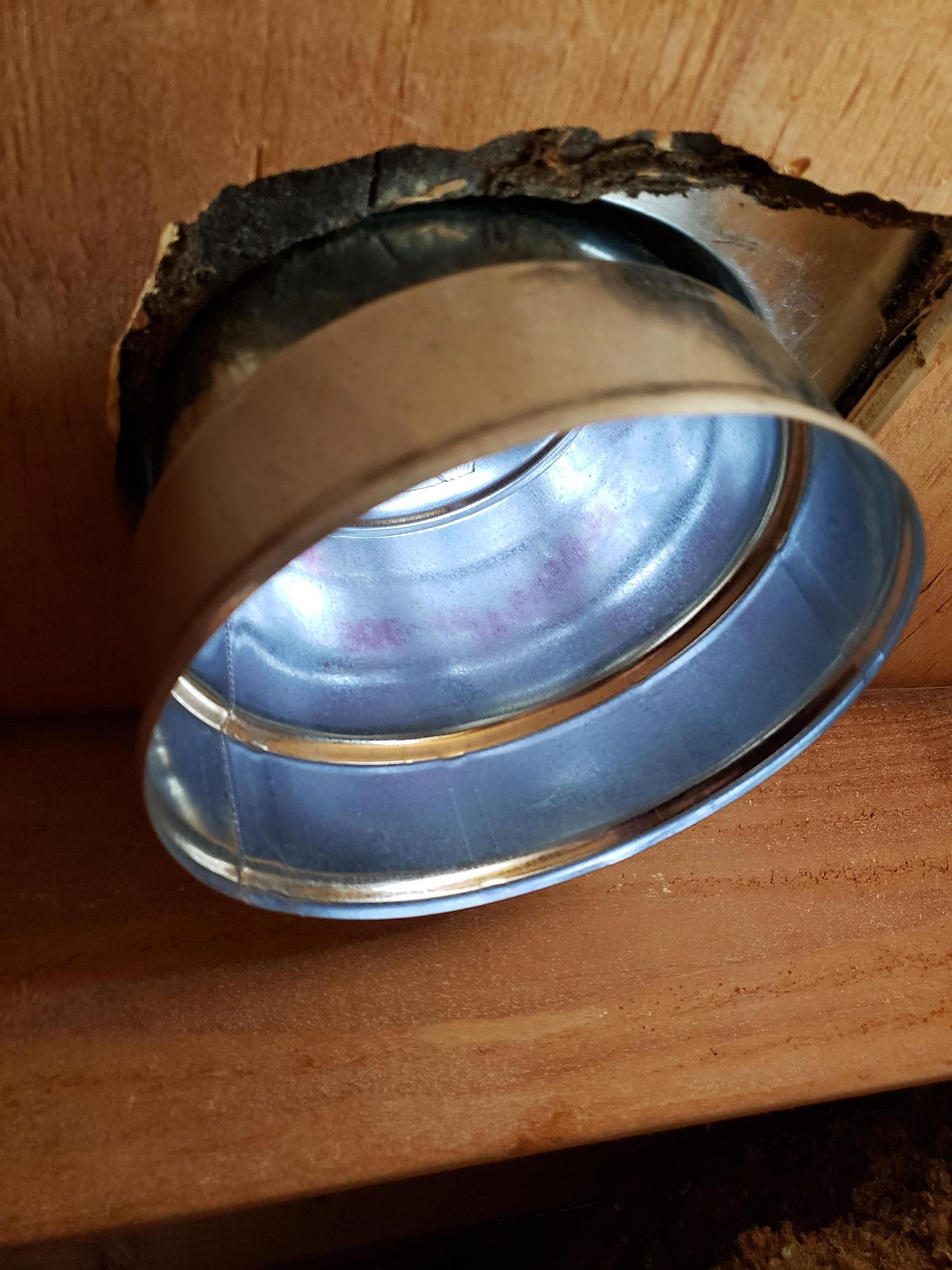

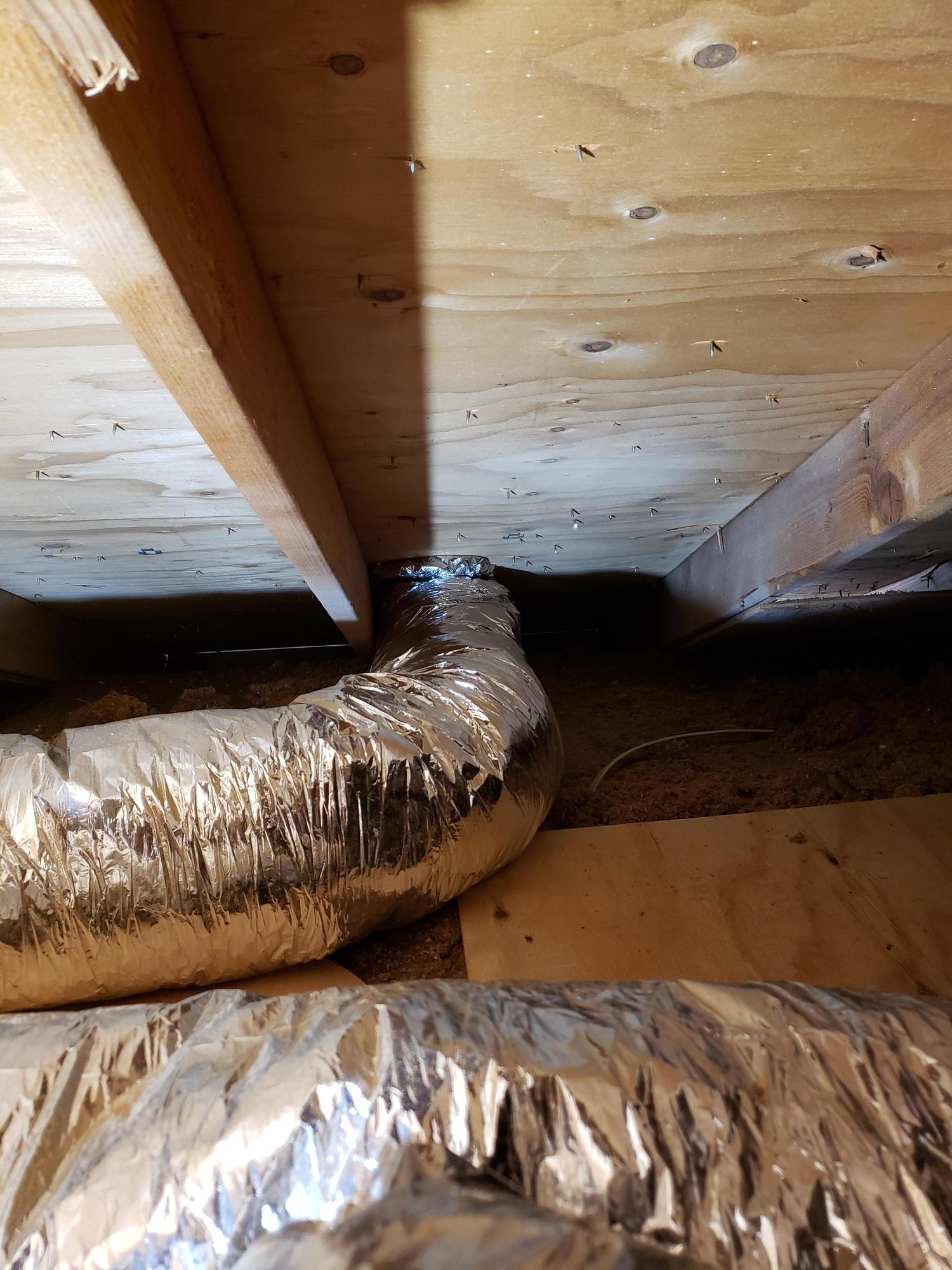

It all worked out! There was not a lot of vertical space under the opening (like 12" or so), which limited what I could do, but also it meant that the duct would be lying on the joists and its weight would be supported.
First I used a Dremel to cut away the plywood that was obstructing the vent hole.
I used a 6-in to 5-in reducer, stuck the 5-in end up into the vent, it fit nice and snug. Then I taped the seam on the inside with aluminum tape. At that point it felt very solid and secure, and i knew it would not be weight-bearing, so I decided it didn't need any other support.
I attached 6" insulated flex duct (because the fan I am installing has a 6" duct connector) to the 6" end of the reducer, using a panduit strap and HVAC tape. Then I pulled the insulation up and used another panduit strap to secure it.
And that's how it turned out. Thanks again guys for the ideas.
