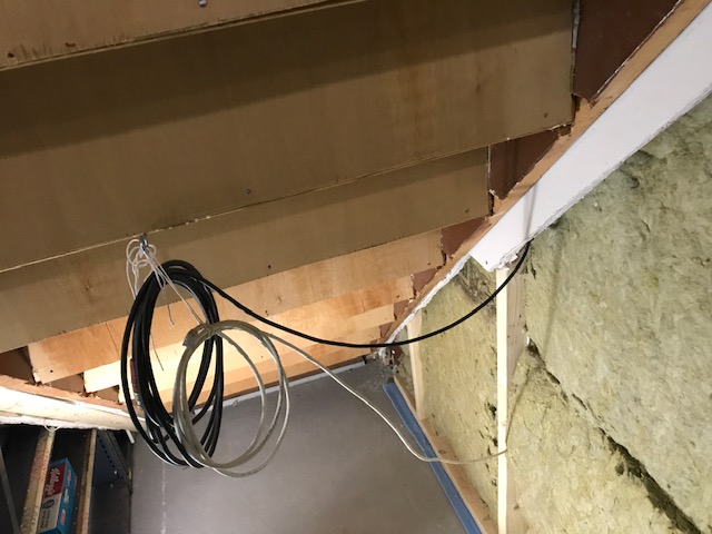

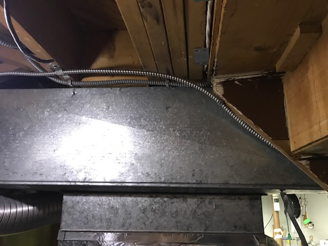

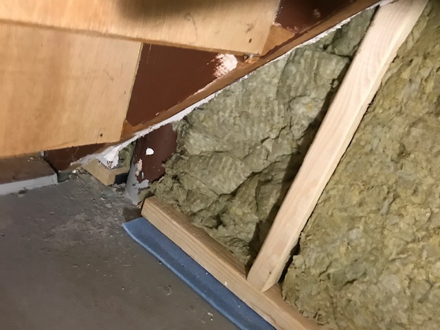

mossman Thanks. I just went back to take a look. Outside of the stair riser I have one, pretty small spot where I can go through. I hope these pics illustrate it.
I can put a takeoff at this spot on the return near the top of the stairs.
I run that across the top riser and down the stringer on the wall that divides the finished and unfinished spaces.
Then down near the bottom there's a small space between the post on the left and stud on the right where I can poke through. The space between the two is 10".
I think I have enough room to do the whole thing with 8" round duct. I'm hoping that's big enough.
This spot would place the return roughly in the middle of the room.... The supply vents are on either end of the room so this would pull air from either to the middle.
On a quick look the only boot I can find is this expensive thing but I suppose I can even just fasten another 8" takeoff to the drywall and put a grill on the other side?
I'd appreciate your thoughts.

To add to the frustration.... I can't find 8" takeoffs and unions anywhere. 6" is the best I can do at the big box stores. I'm calling around to local sheet metal shops not.
