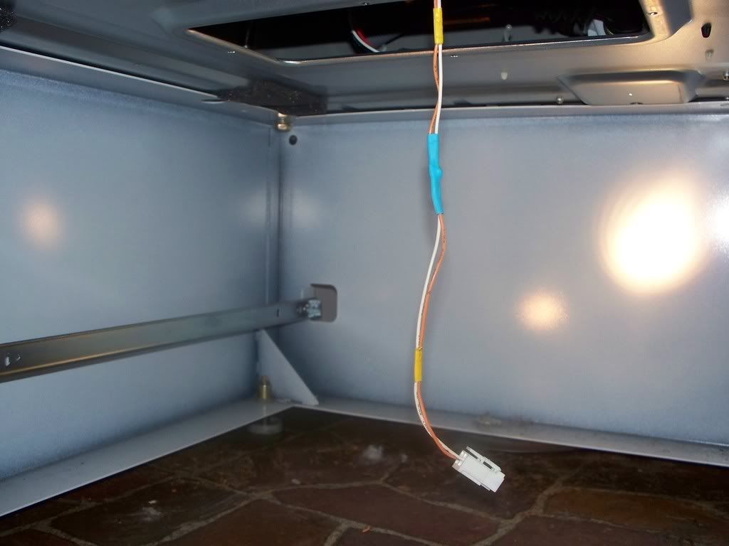

First, 2 wires (orange and white) running to some type of sensor at the bottom of the drum were cut completely in half. It looked like the strap that held them in place had worn completely through the wires.

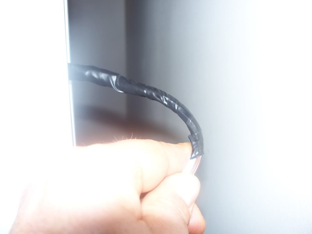

Second, the wire bundle that comes down the front right side of the cabinet that feeds the door lock and door open switch were also worn and bare.

I took pictures of each repair I made, where I spliced the broken wires, and the wire loom used to protect the wiring. The repairs took me a total of 3 hours, at least 1.5 hours of that was figuring out how to get the cabinet apart, and repairs were made more difficult because I did not attempt to remove the boot that goes between the door seal and the drum.

Here is what I found when I took off the bottom access panel
And the repair:
Here is the Door latch harness:
I wrapped the bare wire in electrical tape, then wrapped the harness in electrical tape
Then I placed the harness in a protective loom, and wrapped the loom in tape before I re-installed the latch assembly.
And the repair:
