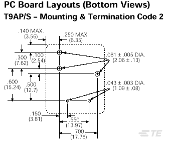

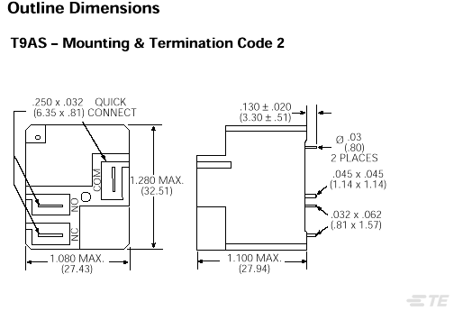

The black power wire comes from the plug and goes to this board..Part Details - WHIRLPOOL Assy Pcb Parts, part number: AP4045210
on the board the part the black wire goes to is T9AS1D22-12 Product Details - TE ...that is it in the first links picture ..black box lower left hand corner of board. Then the blue wire comes out of the black box and goes to the heating element where it burns off it's end. On the site page that shows the black box you will find a link to speck sheet on part. I will try to post image. Can you tell me how to test mine to see if it could be the problem?

Your getting above my pay grade here. I don't know what you are checking? current draw? if current draw you need to clamp meter over one wire, I try to clamp over either black or red wire where it comes out of terminal block. Easier said than done. that weay you will read draw from whole dryer.

I just need to know how to test the black box to see if it is working properly. I don't know how.

Black box I think is heater relay. If heater works it is OK, To test with dryer and heater on,on volt meter across terminals should read 0 with heater off should read 240 volts.
Though of one thing else if you replaced blue wire with a wire to small it will overheat and burn wire, Should be at least a 12 gauge but I would use 10 gauge to be sure. just re looked at your heater picture, You have a Whirlpool made Maytag dryer. Now that I know the black box is heater relay. Work on these dryers every day and have never seen your problem.
