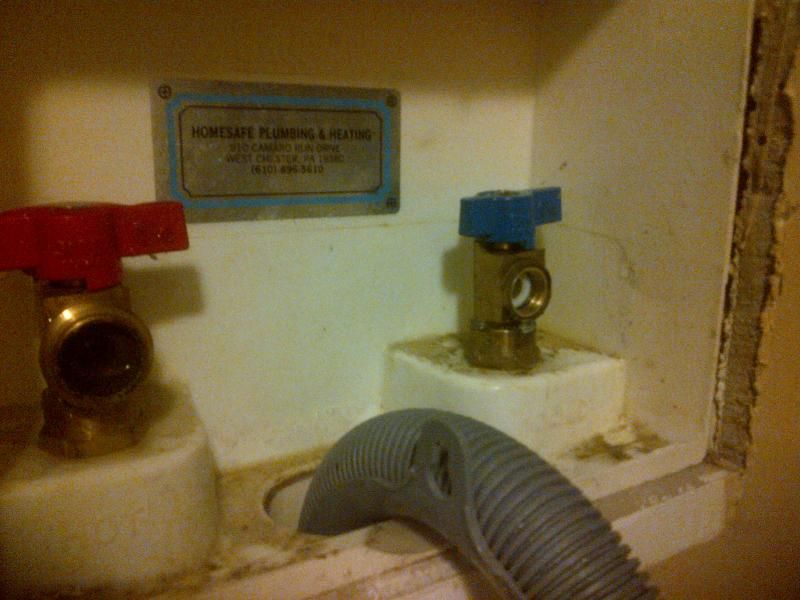

Ok so now's the time to ask, "time to call the plumber"?
I think its called "too much torque" maybe?

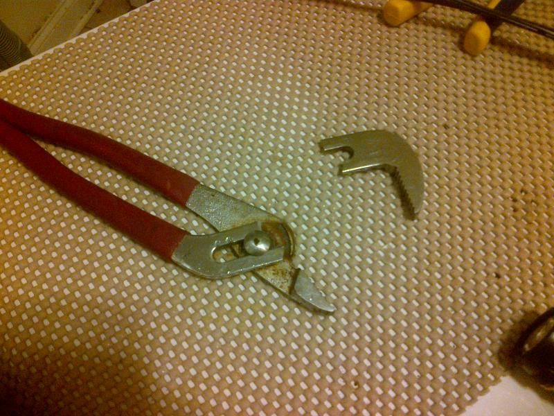

First, a picture of the wrench I broke yesterday:
No big deal. Off to the store today today some new wrenches and PB Blaster.
First sprayed it with PB Blaster and let sit for a few mins.
Then using a new vice wrench and another new wrench in opposite directions, it seemed like it came loose!
That is, until, I got the hose off and water started spraying everywhere!
I checked to make sure I had the valve closed and it was.
So looks like I broke the faucet at the threads:
Good one is on the left. One I just broke is on the right:
A closeup
Had to turn off the water main!
Only reason I havent called a plumber yet is I'm hoping on the outside chance I can fix this myself...before the wife gets home.
Or even slimmer it looks like there's a thread on this thing that, maybe I can thread a piece on the outside?
Uh oh.

Update: while calling plumbers to find out their emergency fees and timing I tried something...I simply re-attached the hose, with the broken piece still inside, to the faucet. It seemed to fit nice and tight. I turned on the water main and...no leaking! Wow. I have the other end of the hose sticking in the sink drain just in case. but this means no emergency fee or late hour visit by the plumber and I can schedule a normal appt tomorrow. that is....unless...I can fix this myself :-)

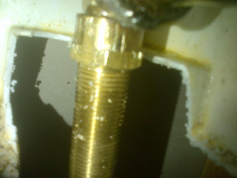

Here's what the fixture looks like after I broke away part of the plastic box - originally I thought I could just remove this piece. But after a closer look it appears the faucet is attached to the threaded piece permanently.
And further down you can see the threaded piece is soldered to the cold water pipe

You know....that sure looks like a seam in the valve. Does the top valve come off the water line. Looks like a set of flats for a wrench on the bottom piece.

PJmax, I don't know. But I too was thinking maybe I could remove it. I gave a couple tries and then decided I've done enough damage :-)

Looking at the pictures, I agree with PJmax's thoughts.
Take a look at the valve and see if there is a seam between it and the lower "nut" as indicated in PJmax's photo. if so, pbblast the seam, allow to sit for ~20 minutes, and try removing, using a wrench on both the valve body and the lower nut. Be sure not to apply stress to the lower threaded section as you don't want to break the solder.
Be patient and if it doesn't come off easy, pbblast again, go watch a show and try again.

Turn your water off again and remove the hose. Look in the part that is stuck in the hose, the part that should stay with the valve, and see if it has a hexagon shaped hole. If it does then take it to a tool store or tool rental store and find an Allen (hexagonal) wrench to fit. Use a good pair of Channellock pliers on the hose connection and back out the valve piece. Replace that valve piece in the valve and turn the water on.
Next time use a bit of plumber's grease or silicone grease on the threads of the hose connection to prevent it from seizing on the threads.
