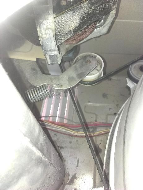

I am trying to decide whether to replace or repair a dryer.
It is making a squeaky noise when running. It does run, just very squeaky noise, and the noise is not consistent, it may squeak for a minute then quiet for 2 seconds.
MAYTAG MODEL MDE8506AYW SERIAL 13560639UU
It was manufactured in 1998, so 17 years old.

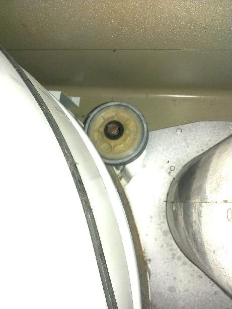

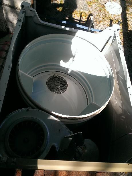

I am not familiar with dryer repair, but since it doesn't really seem to have that many parts, I took the dryer apart to look. I was looking at all the moving parts.
There is a round "felt" on top and bottom of the drum, they look fine, at least not torn apart, so I didn't touch those.
I removed the drum and saw two wheels, and one wheel spinned freely but the other made some noise, so I sprayed some WD40 to the metal "pin" in the middle and it seems to spin much better.
So I reassembled the dryer sat it back up right, plugged it in and turned on the dryer, and no more squeaky noises...
UNTIL a day later and it came back. Not sure what the problem is. Do I replace the wheels, or should I just get a new dryer since it's 17 years old?
Here are some pictures I took of the inside of the dryer.
Should I repair or replace given the look and age of the dryer?

It's probably the belt & or the spring assembly that maintains the tension not the pulley. Replace the belt first..

Those belts are good or bad. Either it looks good or it's all cracked and needs to be replaced. The belts do not usually make noise. The two rollers in the back that the drum sits on are a usually source of noise as well as the pulley that is on the tensioner.
I'll defer to fairbanks..... I've changed plenty of drum rollers but not the actual axle.
I have removed the rollers, cleaned the axles with a light oil and then used some black lithium grease with good results. You want to go easy on the lubricant so that it doesn't run inside the barrel. As mentioned..... WD-40 is not a proper lubricant.... especially in this case.

Rollers and the idler pulley usually make the squeak noise. On Maytags look closely at idler pulley. Good dryer there and easy to work on

Belt on dryer almost never the problem, Replace if cracked or split but belts hardly ever break. Usually all you need to do is take pulleys off axle and lube it. Unless you see wear on axle leave alone and usually just a wrench will take them off. Some dryers take a complete disassemble to replace axle, Can't remember if your does. Most squeaks from Maytags I have found are from idler pulley and I would replace it. Get a cheap pair of snap ring pliers from auto zone or someplace like that, Harbor freight also good place for them. 2 screwdrivers will do it also just more problem.

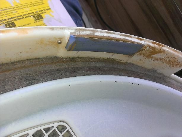

I called up a local appliance parts place and checked to see these items are in stock.
The guy asked me what problems I have on my dryer. I told him about the squeaky noises. He told me most times this is wearing of the guides causing metal to metal contact and I need to replace the guides.
So, the guides are the two blue color strips in my last picture on the first post right?
I really don't want to remove the dryer, take it apart, change one part, put it back together and see if it fixes it, and if it doesn't, try another part and repeat. So I might just replace all these:
Roller axles (2)
Drum support rollers (2)
Belt tension pulley
Belt
Guides (2)
Is that it? Anything else I might as well do while I am in there? I hope they don't add up to the cost of a new dryer LOL.

Been retired a couple of years but if I remember right there are 4 glides, 2 blue, 2 grey and in over 10 years I have replaced 1 set. Yours are riveted in and unless they are torn or worn out i would leave them alone. Not to expensive so if you want to get them to have if necessary. Ask if they are returnable as I don't think they will be needed.

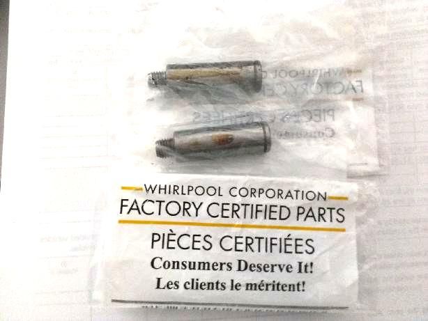

OK I bought some parts - new rollers, axles, pulley etc...
and they arrived today.
Problem is the new axles still in bags, are rusted. Here is a pic.
At first I thought they were lubricant but they are not, the shafts are not wet and they have this brown spots all over and they look like corrosion to me.
Should I be concerned or no problems?

if just spots should be ok. look closely or pits where spots are.

I opened up the dryer.
Removed the rollers, the axles, the tension pulley.
Put on the new axles - by the way the old axles look better than the new somewhat rusted axles but I replaced them anyways. The nut behind the axle is hard to get off on the right side where there is no room for a socket wrench. Put on new rollers and the tension pulley.
There is a lot of lint inside the cabinet, I spent more time cleaning that up and it filled a two gallon bucket. I wonder if it means I have some leak in the duct.
One thing is, the new rollers come with two washers, one on the back and one in front. When I removed the old roller, it had the same black colored washer in the front, but a thin metal washer in the back.
I put it back together and no more squeaky noises, so hopefully it'll stay that way. I didn't lubricate or grease up any parts.

A lot of lint in dryer usually means a clogged vent to the outside, Clean vent from dryer to outside.
