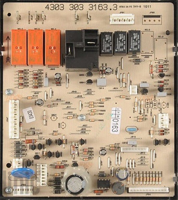

Received 1,118 Votes on 1,038 Posts
Ok... I marked the board with the three relays.
Measure across the yellow blocks. (convection)
Measure across the red blocks. (bake)
Measure across the blue blocks. (broil)
All three should show open.... no continuity. You'll probably find the bake one shorted. You can pull it out and swap in the convection relay if you need the oven. Post all the numbers on the relay or post a picture here on the board. I'll tell you where to get the relay.

I didn't put this on photobucket but this is a closeup of the three orange relays and the big black one. Every solder connection in this picture, basically all the heavy relay and wire connections, needs to be resoldered before they melt. They are in pretty poor shape now. Don't resolder until the defective relay is identified.

So I checked all those points and no continuity across any of them...... So I'm assuming that means they're ok. But I did find out there is continuity across a handful of wires that seems really odd.
There is continuity between the green wire in the bottom left of the pic (this is a ground wire, that wire is only about 8" long and is held onto the metal body of the oven with a screw). So there's continuity between that green wire and all of the other wires I've marked. But the connection between all of those wires is not a result of the board... I can unplug all the wires from the board and test all the contacts on the board and no continuity. But If I just test the wires themselves (even unplugged from the board) the continuity is there.
So I'm assuming:
1) That there shouldn't be continuity between all of those wires, (maybe I'm wrong on that...)
and
2) Something elsewhere is "stuck" causing that continuity.

No problem.
Those three orange relays control L1 power to the elements individually.
The black relay supplies L2 to all three elements at the same time.
So in order for an element to heat..... L2 must be on and whichever individual relay that is required for the selected cooking process.
Since you are getting an element heating all by itself, and the relays all show as normally open, the problem must be that the control board is telling the element(s) to turn on.
Make sense ?

I'm concerned about which board has the problem. The board you were working on is the relay control board. The other board where the buttons are is the oven control board. The oven control board sends commands to the relay board.
I would expect the problem to be on the relay board.
