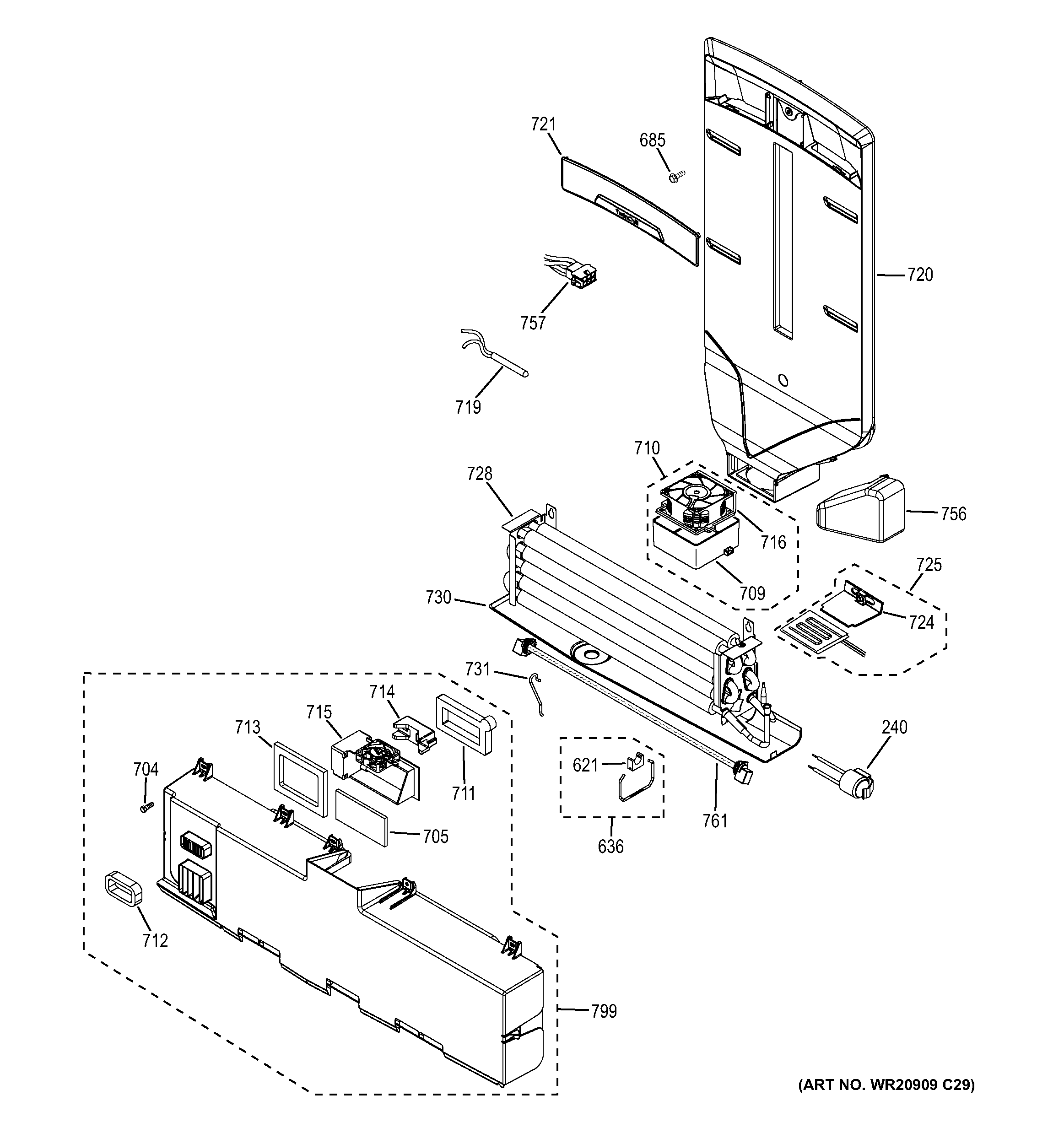

The fan seems to be located in the lower rear and follows an air channel up. I don't see any fan topside in that unit.
Looks like pictorial part 716.
FRESH FOOD SECTION Diagram & Parts List for Model cye23tsdcss
sears parts direct/png/PLDM/H1411276-00008.png

Yes, for some reason, the sound has quieted down a bit but still much louder than usual. And it more clearly is coming from the mid/rear, where that fan is located.
Not sure why the sound initially was coming from the ceiling, maybe it was being sent out through the top vent. There are no moving parts in that part of the fridge.

The repairman opened the rear middle part to expose a lot of ice on the condenser coils, probably similar to the situation in this video https://www.youtube.com/watch?v=eSbruQKxSq8
The fan was replaced, and putty was added to the cover edges to help make a better seal to prevent the condenser from icing over again. Let's see if that's a fix, we're still hearing a loud whirring sound but not quick like the initial sound.
