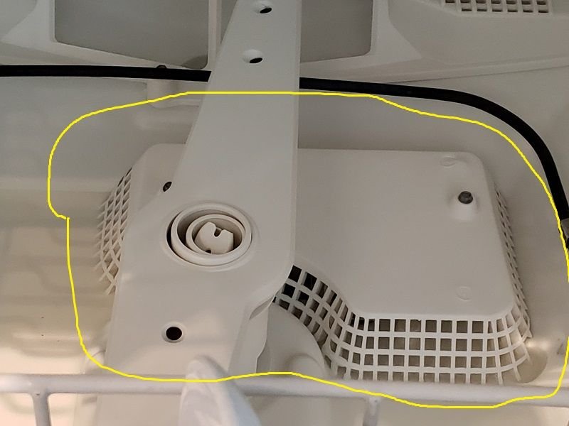

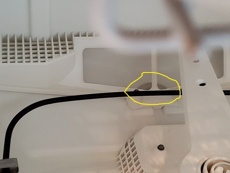

Do you think that too much water is building up in the dishwasher when I run it? Please take a second look at the last video. If so, do you think replacing a drain (or some such thing) in the dishwasher would help?
Please look at the attached images. Water usually builds up around the "cage" in the center after washes and takes forever to drain, and never really drains completely. I'm thinking that maybe the gasket is off a little bit because of the new position of the dishwasher and now it cannot handle this unduly large volume of water. Is there some drain under that cage that can he cleaned out or replaced?
Alternatively, the other picture shows what looks to be some type of drain in the back of the dishwasher. Same question: Can you clean or replace it and, if so, do you think it would help lower the water volume?

It could possibly be a partially clogged drain. You should be able to remove the screen and clean the drain area.

No, I don't get any water in the kitchen sink when the dishwasher is running. And, no, the kitchen sink does not drain slowly.
So, you recommend removing the screen, looking for a drain, and cleaning it?
Also, what about the circular part in the back which also looks like a drain? I believe it is called "piston and nut."
Yes.

Drain/outlet doesn't seemed clogged
Take a look at this vid. It doesn't seemed clogged, and it is apparently normal for there to be some water there. Perhaps this is a bit too much. Does this give you any ideas? Would you recommend taking a wet vac to it? I'm afraid that I'll suck out a part or something.

Also, I just removed the piston and nut (the "drain" way in the back) and I really didn't see anything. Looked clean. I wiped what I could with a paper towel but I highly doubt that's the culprit.
Yes water to be in the drain sections is normal. And I agree it looks clean.
