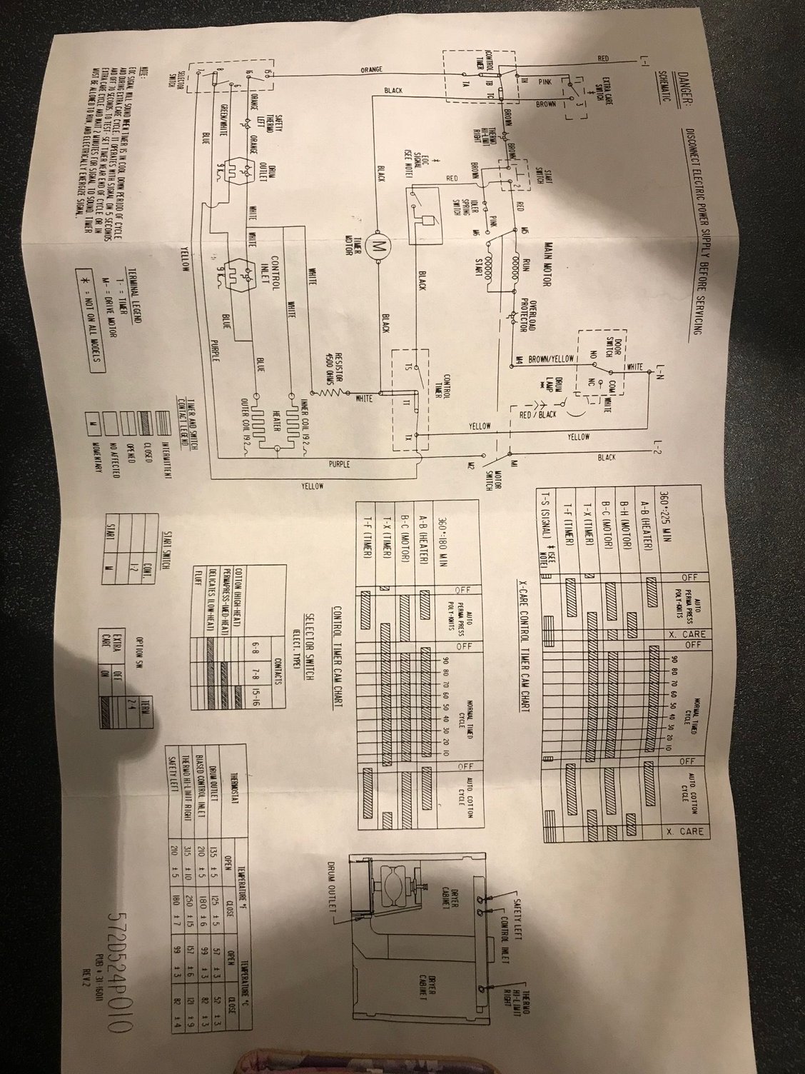

If it has a wiring diagram.... take a picture of it and post it here.

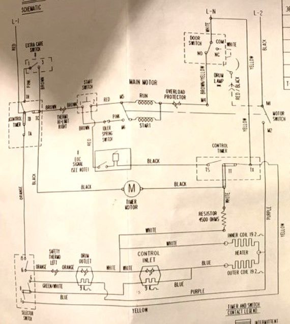

The model number is 67571T5WW. I've attached a photo of the wiring diagram (I think!).

Sounds like the wires are on the wrong door switch terminals.
Brown/yellow = N.O.
White = common
White to light = N.C.
Brown/yellow = N.O.
White = common

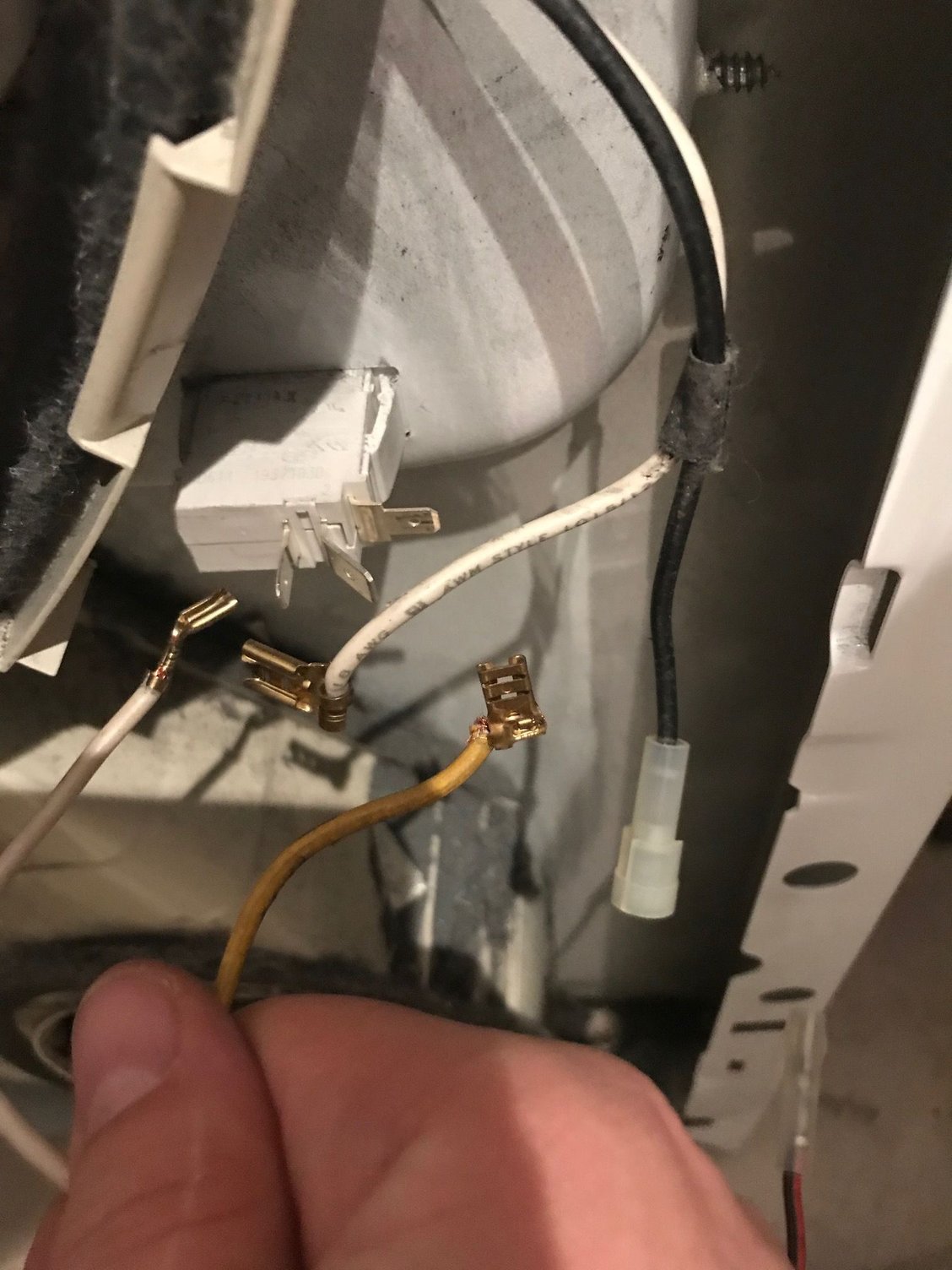

Join Date: Apr 2020
Location: Canada
Posts: 6
Received 0 Upvotes
I took a photo of the door switch and the wires that I have. There is one white wire that only fits on the middle prong, and I've tried the other white and yellow wires in both possible orientations (along with the black wire). I've also noticed that there is some damage to the yellow wire, possibly from the fall - do you think that this could cause the problems?
Thanks again!
Ryan
