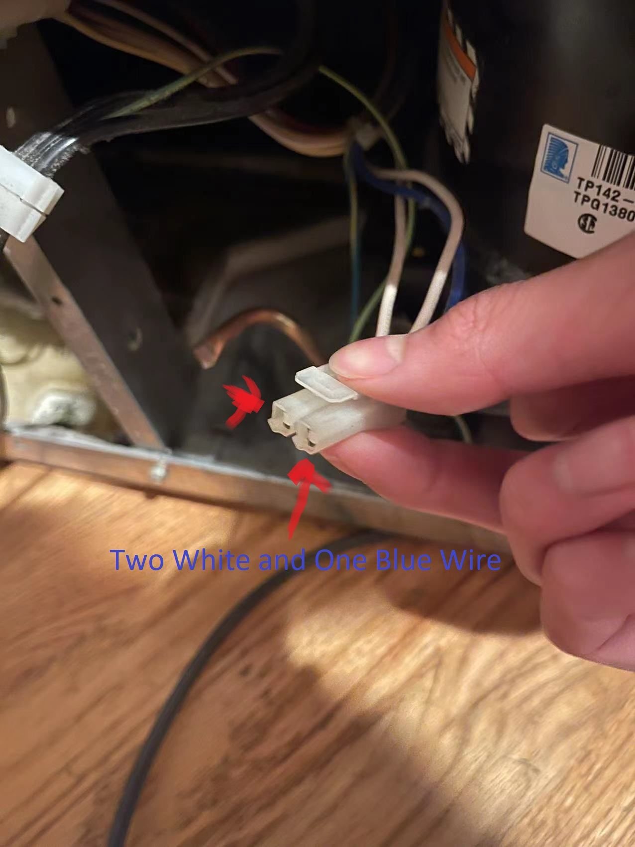

The diagram below is from the wiring diagram. The condenser fan and the compressor are connected together using white for neutral and blue for hot. That means if one has power... they both do. Double check you have 120v on the blue and white wires at the compressor. If you do... the problem is in your start relay assy.

Hello PJmax,
Here is the picture of the adapter.
Question1> Do you want me to test the two holes of the adapter?
Quesiton2> Based on the diagram, both fan and compressor share the same blue and one white wire.
Does the extra white wire connected to the adapter is used to control when the compressor starts?
Thank you
Old 08-03-22, 12:56 PM
PJmax's Avatar
Join Date: Oct 2012
Location: Jersey
Posts: 65,967
Received 4,149 Upvotes on 3,726 Posts
Yes... check at that plug when the condenser fan is running.
The two white wires are incoming neutral from the power cord and out to the rest of the fridge.
They are tied together in the plug.

Hello PJmax,
I will use a multimeter to read the voltage after I back home.
Though, I tested the adapter has power with a noncontact voltage tester this morning and the tester shows the adapter has power right after I plug in the refrigerator.
Question> Is it true that the adapter should only have power when the control board calls for cooling in normal conditions? In other words, does the adapter have power when the compressor is OFF?
Thank you
Old 08-03-22, 01:21 PM
PJmax's Avatar
Join Date: Oct 2012
Location: Jersey
Posts: 65,967
The neutral is always present on the plug. It is the hot that is switched.
Yes... it needs to be in cooling. When it is... the fan under there should also run.
q0987 voted this post useful.

Hello PJmax,
I just tested the two terminals of the wire adapter and it shows 120VAC and will report back after I get the new compressor relay and capacitor.
Thank you!
