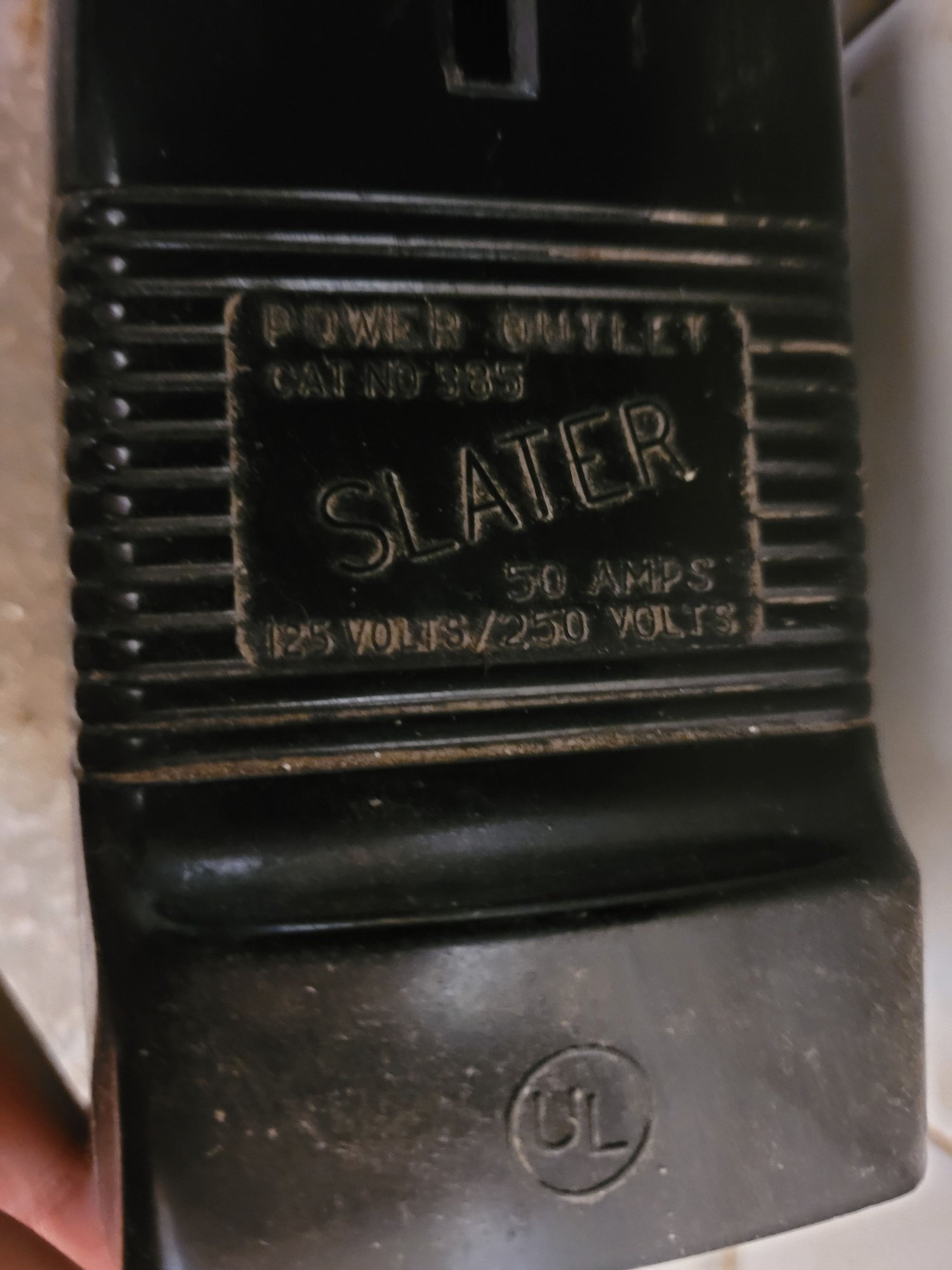

How do I get a new stove that is compatible?
Join Date: Oct 2012
Posts: 240
Received 0 Upvotes
How do I get a new stove that is compatible with this socket and the electricity in my house?
That appears to be a 10-50R receptacle. The (top) vertical slot is the neutral, and the two slanted slots are the 240VAC (120VAC from each to neutral). If the stove you're interested in purchasing doesn't come with a compatible plug, you can purchase a new 3-wire cord set that is compatible with your receptacle. Here's an example of cord set: https://www.amazon.com/EZ-FLO-61242-...dp/B011P2H3GA/

So if I remove the existing cord from my old stove, I may be able to install it on the new range as well? Would any new electric stove be compatible with that three prong cord?
Yes.... it's an old style 240v 50A range receptacle.
Most newer ranges are 120/240v.
Most appliances can be wired for three or four prong receptacles.
The wiring of a particular appliance will be in its installation instructions.
The shift towards four wire/slot receptacles is current code for proper appliance grounding.

Yes. The voltage rating is the maximum voltage that the receptacle is designed for. Since 120/240 is less than 125/250, you're fine.
Will they open the box outside for me before they bring it inside?
The 50 amp receptacle/circuit will work fine for a 40 amp range. You may be required to change the breaker if the manufacturer requires a 40 amp max breaker.

The manufacturer requires a 40 amp minimum. The specs say, "This appliance must be supplied with the proper voltage and frequency, and connected to an individual, properly grounded, 40 amp (minimum) branch circuit protected by a circuit breaker or time-delay fuse."
