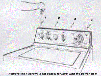

Howdy,
That # worked!!
The buzzer is right beside the timer...you can cut and tape the wires or just pull them off and tape the wire ends.
On this model...may be best to remove the power and remove the screws across the top of the consol, the front of the consol will titl forward towards you giving you access to the switches and buzzer.
jeff.
P.S. this pic is from the washer sections...but should be the same consol style
That # worked!!
jeff.
