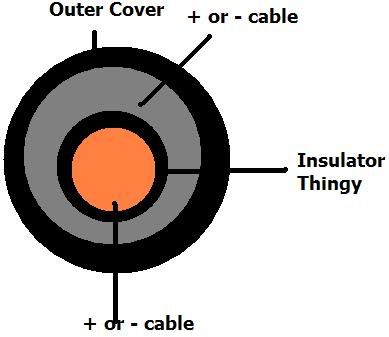

Thanks for the quick reply, but I'm not sure if that's going to work, because here's the way it's done: the negative is wrapped by some sort of insulation thing, and on the other side of the insulator is the positive/negative cable, and when the insulation rips, and sparks start to shoot out...Here's the best I can do to describe it:

It does appear that the problem is inadequate strain relief.
Therefore, reinforcement sounds like a good preventative measure.
