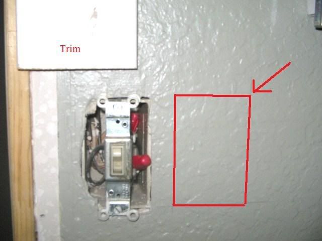

I lied. Sorry guys!!!! I went home and checked it out, but I was right that my visual is entirely incorrect on the "actual" size.
Here's a photo of what I want to do and how far I need to move it:
(Which, BTW, there's a stud right there...not so far away. Found it with my stud finder) You can see the trim piece size at the top in the photo) The red box I drew is where I want and probably need to put it. The right side of the box is the end of the stud. To the left of the switch is the door.
I open up the switch thing and I'm still not sure if the wire's long enough until I really get in there. Maybe I'll just cut a big gigantic hole in the wall so I can get into everything. Not sure I'd use a sawsall either! Look like a simple task, but I'm still not sure until I get in there and I don't want to start cutting away unless I know for sure it'd work. Otherwise, I'm gonna have a lot of patching up to do for nothing.
Great pic example Marc-thanks.
Does this look do-able so far? If so, should I cut a hole around the whole area or just that red box?

if this were me i would go a similar direction as French227V advised below.....
I see only one wire (it appears) from this digital.... meaning power in HOT and White returns the hot to the light (or whatever this switch is controlling) .... not sure what the wire nuts for but if 2nd wire then check and see if power starts from fan/light (or whatever this switch controls) and see if it bypasses light, goes to switch and then returns..... if YES then pull out this line... and just rewire new run from attic to new opening 1 stud cavity away.... easiest and means you don't have to kill yourself trying to make something work .... or adding unnecessary junction boxes.... one new drill hole through top stud plate and fishing line (assuming no cross bracing in this cavity) to new box cutout (red outline on your digital) ....use a plastic RETROFIT box (screws and wings on the sides that flip out and tighten against the drywall once in ....
IF i am wrong and power is from below then i would have to rethink this.....
by the way.... is this wall DRYWALL ?
my .02 worth.
rf

This is more complicated for me than I thought it was, even with all that great explanation. Lots for me to learn here. From briefly taking out the thing, there's more than 1 wire in there. Just one of the nut is hanging out.
BTW: it is drywall
I thought I could just simply detach it from the existing stud, move it over and attach it to the stud on the right. ...if it would reach and if that is safe and another right way to go?

YES it can /should work.
but that requires many things
turning off power (unless you are daring! )
taking all wires OUT of the junction box and having JUST WIRES
breaking the current drywall to expose the staples above/below the current box and releasing (i find using a flat head screw-driver the best for this) them from the stud.....
THEN, drilling a hole to get the wiring moved into the next stud cavity....
obviously once you push the wire through to the next stud cavity it will probably be much LOWER than you want... probably 12-24" lower than current level ... pending on slack in the wiring....
don't know.... think both are "work" but that is why DYI is great... everyone has choices !!! haha
good luck!!
rf

there is one trick i done all the time take a old coat hanger [ metal verison ] and punch very small hole and bend that hanger wire and do a quick scan because sometime you will find something else what you may not like find behind the wall and also i used the coat hanger to verified the distance to the stud.
once that is good then you can increase the size of the opening.
it sound more doable due if i am right in the exsting switch box you have romex comming from the top so it make it better due you only have 2 cables in there if that so it can be done but for staple it can be tricky but it do able and before you do anything more check out the hardware or big box store and find the box like i show you the photo.
if they dont stock that yet don't panic there is few other ways to do it.

you don't have room (it sounds like) for a double gang in the new stud area if i read your post correctly......
do the hanger trick from French227V and test the width you have from stud to stud.... you truly don't need a double gang box for 1 light switch ..... he was merely trying to show you a new type box that is easier to install than the other models i think....
my only other comment would be RETROFIT vs. new construction type single gang boxes....
since you are opening up walls anyway the city (usually) prefers you to NOT USE retrofit boxes.... the want them attached to the studs.... (Retrofit boxes "float" on the drywall -- not attached to studs -- only the "wings" hold them in place) .... so if you are cutting back drywall anyway you are going to go from stud to stud .. that way you have something to screw new drywall back to when your work is done.... so consider just getting a NEW CONSTRUCTION single gang box when buying new one....
