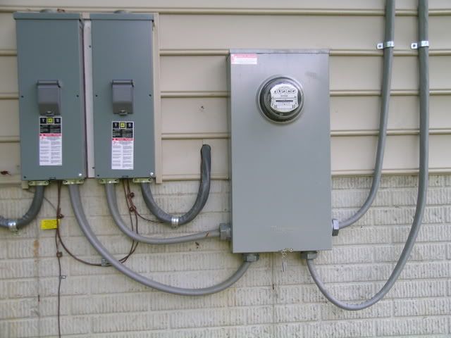

I suppose I could open to take a look inside main disconnects tomorrow. Here are some pics of what I have. outside and inside one of my circuit breaker boxes.

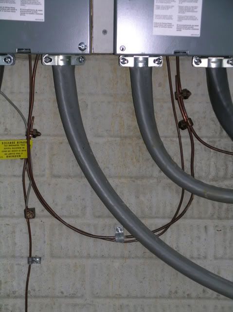

you can see the copper wire coming up from grounding rod on left. It goes into the left disconnect, but has acorn on it and a piece of wire goes into right disconnect. to the right of right disconnect, you can see the copper wire running with the SER wire. this goes to near my circuit breaker boxes but does not enter and attaches to water line. Note that it goes into right main disconnect but has acorns with wire also going to left main disconnect. So, is only one grounding rod considered adequate?

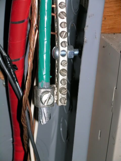

on the other shots of circuit breaker box, you can see my neutral bus bar on top. the grounding bus doesn't look like it was really part of the box and is just attached with a bolt to the box. shouldn't the box have been sanded to get good connection? use copper instead of steel bolt? This is the way it was, the electrician did not touch this at all.
I will have look inside disconnect tomorrow if possible. assuming the ground and neutral are bonded inside, I have question as to electrical path. Electricity takes the path of least resistance. so it enters panel via hot wires. goes through a circuit and comes back to panel via neutral. from panel it goes to disconnect. at disconnect, assuming neutral and ground are bonded, where does it go? could go to water main, to grounding rod, or to mast head neutral/ground? which has least resistance? am I missing something here? I guess to get better idea I would need to see how the meter area is wired as well as the disconnects. at mast head, there is only three conductors. at meter there are 2 sets of three conductor cable and from disconnects, there are 2 sets of 4 conductor cable.

I'm going to withhold comment on the "workmanship" of that installation...
I will comment on this:
That statement is false. Electricity takes ALL paths, the resistance only controls the amperage in each parallel circuit.
Yes, my friend, you are missing quite a bit here. The electricity returns to its SOURCE and that source is NOT the earth or a water pipe. Ignoring for the moment that the electricity is "alternating" 60 times a second on BOTH the "hot" and the "neutral" conductors what a circuit really is at any instant in time is a loop from the source to the load and back to the source.
Grounding a system has nothing to do with the proper operation of a circuit. Grounding is done for several safety reasons but the electricity NEVER travels in "ground" conductors except under fault conditions.
One more thing; there are no "acorns" visible in your pictures. I think that what you are referring to as "acorns" are the split bolt connectors on the grounding electrode conductors.

The ground bus bar in the main panel, definitely needs to be properly affixed to the panel housing "that's for sure". I am not an expert by any means, but I do read a lot of these posts. Everything, to me, (except for the ground bus bar) appears correct. Perhahps John Nelson and or French will be along soon.

What an ugly mess to have on the side of your house! Could have been done a lot neater. Did they even seal the entrance holes? Looks like they just punched a hole in the siding.
They could gave gone into the house through the back of the disconnect and avoided the SER loop on the outside.

I will have to comment on the workmanship of this service.Your electrician should be ashamed of himself! We are supposed to be proffesionals in this trade not only to provide a valuable service, but show a little pride in our skills. In my 19 years I have thankfully only run into a handful of knotheads that terrorize there jobs like that. Looking at that would give me cause for alarm as well. If he terrorized the service like that on the outside, I would hate to see what is behind the sheetrock. None the less, although ugly they usually end up working. This is his journeymans fault for allowing this to be okay. If they don't care about workmanship then they probably don't put much thought into what they are doing. With that said I wish I could tell you they have violated any codes in regards to your question about the isolated grounds and neutrals. When that service wire hits your disconnects from the meter, the disconnects are now considered the "main service". All grounding must be bonded together with the neutrals at this point. Any service panels after this point, whether it is your main service or not, is now considered a "sub-panel" and both the ground wires and neutral wires must be isolated from each other. Beause your disconnects are considered your main service, all grounding and bonding must be terminated at this point. This includes the ground rods, bonding the cold water side of plumbing usually at the water heater or where the water enters the building (unless your plumbing is plastic then this does not apply) and bonding the gas pipe. All of these terminations must be accessable so you may have a blank plate over where the gas is and a #4 bond wire where your pipes come out of the wall at your water heater with a bond clamp on the pipe. As far as the one ground rod, it is only legal to put one ground rod in the ground if you can prove that there is 25 ohms of resistance established and that can be only proved by using a meager. Since it is silly to go through all that trouble and expense 2 ground rods are always required. I am from Washigton state and using split bolts to ground the other disconnect is clearly a code violation. The disconnects must have seperate grounds although they come from the same ground rods. I have never worked as an electrician in any other state than mine, but I do know we all bound no matter where we live by the codes outlined in the National Electric Code book. He also needs to secure his flex within 8 inches of leaving any box or device and every 4 feet after that. I don't see any but 2 straps on the light gray flex and that is certainly not within parameters. This stuff is the electrical inspectors job and am blown away that he is allowing these clear violations to happen. It almost feels like he has never seen this job. I am embarrassed for your electrician, but want you to know that the vast majority of us have alot of pride in our work and demonstrate a high degree of proffessionalism in our trade. Anyway, hope this answers some of your questions.

I'm gonna make a few comments on the install also, here goes, is it ugly? Beauty is in the eye of the beholder.
Does it meet code? looks to be missing a few straps.
Other than that, the owner paid for what he got... its that simple, not everyone can afford a top notch install. I really dont see the fuss, I dont work like that, but then again, some people would find my prices too high to begin with to even get the job.

I am not sure what price has to do with doing the job right. This installation could have been done a lot neater at no additional cost.
Part of the code does specify neatness. Not sure exactly how it is worded but it might be hard to enforce because as you say beauty is in the eyes of the beholder and there are a lot of safety wise OK ways to do things that may not be esthetically appealing.
I am sure there are many fine electricians out there but this kind of thing happens all to often especially in mass produced housing developments.

However.,, with the grounding wires with that photo hard to see if that is #8 or #6 if that the case if the #8 or #6 go to ground rod if #8 it will not meet the code at all #6 may be ok if this was a 200 amp service but however with class 320 service { resdential 400 amp service } you need upsized the EGC conductor to #4 and for bonding if you have city water system that will need to be #2 bare copper per NEC codes
For the workmanship that is no excuse espcally with service riser techally wise yeah it meet the code but with the riser you must have equal leght on parallel conductors and IMO it is uneven the shorter cable will draw more current htan longer cable.

Now I know someone mention my name related to this mess but however with the ground bussbar that is very poor set up with single screw in the box on side of it,
Normally with that set up I will use two screws and make sure you scrape the paint off where the nuts or screw will land otherwise it will act like insluating prevent getting good conductive there.
Yes the code do allow that set up but hard to see the photo if you have nuts on both side of the panel { we call them tub } and paint is scrapped off then you are ok on that.
The code do not allowed simple sheet metal to screw in the box it have to be bolted or self tapping machine screw or machine screw or other as i mention above.

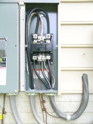

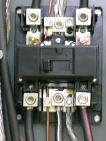

I took some photos of my disconnect as I said I would
so the neutral and ground are bonded in disconnect making my main panels actually subpanels.
I measured the grounding wires. from rod to disconnect it was about 4.1mm (I think #6?) and from disconnect to water main it was 5.1mm (#4?). so the #4 should be #2? The inspector definitely saw that as he was here when they had the SER cables and ground system roughed in. From what I read, I could get away with one ground rod, with the plumbing being counted as the second, if 1. ground attached to plumbing within 5ft of entrance into house 2. water main buried for at least 10ft. I still may add at least one more grounding rod and from what I can gather, the wire should be continuous from rods to disconnect meaning I would have to replace the wire that is already there. Should I call inspector to have him look it over and if not up to code then call the electrician or the general contractor who hired him?
yes, there are actually three nuts on the bolts holding ground bus. one that you can see in photo right on side of bus, one on inside of box and one on outside of box.
