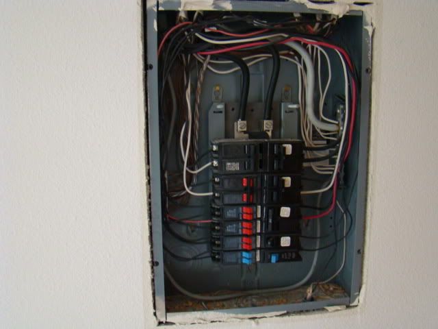

Here are a few pictures to get started.
T-stat boxes following shortly....
Breaker box located in Bedroom #2
Bedroom circuit is left bank, 3rd and 4th breaker from the top

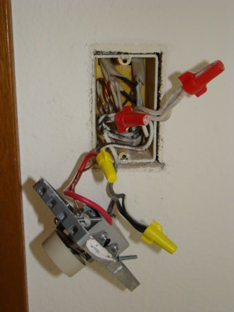

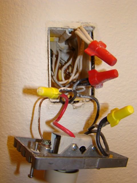

Here are the t-stat boxes. I don't have pics of the wall heater wiring but all have a single cable going to each.
I have print out replies for additonal testing, willis.
Hang with me gunguy45... I really want to solve this before the electrician comes back on Tuesday.
Bedroom #2 - The only one working

Looks like your house wiring in the boxes is just black and white, and the mention of red adds confusion. The black and red stat wires are short wires (common in every photo), probably stranded wire that probably came attached to the stats and have no bearing on the color. The only colors that matter are what are at the wire nuts 6 inches beyond the stat's stranded black and red wires.
DO those breakers you show on the left have bars that connect them to make them 2-pole? Therefore as previously mentioned by others, ARE these 240 or 120? A voltmeter test at these breakers, with probes of a voltmeter put on each next-to-each other breaker that look 'tandem" would confirm if 120 or 240.
BTW, I've worked on plenty electric heater components and associated wiring and found shorts, bad elements, bad internal stats, and hooked up brand new heaters and stats with single and double pole thermostats and units that have positive off and others that will never shut completely off, but can still come on automatically if temp gets below 45 degrees. So I really understand such systems, in case you have doubts. Along with all kinds of experience wire trouble shooting. Never been snafued.

Thanks for the pics. Don't mean to be a pest, but could you spread out those wire groups in your tstats so we can see all the cables in the box and where their wires go?

DO those breakers you show on the left have bars that connect them to make them 2-pole? .
Yes, the two breaker are connected.
I thought you might ask for that. Once I got home and looked better at the pictures, it wasn't very clear. It will be dark in a couple of hours so I will head back tomorrow for better pictures. I printed out your email and will assemble answers for all.

Please take another picture of this box with higher resolution and a flash, and/or confirm this question.
For accuracy, the breaker spots in a panel are labelled like this:
1---2
3---4
5---6
7---8
etc
Your spot #1 & spot#3 is a double pole breaker for 240V.
Your spot #5 & spot#7 appears to be two single-pole breakers with a handle-tie applied. I say this because usually any single breaker assembly will usually have only one set of data/info printed on it (or have one sticker). For spot #5 and #7 I see two sets of info. If it is 2 single pole breakers, they will supply 240V.
Your spots #9 and 11 are examples of a tandem breaker as described before (just for info).
What I'm wondering is not very clear on your picture. My first question is this:
1) Do the black wire on spot# 5 and the white on spot# 7 come from the same cable? They should be (must be!). It appears from the picture that it is possible the black on spot #5 goes with the white on spot#3 (if so, - wrong). Same goes for the black on spot#1 and the white on spot#3 - must be part of the same cable. (Enlarging your pic and following the wires it appears possible they are mixed up)

Your spot #1 & spot#2 is a double pole breaker for 240V.
I will check.
Originally Posted by williswires View Post
Your spot #3 & spot#4 is appears to be two single-pole breakers with a handle-tie applied. I say this because usually any single breaker assembly will usually have only one set of data/info printed on it (or have one sticker). For spot #3 and #4 I see two sets. If it is 2 single pole breakers, they will supply 240V..
That is correct. #3 and #4 are two single pole breakers. They each hold the black and white wire for the bedroom heating circuit (single cable).
1) Do the black wire on spot# 3 and the white on spot# 4 come from the same cable?
Yes.

Even though the 2 single pole breakers can technically supply 240V when used together, if they are supplying a 240V load then they should be changed to a 2-pole breaker. The reason is that the 2-pole breaker will provide a common trip as required by the NEC for a 240V load. This means that if one phase of the 240V trips, then both phases of the circuit will open from the internal design of the breaker.
Using two single-pole breakers with a handle tie does not ensure that both poles will trip. In fact, it is more likely that the other pole will NOT trip when the first one does. Breakers are really not designed to provide the force necessary to trip another breaker who is connected by a handle tie.
Connecting breakers by a handle tie should only be for multi-wire branch circuits (MWBC). MWBCs are special in that they are two separate 120V circuits that share the same neutral wire. They can, because they are on separate phases (forget the rest of the explanation). Using a handle tie to tie the two breakers together makes sure that when you turn off the power to one of the circuits on the MWBC, you end up turning off BOTH circuits that use the single white neutral wire so there is no power still flowing around in the neutral that you will probably be disconnecting.
With that in mind, if you truly have a 240V heater circuit on spot# 5 and 7, then it should be changed to a 2-pole breaker. If your heaters are 120V, then that complicates things even more, but I think I remember that you said they are 240 when you gave the heater sizes. Isn't that what the nameplates said?
willis

Breaker panel
Breaker panel
Breaker panel

Bedroom #2 tstat
Bedroom #2 tstat
Bedroom #2 heater

Main bath tstat
Main bath tstat
Main bath heater

since your bedroom breakers are marked "common trip" by the mfg, this is OK - you do not have to replace with a different 2-pole
willis
1) Which black wire from which cable is pigtailed and is tied where? etc. (This is why I asked for pictures).
Main Bath, bedroom #2, master bedroomcable #1 - BLACK pigtailed to cable #2 BLACK and BLACK (lower) wire on tstat. All three white twisted together.
cable #2 - BLACK pigtailed to cable #1 BLACK and BLACK (lower) wire on tstat. All three white twisted together.
cable #3 - BLACK pigtailed to red (upper) wire on tstat. All three white twisted together.
Master bathcable #1 - BLACK connected to BLACK (lower) wire on tstat. Both white twisted together.
cable #2 - BLACK connected to Red (lower) wire on tstat. Both white twisted together.
