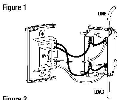

I ran 12-2 cable from a 20 amp double pole breaker (2-110's) to a dig. programmable T-stat and cable to the heater. I have power into the T-stat, but no display image or power coming out of it. the T-stat is an Aube th115, 240d. it's new.
Is the T-stat toast? how can I test it to determine this?

Looking at the instructions for your tstat, there's really nothing that can go wrong unless:
- you have a defective tstat
- you have the incoming power connected to the LOAD wires (should be connected to the LINE wires)
- your tstat is not making good connection to the baseplate when you snapped it on

from your instructions

I made sure the line and load wires are correct. I'll put a voltmeter on the line wires and see what I'm getting at the end. the breaker is new QOT two switch, double pole, 20amp. my thought is the T-stat is bad, but I'll follow up later.

That is your problem. The Q0T is not a double-pole breaker, it is a tandem breaker which cannot be used for a 240V circuit. You need to get a double-pole breaker, which is twice the width of a single-pole breaker. Part #Q0220
You can confirm the problem with voltage readings. Measurements will read 120V line-to-ground and 0V line-to-line. A double-pole breaker will measure 240V line-to-line.
