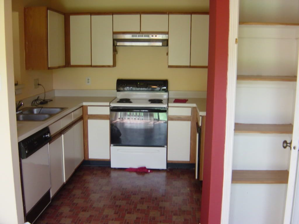

I am trying to install an over the range microwave where our range hood used to be. There is only a large white wire with 3 wires inside. I believe they are black white and copper. I need to know how to make a plug for a new microwave using that wire.

Oops...I took down a vent hood that had a light and a fan on it, I did not take the range out. I took down the silver thing under 2 small cabinets on the top. The microwave is going inbetween the range and the 2 small cabinets.
The range and the vent hood are not on the same breaker.

So in your first post you meant to say "range hood"?
Code may regulate if the microwave can use the same circuit that the hood was on. Normally you want that microwave on a separate circuit. Know what else is on the circuit.
If permitted code-wise, the common method is to locate the receptacle up in the cabinet above, drill a hole in the bottom of the cabinet, and route the cord up to the recep.
That means you would cut a hole in the back of that cabinet, fish the wire up, if you have enough slack, and add a remodeler box and recep.

That is exactly what I want to do. Run the existing wire into the top of the cabinet and mount it in there.
Yes in my posts I have meant range hood, not the range itself.

for the range hood wiring you should not have any issue with that as long it have it own circuit.
But a catch here once you installed a microwave oven / hood assambly unit the this situation will change a bit.
Most case the manufacter instruction will useally called for delcated circuit due the power useage can get pretty high { anywhere from 900 to 1500 watts }
In old code it used to be allowed the range hood to be hook up either lighting circuit or SABC { Small Applaince Branch Circuit }
Now the current NEC code will say it own circuit { I am not too sure about Canada codes but should be pretty simuair to this }
Typically the wire size is useally 12-2 W/G romex cable.
