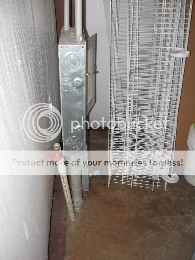

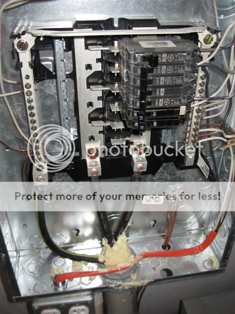

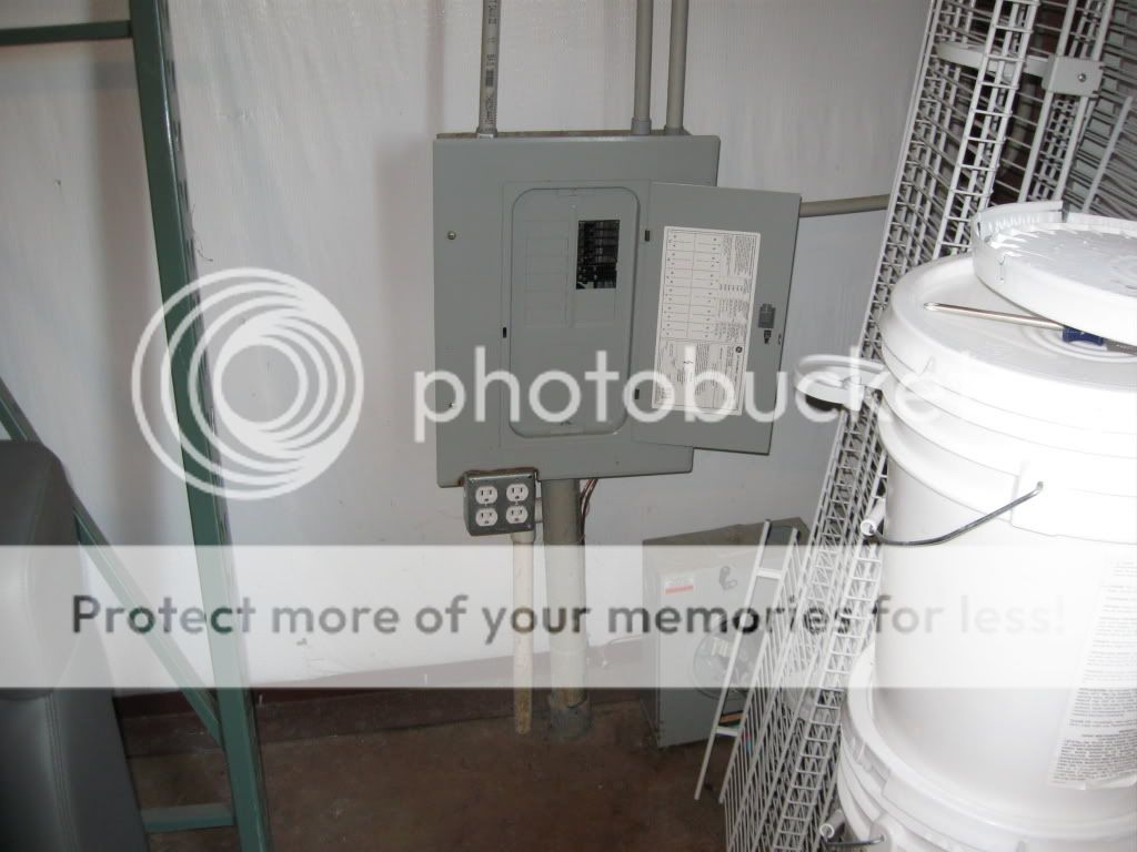

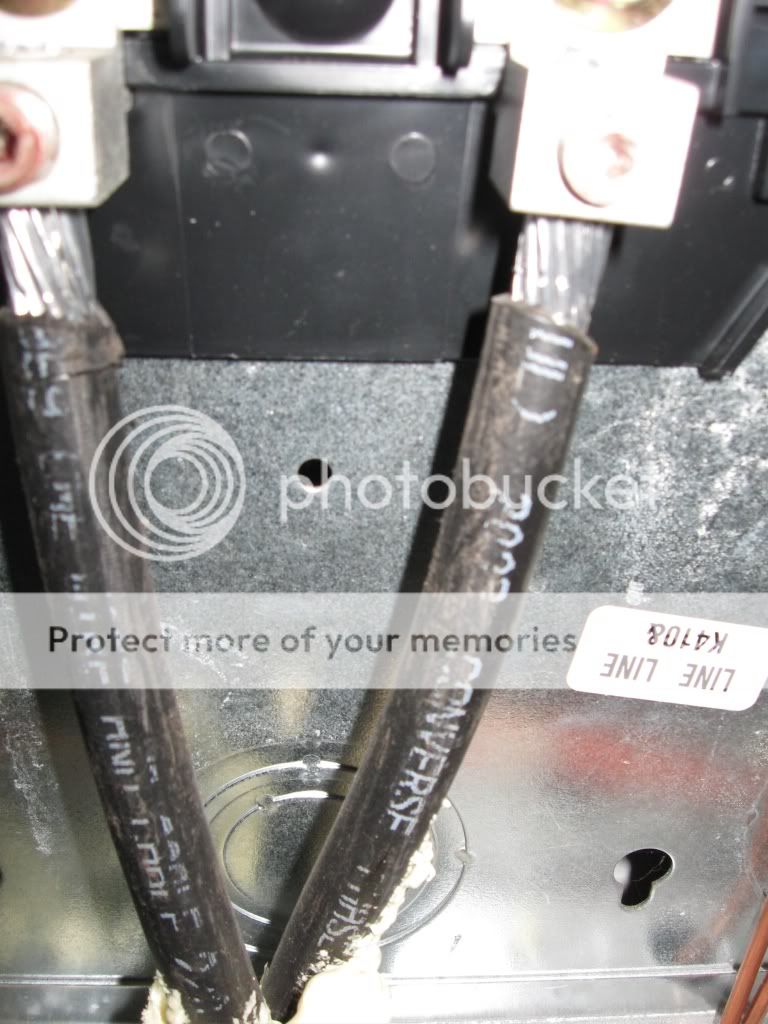

here are links to the pics. never seen lead cables this large, aluminum. house was built in 2005.
front view -
side view, with water pipe -
inside view -
lead wire closeup -

OMG.,, I just can't really comment how someone done that but there are quite few code related issue that NEEDED to be taken care of it.
Was this person did the installation is a electrician or someone else ??
Second part that the subpanel It will need a main breaker anyway due you will be over 6 throw rule allready
I am suprised how come this breaker box is not propely suppprted at all.
The other thing that the recpetale below the breaker box it must be GFCI no question asked on that part.
You will need 6X6X4 inch juction box below the main conduit so you can splice the conductors to raise it up higher for other conduits you will have do something with it either get Jbox set up so you can make a splice or shorten up the runs depending on which way it goes.
I will add more details little more later but as other members can chime in and give you some guidelines as well.

They also notched a spot on the panel for that receptical.
You might be able to use that panel if you get a backfeed main breaker with tie-down, and rectify that notch, perhaps by getting a new deadfront.

"6x6x4 junction, got it."
You'll need a bigger junction box. NEC says the size of the box is 8 x the largest conduit entering the junction box for a straight pull. If that's a 3" conduit, you'll need a 24" box. I wouldn't go that route.
Leave the panel where it is and maybe use this to support it:
http://www.flexstrut.com/strutfittings.htm
Look at the channel bracket.
This is the channel (double back) that would go horozontially across the back of the panel and fastened to the channel that extends out from the wall:
http://www.flexstrut.com/channel.htm
You also need to support those conduits entering the panel from the top.
It may be difficult to buy those parts where you live, though.
You have other issues with the current installation:
You need to install a main breaker with a retaining kit. This breaker would mount just like the exisiting ones. The retaining kit prevents the main breaker from being pulled out.
The white wires landing on the the circuit breakers need to be re-indentified with black tape. So does the feeder neutral.
Where do those two bare copper wires go to that are connected directly by the terminal lugs to the panel?

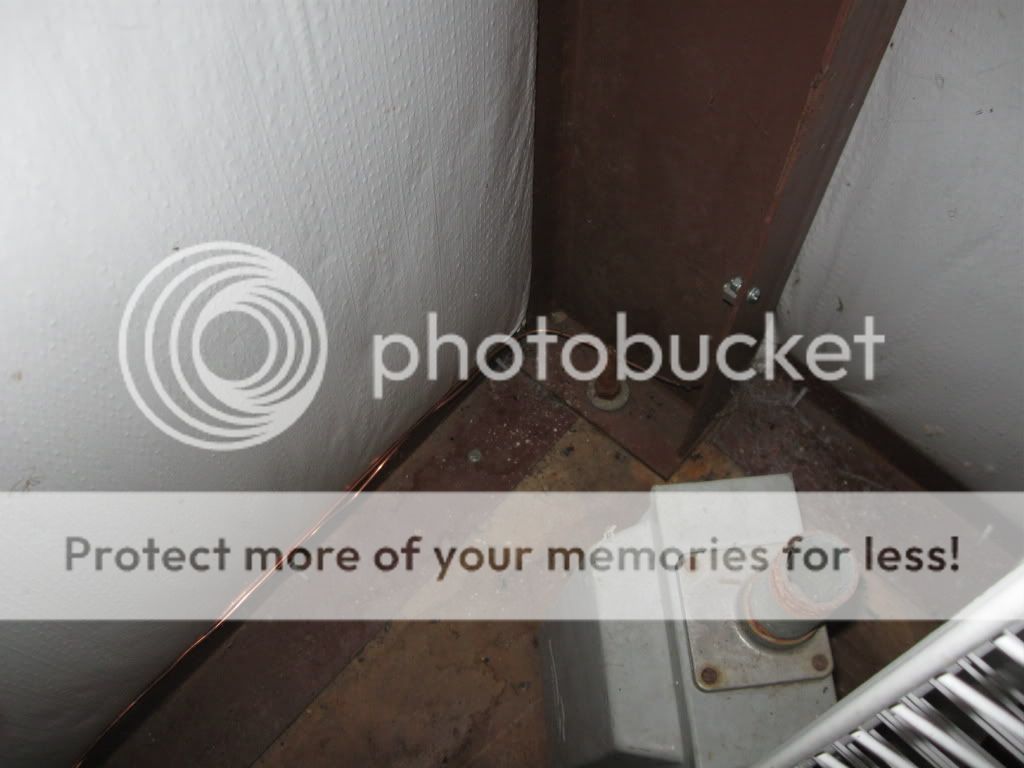

the two bare wires clamped to the back of the panel go to the building frame

There are a couple methods. The tried-and-true is to use a split-bolt connector and lots of no-ox grease which mechanically joins the wire then you wrap the heck out of it with heavy-duty electrical tape.
There are also insulated splice connectors made by a company called Polaris which do a very good job and are very easy to use correctly, but they can be a little pricey and might require a special order at the supply house.
Finally there are kinds of crimp connectors which do require a special tool to apply but your local supply house may be willing to lend or rent you the tool when you buy the supplies there.
in this case, the main wires then go to the breaker instead of the built in anchors, and the power is then fed thru the breaker, right? Do they make then to take wire this size?
Yes. You could back-feed a 100A breaker which should accommodate the #2/0 wire.
My recommendation would be to remove the "guts" of the current panel and buy or fabricate a blank steel cover. This converts your current panel to a big junction box in which you may splice to new wires and continue conduit to a better panel location*. You could also use this box to splice the other circuits and continue their conduits to the new locations if it is too difficult to relocate the existing circuits. Purchasing a new main-breaker panel is not that expensive they are usually sold in kits and the big box stores have one on-sale almost every week.
* a good panel location is one that has no obstructions with 30" clearance side-to-side and 36" clearance out from the panel. A rule of thumb is that you should be able to slide a refrigerator box up to the face of the panel without hitting anything else. It can be in a closet, but that closet can be used only for electrical equipment (no storage). The panel can be behind a door swing so long as the door can be positioned to meet the stated clearances. The panel should be supported by steel strut (shown above), stud wall or other similar structural material.

I don't know why they routed two separate grounding electrode wires to the building steel. I would remove one of them. Make sure the remaining one is #6 AWG copper. Connect it to the neutral ground bar in the new panel.
You need to install 2 ground rods, if they aren't installed already. The grounding electrode conductor from the panel to the ground rods would be a # 6 AWG copper.
Drive the first ground rod outside directly behind the new panel. Drive the second rod at least 6 feet away from the first one. Drive the ground rods a few inches below grade Use ground rod clamps that are rated for direct burial. Route the #6 AWG copper from the neutral bar panel in the panel to the first and then second ground rods. Be sure to keep the #6 AWG copper conductor protected from physical damage. If you don't, you'll have to use a PVC conduit to protect it.

I think one of these two wires actually goes to a ground rod outside. I will have to check that again when I am at the property.

To Thinman .,, you can not remove the bonding wire to the building steel structure this is very important part here.

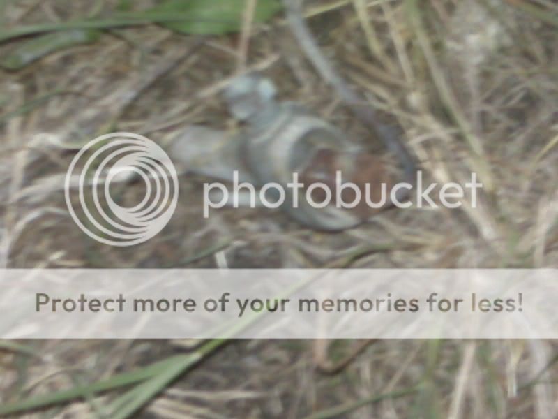

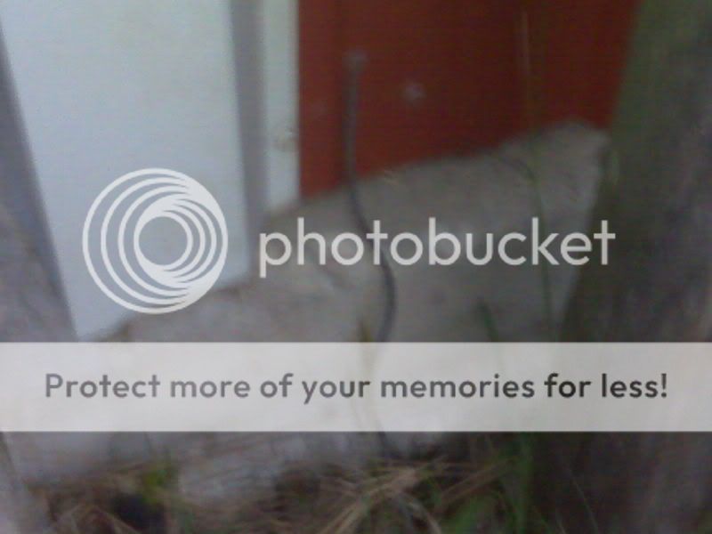

Also, will post pic later, the other copper wire goes thru the building wall to a ground rod.
(the pics are not great, cellphone)
