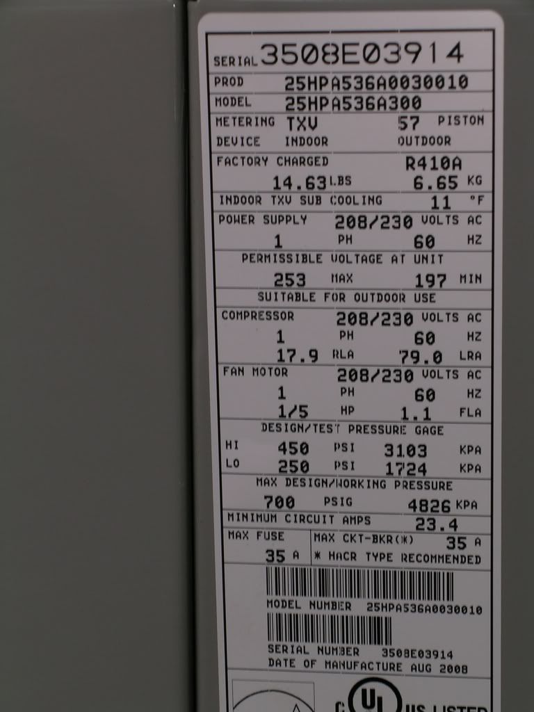

for outdoor condenser unit, there is 10/2 UF-B wire on 30 amp circuit. unit rated at 23.4A per sticker. The wire runs along foundation into disconnect and then to unit. No conduit is used either in run to disconnect or from disconnect to unit. The wire never goes below ground. I thought you had to use conduit when running wire along foundation? I thought everything else OK except the conduit question.
condenser label

Now for outdoor unit the 30 amp breaker may hold ok for while but really it should be used with 35 amp breaker per nameplate info.

wasn't sure about condenser. It said max fuse. so I thought that meant that you could use 30 since since it is not over 35 and 23.4/30 is 78%, so I thought that was OK. why don't they list min fuse or tell you exactly what to use? If use 35amp, you can still use 10-2? I thought 30amp was max for 10 gauge?
The A/C and motor load have diffrent rules than standard circuit set up and they are very spefic in Art 430 and Art 440 .
As long the listing say both fuse and breaker you are fine with that part many A/C will list the min load amprange and max fuse so it mean we can wired by the min amprange and max fuse or breaker per listing.
The maximum fuse or inverse time breaker is 35 amps. The mimimum circuit amps is 23.4. this is obtained by taking 125% of the rla off the nameplate for the condensor compressor (17.9 amps) then adding that to the fla of the fan motor 1.1 which will give you the minimum circuit amps of 23.4.
Overcurrent and short circuit protection must be capable of handling the compressor starting current and is allowed to be a maximum of 175% the compressor rla of 17.9 amps. 1.75 x 17.9 = 31.3 amps next size up breaker (NEC 240.6) is 35 amps as stated as the maximum breaker on the nameplate.
Compressor motor branch circuit conductors do not have to follow the overcurrent for small conductors in subsection 240.4(D) but follow 240.4(G). This sends you to Article 440 parts III and IV. So for your condensor you can use #12 awg copper (ampacity 25 amps) as a minimum conductor on a maximum breaker or fuse of 35 amps. You can use a 30 if you want and see if it holds when the compressor starts. You can also use 10 awg copper if you want, you just have to have a conductor that will carry the load on the nameplate and not use a breaker less than the load required and don't go over 35 amps.
