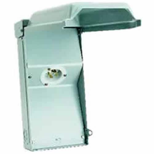

Unforetally.,, Those guys are correct and this is pretty serious matter that need to be address here.
Need a approved type of transfer switch or Interlock device { some inspectors will not approve this one }
What wire size between the inlet and the breaker box ??
The reason why I ask due somewhere along the way it is not done right.
This is a approved inlet box { there is other style will look simuiar to this }
For the transfer switch there are quite few diffrent verison to deal with it.
