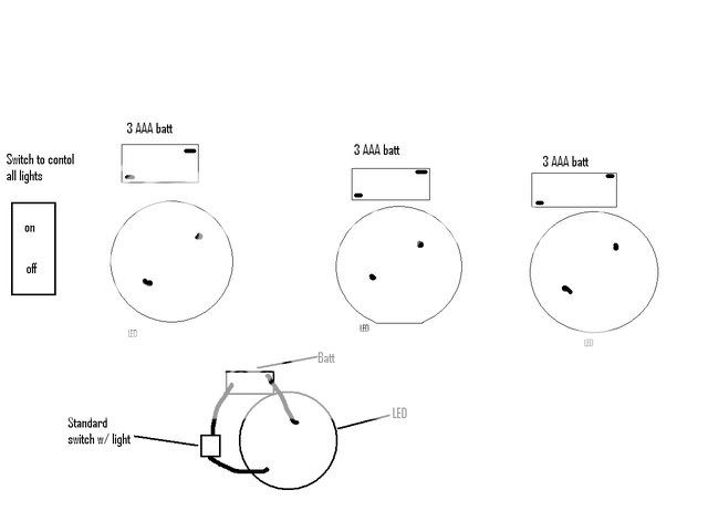

If possible could someone tell me how to wire these lights to one switch and possibly run off a 6V or 12 V battery? Using magnetic LED's in a goose pit and need to find out how to wire these to run off one switch. The diagram linked together is how the original is wired. Thanks for any help.

I don't see current limiting resistors in the circuit ... but here's how you'd switch all three:

You are showing a "standard switch with light" in your diagram, yet battery power?? What are you trying to light? Three single LED's won't provide much room light, and batteries won't power a LED light bulb.

[QUOTE=badeyeben;
Yes, kinda. Our goose pit is a steel holding tank underground. The magnetic LED lights have 25 led on them, and look like a hockey put with a magnet on the back and a push button switch. When you take tehm apart you find 3 AAA batteries powering them. I am looking to place these lights on top of our cylindrical steel tank to act as lights (they are quite bright) When y ou enter the pit you walk down a ladder, it is here i want the switch, just like entering a dark room i want one switch to turn on all. Also, i wanted to know if i could some how run an alternate power source to eliminate the AAA batteries so they might run longer. Thanks all for wonderful help thus far!

Originally Posted by badeyeben View Post
I know there are battery power LED lights. I am not sure if the suggestion on wiring them would triple the voltage to them or if the lights can take more than the 3 AAA batteries.
Multiple batteries wired in parallel provide the same voltage as one battery. If the LEDs can handle one battery, they can handle multiples, because they have a current-limiting resistor in series that limits the power. If the resistor was missing, the LED would be very bright for a second before it went dark forever.
That said ... The easiest way to tie all of those lights together is to remove their individual switches and string a pair of wires in their place from one to the next. Connect those two wires to a single switch and they will all turn on at the same time. Make sure you pay attention to polarity.

That being said (that the resistor limits the current) without knowing where this resistor is, the way to use a single 6volt or 12volt battery, would be to attach wires to the terminals that the batteries are going to now?
Since probably the resistor is built into the battery pack? Attaching wires to the positive and negative of each light and running them to the negative and positive of the battery? Then if you left the switch on the light itself turned on you would just have to break the wire to the positive of the bigger battery to put in the switch?
