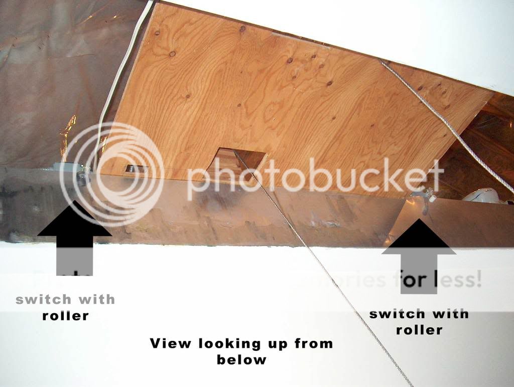

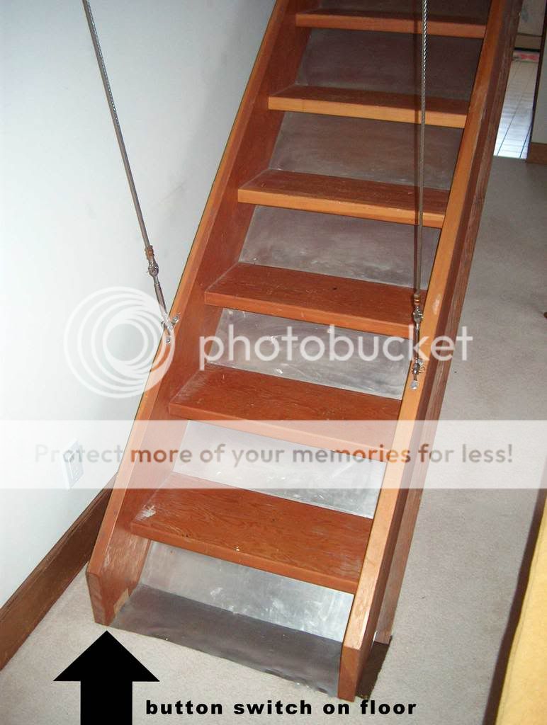

I have a wooden staircase to the attic that raises and lowers from the ceiling. There are two cables at the bottom of the stairs and they wind and unwind by way of a winch. The system is controlled by an electrical panel with about 5 relays and lots of wires.
The end of the staircase makes contact with a switch on the floor when it is lowered completely (open). There are two switches on the side of the opening that the staircase contacts when its in the uppermost position (closed)
The house is 20 yrs. old and I'm guessing that it was installed at the time it was built.
I can posts pictures if it will help.
Does anyone have any advice to help me get it working again?

Yes, pictures would be great!!! Or the wiring diagram if one's available.
It's probably just one of the limit switches.

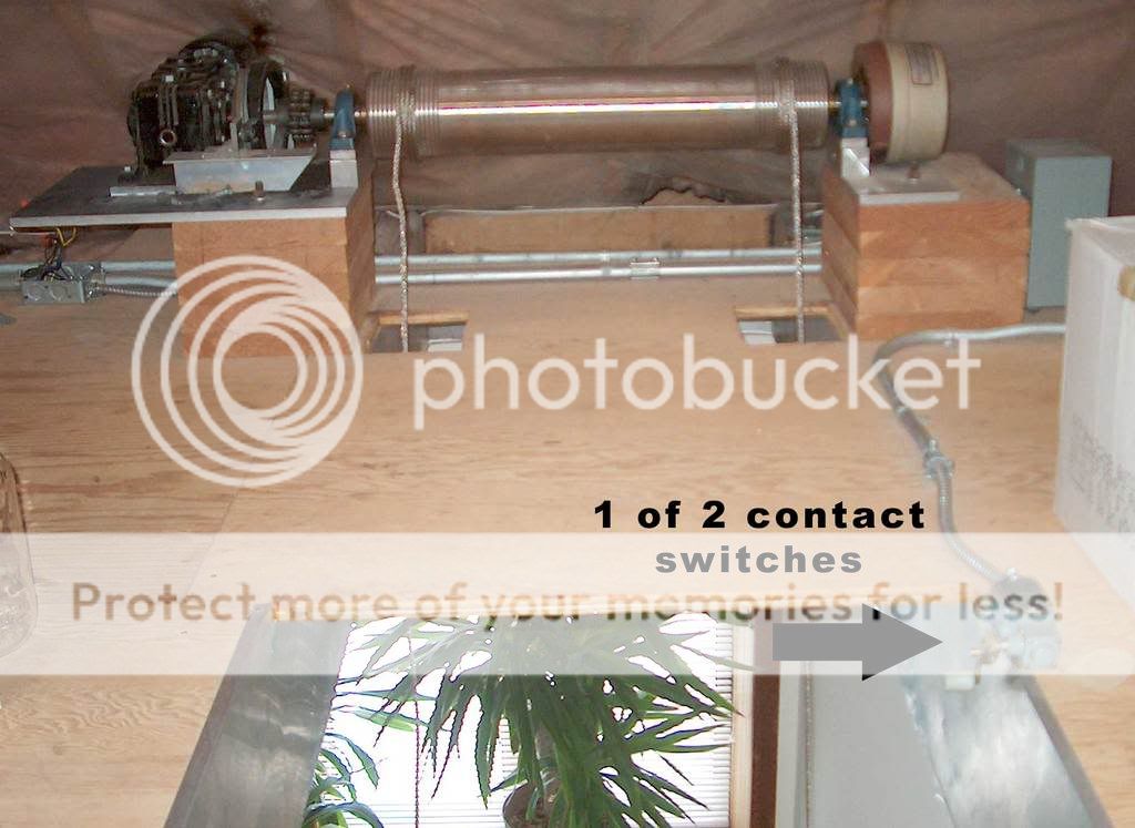

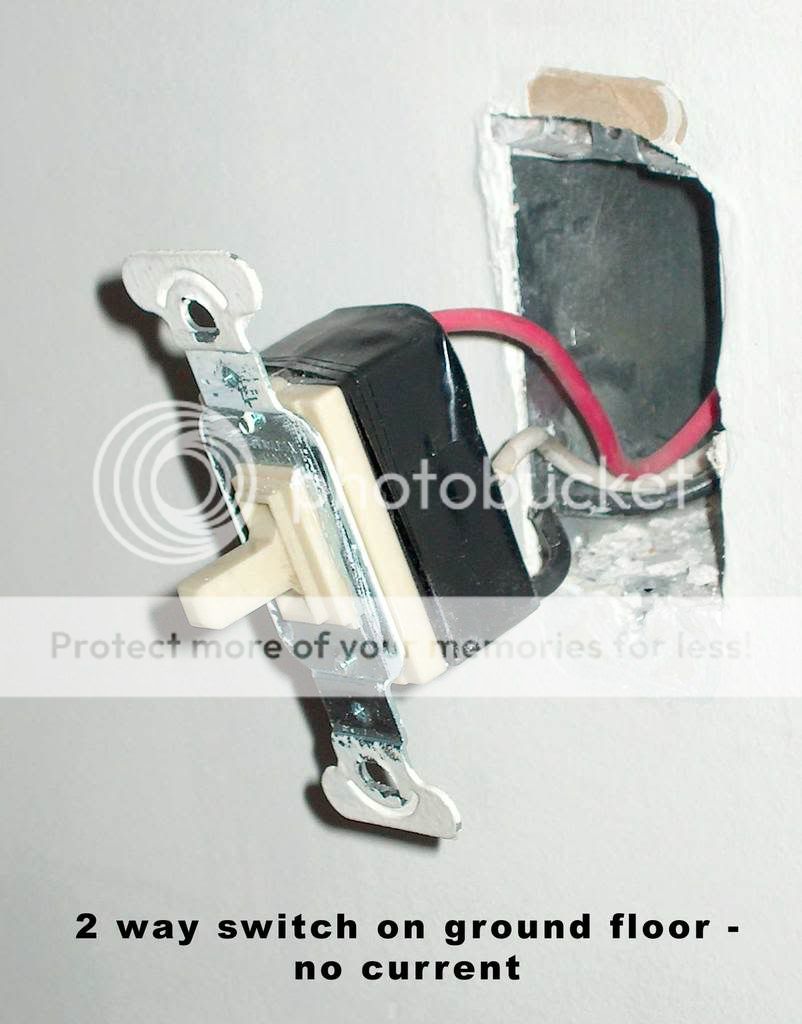

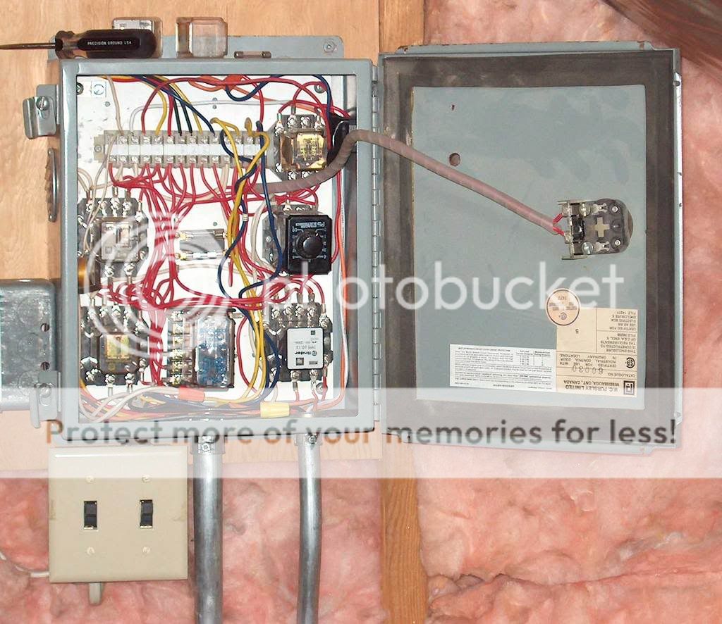

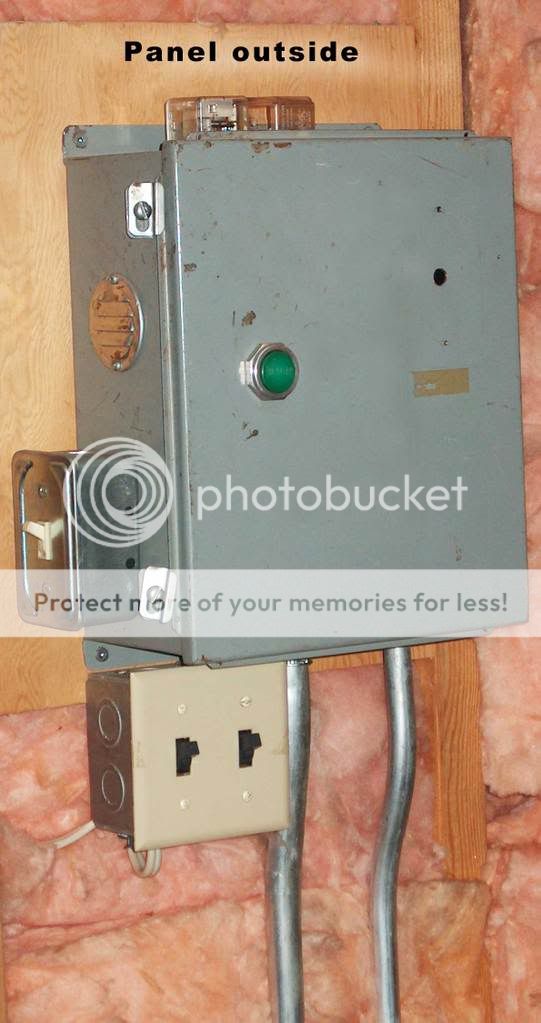

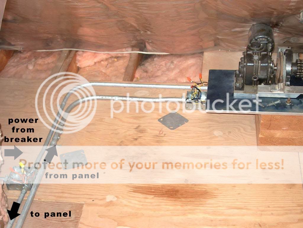

Sorry, the staircase was working perfectly until it didn't respond yesterday when I tried to raise it.
I tested the 2 way wall switch and there's no current, but there is 120VAC getting to the panel. I don't have any diagrams.
Here are some photos. Thanks for responses so far.

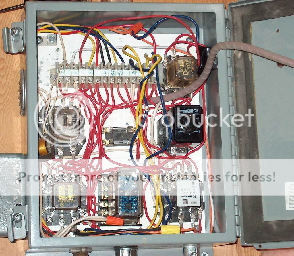

WOW..who lived there last? An electrical engineer or someone with lots of money to pay someone? Just looking at that, I can't imagine that is any sort of normal residential system. Looks more like an industrial product adapted for home use.
Again...WOW.

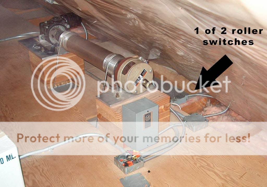

Is this something you open and close often? If not I'd almost suggest replacing the winch and all that wiring with a couple of counter weights..
What voltage is the winch motor? AC or DC? If it is 120v AC I'd try running 120v straight to the motor to test it but it is a reversing motor so you would need to figure out where to connect.

Can you check those fuses, the one on top looks burnt. It may be just the way the light is hitting it. The fuses look like one protects line voltage and the other protects low voltage.
Yes, we go up to attic quite often.
The motor is 120VAC. If there's a problem with the motor, wouldn't there still be current running to the switch?
I've checked both fuses and they are OK.
I see that it says 24V on the terminal strip, but I can't find that voltage anywhere when I poke around with the multi tester.

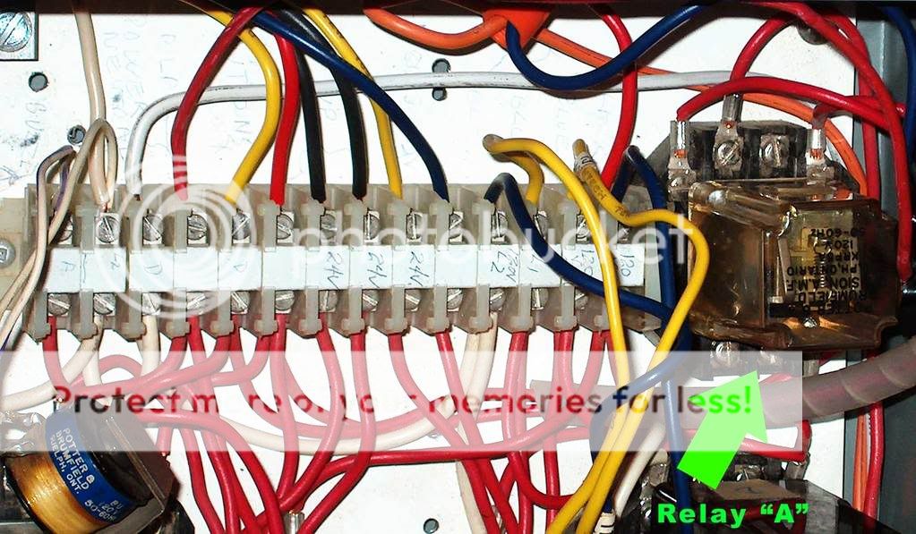

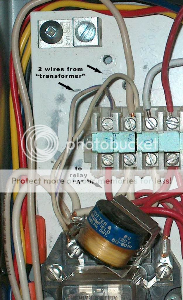

There's a little component hanging down loose (see close up pic of panel - far left side around the middle) with 2 white wires connected to the 1st and 2nd connecting screws on the strip. Could that be a 24V transformer? When I check for AC voltage on the two leads, there's nothing.

Follow those 2 wires feeding the "transformer" and trace back to see where they go. If it's just the 2 going to that terminal strip then it's not a transformer. It looks like it's wirenutted at the bottom, then go through the nipple to one of those switches. Switches good? not back stabbed?

The more I look at the device hanging, it looks like more of a buzzer. It just looks like a coil hanging there

Probably but with a system this complex you can't be sure. There are multiple ways to troubleshoot. Me I like to work backwards.
My method for this once I've eliminated the obvious like external breaker and internal fuses.
Does the motor work? (Done by directly applying power.)
If yes: Trace motor leads back to where they are connected. If a relay is there power to the line in side of the relay?
When activation button is pressed does the relay close?
If no apply power directly from the secondary side of the auxiliary transformer (probably 24 volts) to the coil. Does it work?
If not do you get voltage (!20V) at the aux, transformer primary? If so do you get voltage (probably 24V) at the secondary.
That should get you started but as I said that is just my way. Others might have a better way.

As you can see from these close-ups, the wires go to a terminal labelled "A" and one labelled "L2" which is 120VAC. I also took a picture of relay "A".
The green switch on panel door and the right side are good. What do you mean by "back stabbed"?

Yes, it's a buzzer I see the writing on the back plate. By back stabbed I mean the wires are just stuck in holes on the back of the switch instead of being secured with the screws. Backstabbed connections become loose after a while.
On the right side of the terminal where it says 120V, do you have 120 there? Also, we need to find the transformer and/or power supply for the low voltage.
I'm referring to the switches under and on the side of the control panel.

Might try giggling that upper contact switch. This switch would stop the motor from working as the ladder would have reached its upper limit. If the switch was stuck activated, then the motor would not work.
I assume that an associated relay should click when each switch is activated. If you wiggle switches and don't hear any relays clicking, then check for a relay power source problem.

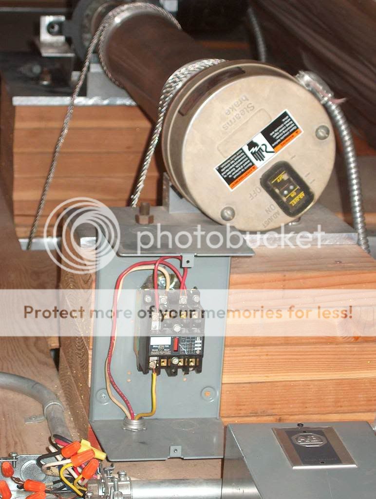

What is in that "AB" box below the motor drive which does not have its cover removed?

What is in the Allen Bradley box up by the winding motor?
It's a large Allen Bradley relay called "Bulletin 700 Type N"

The activation switch is basically dead. There's no voltage when I check the three wires with the multitester.

Then if there is no 24V necessary, assume that the panel is not marked correctly.
I would start troubleshooting be following the power in from the source and using a multi-meter set to AC.
And I would trace wires and begin to identify what each relay is for / goes to.
And I would test each relay to be sure it and its associated device (switch/motor) was working properly.
There should be some clicking of relays when various switches are activated. If no relays are clicking at all, then the problem is probably early in the power supply.
If you want us to help troubleshoot this, identify where 120V power enters the relay panel and mark arrows on the terminals (on picture with photo editing) where these two connections are. Indicate if you measure 120V at these points with your multi-meter.
