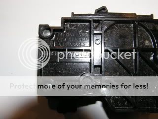

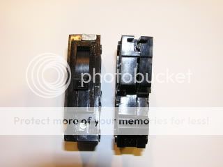

Got back and checked the truck. Lo and behold they are General Switch breakers. I got two 20 amp. Here's some pictures:
If you want bigger picts go here: General Switch breakers pictures by TolynIronhand - Photobucket
The connecting parts look similar to Siemens, Square D Homeline, GE, or Cutler hammer BR's. Ray's post pretty much confirms that the BR's is a direct replacement. However if you are interested in these send me a PM.
