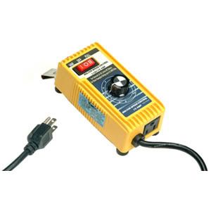

Here is a picture of the controller for brush type motors. I was hoping to find something similar for induction motors. You just plug it in. But, I do recall my exhaust fan controller has a heat sink on the outside, so that might be a problem.

Well I decided to try a ceiling fan controller to see what would happen. It is a Leviton "Trimatron", Model # 6616, rated at 5 amps. It works extremely well on one of my grinders, not as well on another, and not at all on two more. The one it worked well on , the motor did not get hot, made no strange noises and the controller did not heat up either. So, I 'think' I am good to go.
