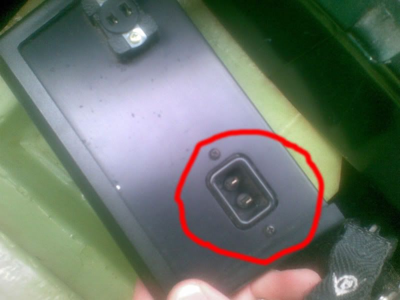

I have an appliance that uses this plug socket:
I believe it is a Type A US socket is it possible to get some sort of lead so that I can use it in the UK?
Thanks for any help.

It is a photographic enlarger for making prints and I assume this is the transformer box.
As the light plugs into the socket not circled but I need to find a lead that plugs into the circled socket and into a normal plug socket on a wall (UK) It looks very similar to one you find on a Kettle but this has two pins not three.
If that makes sense?

I am not sure if it was made for the UK or not but I am basically looking for something like this
But it needs to have two pin holes not three, this is called a IEC (Kettle Plug) Mains lead (3 pin) I am not sure what a two pin is called and if you can even get them?

Spent far to much time on the internet and found this:
Leads Direct - IEC Connector Types
It looks like I am looking for a C9 or C10 IEC Connector

That is IEC C-9 however you may want to double check the spaceing between the two pins some have diffrent verison if you know the manufacter you can able concat them they may know something or two about that and also with the female end side that look pretty much simair to the 1-15 plug set up.
But if you have tape mesureing device I should able tell what size it is BTW for 1-15 slot spacing it is 13mm centre to centre if that line up then it is legit item but if not you may have to do little more digging up IIRC there is midgit verison as well.
