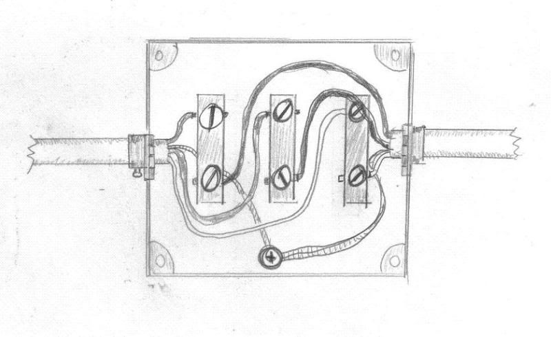

So I had this great idea for a junction box that uses buss bars with screw connections, like a service panel or subpanel, except without the breakers. Or does something like this already exsist?

The picture is of Polaris brand connectors. Most of these types of connectors are not stocked at hardware and big box stores, but if you go to an electrical supply house they should have several different types of connectors you can choose from. There are devices similar to your drawing usually sold as motor connection blocks. You can also use insulated crimps which are basically a copper barrel with a plastic or rubber sleeve that slides over instead of tape.

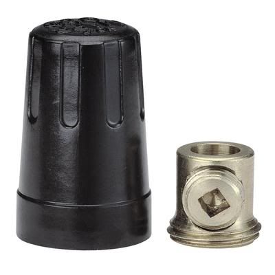

I have used these in the past and feel 'comfortable' doing so. Wires are secured by a setscrew, then the plastic cap is threaded on. They can handle 10 gauge wire. Any reasons not to use these?

That wire nut you mention that I use that once a while but not very often normally I used wirenut or " choc block " aka 3M connectors depending on which area I am in { the French use the latter while the USA / Cananda use the wirenut/marrte those are good until you get up to #6{ 16mm˛} but once get larger or large number of connections then I used Polaris block connector or choc connector.
