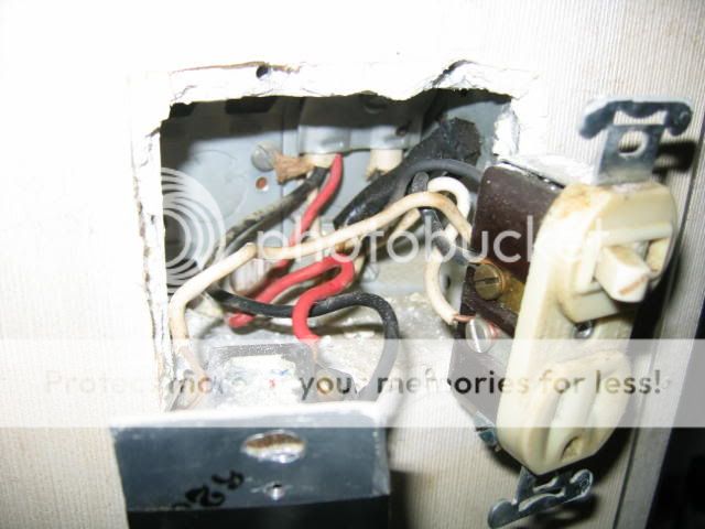

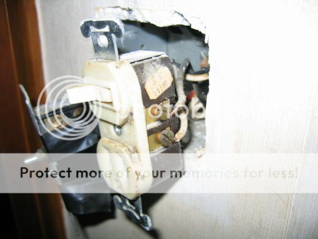

I bought a bathroom fan timer for my thru the wall fan. Currently the setup is the dimmer switch on the left operates a fluorescent light above the sink (no idea who would do that lol ) and the regular switch operates the fan then of course there's the outlet. I know zip about wiring so wanted to ask how this all gets put back together to make the existing switch operate the fluorescent light and make the new fan timer operate the fan. Unsure how to tell which wires are for the fan..just trial and error?
i do know enough to know i may be in trouble since there apparently is no green ground to the existing outlet.

Regarding the ground......the lack thereof: They should not have been allowed to have that grounded plug in there.
You better run new wire with ground, or get a gfci in there, or a gfci breaker on that circuit in your panel box.
The way it currently is......what is bad is you have a metal box......not plastic.....and any bare wire hitting that metal box inside would transfer into the swithes and outlet metal. And if someone was touching the sink, stove or fridge at the same time as touching any metal, including screw heads on the cover, at the same time.......zhzhzhzhzhzhzht.

Ditch that old school flourscent dimmer that not even worth anything at all and go to the flourscent luminaire and look at the conneciton and let us know how it conferated and is ballast is there ? { Some old flourscent dimmer do have build in ballast in there sorta like choke or reactor ballast }
Now with that second switch above the receptale I know you mention fan
This what you do senice you allready have netural there that will really help a bit with this electronic timer so
If I remember the hook up the black is power source and white is netural then red is for timed switched conductor.
Green is ground so you will have to bond the box with it.
You will have to get new combation switch / GFCI recepatle and many big box store will stock this item.
the combation switch you will have to do little reconferating so the above sink luminare will be at new combation switch while the receptale is the same.
So before you take anything apart mark every thing down with notepad and take a colour tape or number sticker and mark them on as well so you will know which way it will goes.
Before you ditch the flourscent dimmer let me remind you double check the flourscent luminaire to be on safe side if can able work without dimmer { most flourscent need specal dimmer / ballast combation to get it function properly} maybe change to diffrent luminaire that will make the diffrence as well.

when you say box do you mean cut into the wall more than already is? I know it's not a great pic to see it from but it's a bit tight there and any addition would be up against something else.
I think i understand what you are saying aobut gfci but doesnt the setup i have now come in that? switch up top and outlet on bottom. then the timer in the dimmer spot now

Yes you can find it in a GFCI configuration but that is a lot of wiring for a two gang box. I was just suggesting a way to make the job easier.

see thats where i'm getting lost. there are a total of 7 wires going to my existing switches. So when you say a lot of wiring, I dont understand that. If i have to add any more wiring than exists now, ill just leave it as - is, i have no choice, but i really wanted that fan timer because i have mold issues and need to vent about 30 min after i leave. While i understand you saying a ground is needed for safety, i know most of my house has ungrounded outlets and i've been surviving so far.
I thought it would be as ez as just switching wires from one thing to another and if i hadnt run into the 3 wires for the flourescent lights and the 4 on the fan switch, i would have tried it myself already. but the red wire threw me for a loop

The reason why red conductor threw you in the loop as I mention before above please check the luminaire to veirfy the connection if the red conductor is not used you can set it aside and just use that conductor and normal switching set up.

You have hot, and you have neutral. With that combination anything is possible.
A pigtail or jumper wire here or there may be in order. But other than that, it is possible. Due to the increased depth of a gfci though - careful packing of the wires would be in order.
And as I said in an earlier post, you could always opt to protect the entire circuit, and free up some space in the box perhaps), with a gfci circuit breaker. They are more pricey, but not completely outlandish. ($40 maybe?...can't remember)

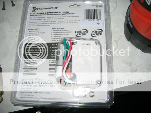

per the pic above you can see it in the package with red/white/green/black wires. Right now the fan only is hooked up with white/black. So just tape up the green and red? I hate to open up the box and read the directions if it's not usable but was wondering why the red is there?
Black and white probably supplies power to the timer. The red probably supplies power to the load (fan in your case). Green is ground and will be caped off and not used since your circuit is ungrounded.

Is there a make and model number on the switch? Is there any writing or anything embossed on the case. For example where the red is there a "C".
i took the electrical tape off and there was a label under it for FD 600 40W incandescent and the reason for the tape is that the unit was 'falling apart'...rodale company
nothing like a C or any other marking BUT that label on top is all worn off so that probably said something
i can tell you that the red and black wires that are in the same sheath go to the dimmer but the white from the dimmer goes to the outlet
i peeked up thru my grill and it would take a bit of work to take apart the light fixture but it can be done so probably tomorrow i will.

my 2nd picture in the first thread somewhat shows this though some things are hard to see....there are 3 sets of wire coming into the box. Ill call them run 1, 2, 3.
All white wires from the 3 runs are tied up together with electrical tape and then one white wire comes out of that bunch to the left side of the combo switch. Then a white wire from the right side of the combo switch goes to the dimmer.
From each of the 3 runs is a black wire: 1 running to the left side of the combo, 1 to the right side of the combo, and 1 to the dimmer.
there is only one red wire coming from any of the 3 runs and that red wire runs directly to the dimmer.

[QUOTE} All white wires from the 3 runs are tied up together with electrical tape and then one white wire comes out of that bunch to the left side of the combo switch.[/QUOTE] Is that the screw for the switch or the receptacle? What color is the screw, brass or silver?
From the switch or the receptacle? What color is the screw?
Which cable;s black goes to each device and the color of the screw it fastens to? At the combo treat it as a separate switch and receptacle and tell me which cable goes where and the colors of the screws.
I think I about have it but I want to be sure.
Refresh my memory how many wires of the 3-conductor cable are connected at the light and how?
ok so if i take the red off the dimmer and the fan still works does that mean the fan isnt using the red?
Refresh my memory how many wires of the 3-conductor cable are connected at the light and how? I thought the dimmer was connected to the light?
yes dimmer is to light, i got confused
and in your pic F should be silver and G is brass but probably doesnt matter so ill stick with your data:
1,4,6 are tied together then a new white wire comes out of that bunch and goes to silver G
the dimmer for the fluorescent has all the same screw color (though could be just dirty i guess) and you can see from my pic above they are all on top: 2 goes to B; 3 to C and F to A
5 to D
7 to E
Also i do not know which black wire runs the outlet and which runs the fan. I guess that's just trial and error but i'd have to ascertain that before doing the new fan timer of course.
  #34
Old 11-01-09, 08:11 AM
ray2047's Avatar
Join Date: Mar 2006
Posts: 29,711
There seems to be some problems with the way this was originally wired and this is giving me a problem advising you.
Unless the dimmer is part of a 3 way circuit it should only have two wires connected to it. Are you sure there isn't a second switch that controlled the light?
That part makes sense. One of those three wires brings the power in. Do you have a meter so you can disconnect each cable and measure to see which is power in. Just disconnect the blacks and red and measure to the white bundle.
5 to D 7to E
This is a problem because it seems like they are using wires from two different cables for a switch loop. That isn't permitted.
Remember I said it looked as if the power cable came in to the box? I'd expect to see at least two of the blacks and/or red tied to together. Another reason why we need to know if any of the wires are hot to the white.
3 to C and F to A
So basically C and A on the dimmer are jumpered to together. If this is not used as a 3-way one of those connections probably should have been left off. Also a white wire should not have been used to connect to F but that is minor.
OK my bottom line if I was doing this I would not even try to figure out the original wiring. You have three cables two fixtures. I would open both the fan and light and find out if there are two cables to either one. When I had determined which of the three cables was power in and which cable went to which fixture I would then wire it logically ignoring the old connections. Note one of the three cables may simply cary power somewhere other then the bathroom.

i hope this answers the questions..no blacks are tied together, those seem to be what controls each thing individually
removing any one wire from the dimmer switch makes the flourescent not work..so it definitely needs all 3 wires ( i think?). I guess that means i need a new combo switch.
removing black D makes the fan not work
removing E black makes the outlet not work
no other light or outlet is controlled by other than i have described in this thread. (dimmer doing flourescent, switch doing fan, outlet is outlet)
knowing all this now i dont plan on taking apart fan or light. I took a peek at the light and it just woulnt be a fun thing to do so i figured knowing all 3 wires are needed on dimmer is good enough right? or is there a chance it's because this is hooked up to a dimmer that a regular switch may be able to handle the floursecents? I guess no harm in trying to wire the black 3 to D on the switch to see if that works right ?
edit: i just tried putting the black that was on the dimmer in place of the black wire i knew was on the fan switch..the light didnt come on, I'm not daring enough to try to put the red wire on the black fan switch since i dont know what red does

Ok now I can able sort this mess out.
Now with the dimmer that is a true flourscent dimmer and it will need two hot conductors to order get this function and I belive it is a matched set so leave that alone unless you plan to replace the flourscent luminare to differnet luminaire or change ballast so you can have use common toggle or rocker switch or motion senser if needed to
Now let me give you my break down how it should line up
1,4,6 and G is netural that is fine with that part.
The fan conductor it should be on "E" that will be on switched side of the combo unit
the main power soruce will tie to D and make a jumper lead to A that is power soruce for flourscent dimmer { becarefull those devices are not cheap and easy to find }
that should make it work I don't have paint shop thing with me to make a drawing but I will figure a way to post a drawing here so it may be later tonite I will able post it.
Merci,Marc
