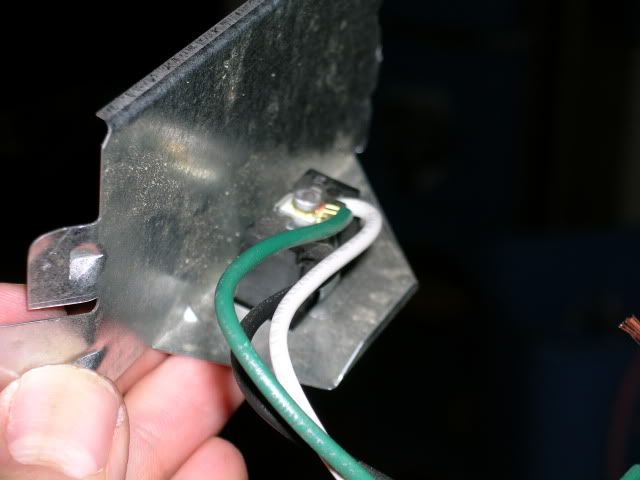

I have a nutone wall heater. wire enters into the all steel rough in box via NM connector. The heater assembly is attached to the plastic cover and The wires are all located here. there is a green wire that is grounded to the assembly shown below
My question here is that the rough in box does not have a ground nor is there any hole for a ground wire in the built in electrical box. I suppose when the heater unit is attaced via two sheet metal screws that the box is then grounded. But shouldn't it have a direct ground? I suppose just use a grounding clip here?

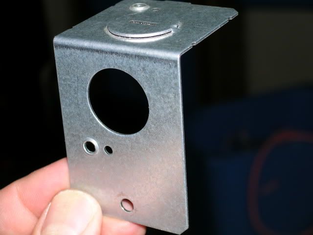

on to the fans with similar issues. here is cover for one of them.
wire will enter through hole and then splice to the 3 wires inside unit. The ground inside unit connect to the metal box housing the fan and then splits and goes to the motor. Question here is do I need to ground the actual cover since you could actually remove it with wires still all connected and once you pull it away from the box it would no longer be grounded. I tried to put ground screw in the holes but they are not threaded and a ground screw would not start in hole.

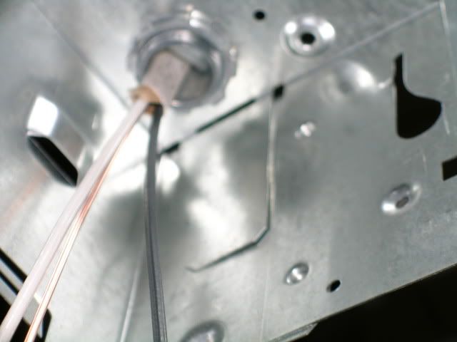

opposite issue with this fan. here is the mounting box
and here is the corner piece that contains the wires and a plug for the motor.
so the ground connects to the corner cover piece which then slides into the corner of the box. But the box itself doesn't have ground other than this slide in connection. Once again I tried to put screw in that hole but it wasn't threaded either and I could not get the screw to start. I would think that if you are supposed to ground these that they would have the proper holes in them so since screws wouldn't start I thought maybe they didn't require anything additional.

Looking at your third picture it appears there is a bump with a hole. (kind of middle, top, right.) Is that threaded for a ground screw? I would not worry about grounding the cover because it will be grounded when attached to the fans can.

No, that is the one that I tried but it is not threaded and I could not get a ground screw to start. I can try pushing a little harder, but it seemed to just be ruining the threads of screw.
what about the heater? The whole enclosure is steel but no holes for ground. one screw just goes through plastic into box but other one goes through steel plate that is grounded and that plate contacts the box when the screw is tightened. when loosen the screw and pull it out and then pull unit out the box becomes ungrounded.

Just an FYI - a switch, that is attached to a metal box, with metal screws, does not need to be connected to a ground wire. 404.9(B)(1)(2005)
I suggest drilling and taping your own hole. It must be a taped 10-32 hole for a green grounding screw.
