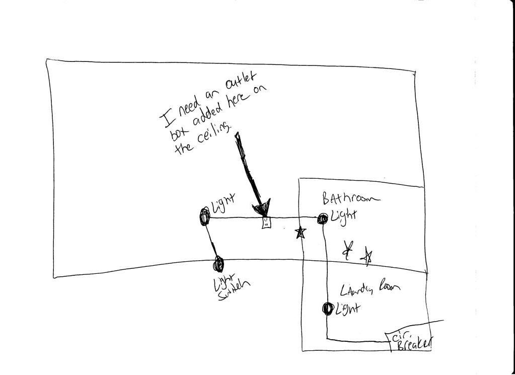

3) Also in this picture I need to add 1 outlet box to an existing wire....I follow the wire and it looks like it is only powering 3 lights and 1 light switch.....can I add a plug outlet box where shown on the picture..........and/or (the stars are the location of boxes and light switch)in the bathroom area I still need a light switch and an plug outlet box also?? is that possible.

Your diagram suggests you are switching neutral, a major no-no. I would suggest you pick up a book on basic house wiring. A very good one is 'Electrical Wiring-residential' by Ray Mullin. Get the revision for 2008 NEC, available online. And don't forget to get this work inspected.

I dont know what switching nuetral means? what u see in the picture as far as the light being hooked up was already here when we moved in....I was just windering if I can add to it? I bought a book called wiring step-by-step...
That should work but the cable between the bathroom and large room will likely not have enough slack. You must have at least 3" of free wire outside a box. It would be easier to just run a new cable from the bathroom light or large room light, What ever is closer, rather then trying to splice into the existing run.
