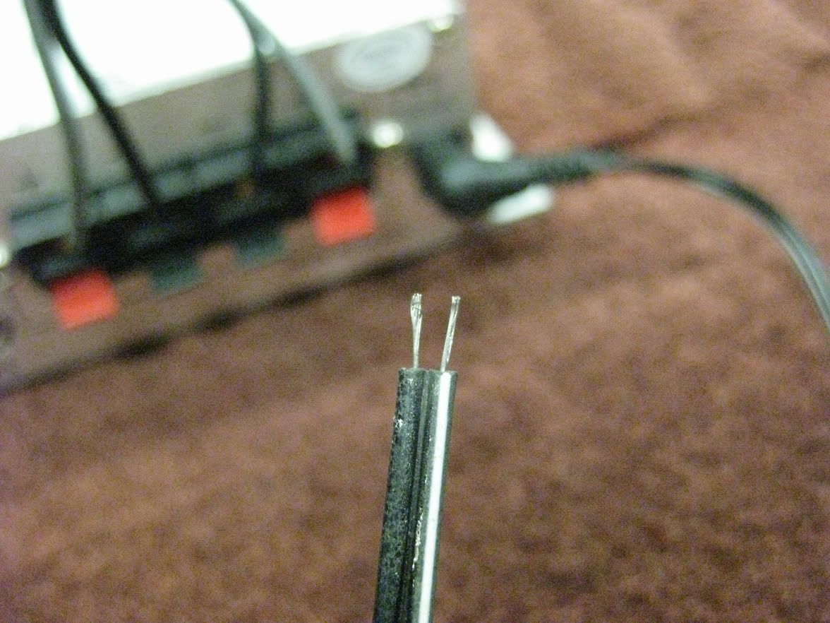

Hi! I Google'd "electrical forum" and this was the second hit. And the name seems to fit: do-it-yourself.
I say this because my question doesn't really fit in with other people's topics too well. I'm not wiring a house. I'm just trying to get my amplifier powered.
So, I bought an amplifier on eBay (big surprise) and it came with a power cable:
That's where it plugs in. If you can't read it, it says DC12V2A. And let's just say that's the most technical information I have on it, lol. But, for some reason, the other end is just wire:
And there's the problem. I tried searching for what to call this thing (whatever I need), but I had no luck. I'm tempted to just plug those into the wall outlet (just to see if it will turn on!), but it took like 3 weeks to ship from China so I don't want to blow it up (or kill myself in the process).
So, right. How can I turn those wires into something that will plug into the outlet, safely? No need to spend a lot of time, I mean, if someone can just give me the name of the thing I need? I'm all for DIY stuff, though, so aluminum foil/bobby pin-solutions are accepted.

If you just plug the wires into the wall you will destroy your amplifier!!! DO NOT DO IT!!!!
What you need is a 12 volt transformer that supplies at least 2 amps (24VA) Smiler to this: http://ep.yimg.com/ca/I/spytown_2081_45148867 Just google 12 volt transformer.
Be sure when you hook it up you have your polarity correct. The outside of the plug to the amp needs to be the negative and inside positive.

This is not made to be used on AC power like you would find in a regular electrical receptacle. This is made to be used either in a car or with the use of a step-down power supply similar to a laptop.
Do not attempt to use this without the proper power supply.

Got it. Won't be plugging it into the wall.
Yeah, now that I think about it, I think the picture on the description @ eBay was inside a car...
OK, transformer. Would it be bad if I bought one that was more than 24VA/watts? I've found some that are 40W and 60W?
Inside positive / outside negative: wee bit confused here. Where does this a role? And I did a quick search and it sounds like it doesn't matter which end is positive/negative when it's black/white?
I mean, one is full black and the other is black with a white stripe?

Usually that is not a problem. You also need to make sure that you're buying a 120V AC to 12V DC power supply, preferably voltage regulated. A simple transformer will not work.
A surplus computer supply will do the trick if you happen to have one of those around. You would use one set of the the black and yellow wires to get 12V DC.
If you pull the plug out of the back of the unit, you'll see it has an inner metal surface and an outer metal surface on the shaft of the plug. Each of those surfaces connects to one of the wires. Once you get your power supply, it is important that the negative (-) terminal on the power supply connects to the wire for the outer surface on the plug. The inner wire connects to the positive (+) terminal on the power supply.

Hey Guys something very important left out!
DC12V = Direct Current @ 12Volts
You need a 12 volt DC supply You will still burn the unit up if you plug it into a 12V AC transformer!

No. A transformer that has a higher VA/watt rating is fine.
If it was AC it wouldn't matter but since it is 12 DC it does. After you get your transformer hooked up, take the small end that goes to the amp out and connect a meter to it. Set the meter to something higher than 12 volts DC and connect the black lead (negative) to the outside of the small round plug. Insert the red lead (positive) of the meter into the middle of the small plug and make sure the lead touches the inside. You meter should read something around 12 volts or +12volts. If it reads -12volts then change the two leads on the transformer and retest. You are working with low voltage DC so there is should be no danger working on it hot.
You are very correct! I forgot to mention that. Thank you very much for pointing that out! That maybe a little harder to find cheaply You need one at least 2A 24VA or 2000mA

The emblem on the unit shows the circle with the line coming off of it to the left is the Negative terminal and the dot to the right with the line coming off it to the right is the Positive terminal.
This is like something that is used in a car, with a car battery.
What you need is a DC power supply rated at 12V DC 2A.

OOOOOHHHHHH. I get it now, the picture means negative outside, positive inside.
All right. Let me get some terminology straight.
I need a 12 volt DC transformer that is rated for at least 24VA. This turns the 110V AC from the wall to the 12V DC needed. This is also known as a power supply? But I need to get a power supply that turns 110V AC to 12V DC and not to 12V AC. Right? And so this is like a whole new cable? Or will it be able to use the two naked wires I have now?
Definitely, there are some small electrical stores that I could stop by.
Correct.
Correct again.
If you can get one with the proper end on it you will be good. Otherwise you could cut off the old end and splice yours on. Again, test to make sure you have the proper polarity.

That's it....the *only* one available that would work is the $40 Radio Shack one. I've tried thrift stores, small mom-and-pop electronic stores, chain electronic stores, Wal*Mart, computer repair shops, electrical contractors (funny phone call), my siblings: NO ONE has a DC 12V 2A adapter. There are some DC 12 2A for cigarette lighters (like that'll do anything) and some 1.3/1.5A adapters for wall outlets. I must be looking for the Holy Grail or something...
I didn't get enough time to stop by Radio Shack again for them to "measure" it out. I found one on Amazon that has six different pins (need to compare sizes), 12V 2.5A, wall outlet, switchable polarity (oh yeah), and $21. It's more than I want to pay and add shipping to that, but Radio Shack is not going to abuse me!
Oh, it's for an amplifier. There's a picture of the back there on the first post..
I'm tempted to find a old computer supply for mine and jimmy-rig the wires onto a 4-pin Molex (which has 12V+) since that's basically what I need. But then there's fan noise and trying to mount a power supply onto a wall (where the speakers will eventually go) might difficult. Oh, well.

But don't you already have a plug for the amplifier so all you need is the power upply and splice it to the cord. You are making this harder then it needs to be. Heck, a quick Google Advanced Search turned up many incuding several here: 12 Volt DC External Power Supplies, Low Power, 1 to 70 watts, External

Yeah, that there is the issue. I give in. Radio Shack it is and that's only because they have the only 2A adapter available. The fact that they can give the right adapter is only a perk; the splicing isn't an issue, really.
Thanks for all the help, guys. I truly appreciate it, even though it sounds so simple now that I look back. Still, I had no idea about the volt/amp thing or even the AC/DC thing, so I've definitely learned something.
All for the want of an adapter....

Here's one for six bucks plus shipping. You will need an input cord for it but you may have one already. If not they are also available.
12V @ 2A APD DESKTOP SUPPLY-MPJA, Inc.
