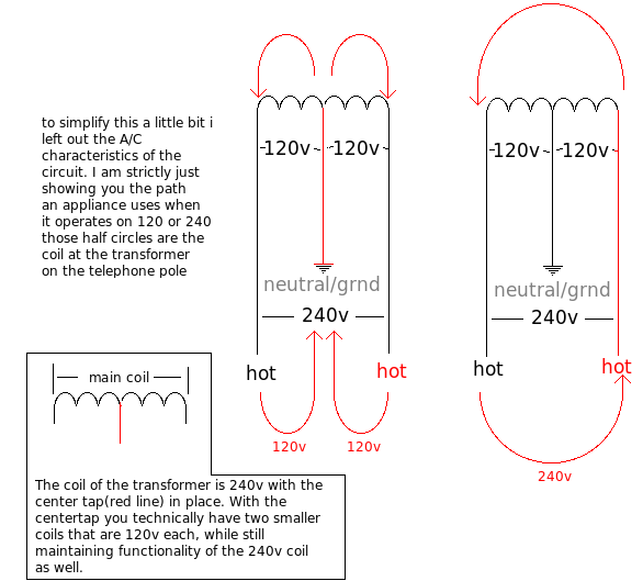

i suppose you could have 200 amps travelling on one leg but not both at the same time the double pole breaker will trip if both sides collectively have over 200amps or one side has over 200amps.
if all you had was 120v in theory you would only have 100amps, because if you can picture the transformer up at the pole, the secondary side as a whole is 240v with a center tap(neutral) to split it up into two legs of 120v. so technically you would be dividing it in half
and no your getting billed for the power consumption for 44 amps x 240volts. 88amps does not exist in this situation there is no way of looking at it that it will be 88 amps at all.

"i suppose you could have 200 amps travelling on one leg but not both at the same time the double pole breaker will trip if both sides collectively have over 200amps or one side has over 200amps."
Ok, let's assume you have a single phase panel with a 200 amp MCB. You have all 120 circuits with a load of 110 amps on each side of the panel. Collectively you have a 120 volt load of 220 amps. What will happen?

The neutral conductor (transformer center tap) carries ONLY the DIFFERENCE between the two outside conductors. If the load from one outside conductor to the center tapped conductor was 110 amperes AND the load from the OTHER outside conductor to the center tapped conductor was also 110 amperes there would be no difference between the the loads carried on the two outside conductors and therefore NO CURRENT ON THE CENTER TAPPED (neutral) CONDUCTOR! The total load would be 110 amperes at 240 volts or 26,400 watts. This could be confirmed as a load of 13,200 watts on each 120 volt circuit which when added together equals the the 26,400 watts at 240 volts.
A 200 ampere, 240 volt service has a capacity (at least peak capacity) of 48,000 watts (48 kilowatts) therefore the load on the above example of 110 amperes is only 55% of the total capacity.

i understand ohms law, but bear with me here. This blow dryer at 120volts drawing 10 amps has a power rating of 1200w
now if you do the formula for power (P) over (I), (E)
P/E= I
1200w/120v = 10a
1200w/240v = 5a
the characteristics of the load change with the voltage as the voltage increase or "pressure increases" there is no need for as much amperage to push through the resistance.
