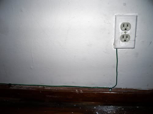

Just thought I'd post the oh so professionally done grounded outlet that the guy did today. I hope my cats don't try to play with it.
  #55
Old 04-15-10, 12:45 PM
ray2047's Avatar
Join Date: Mar 2006
Posts: 33,597
Likes Received: 13
And which third world country is this apartment in? He's not even in the ballpark with that. Once you have another apartment lined up I'd call the city electrical inspector and let him know what is going on. Heaven knows what other hazards has been wrought by this guy.

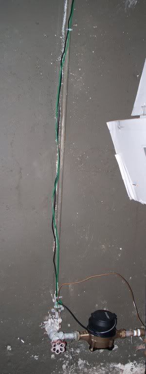

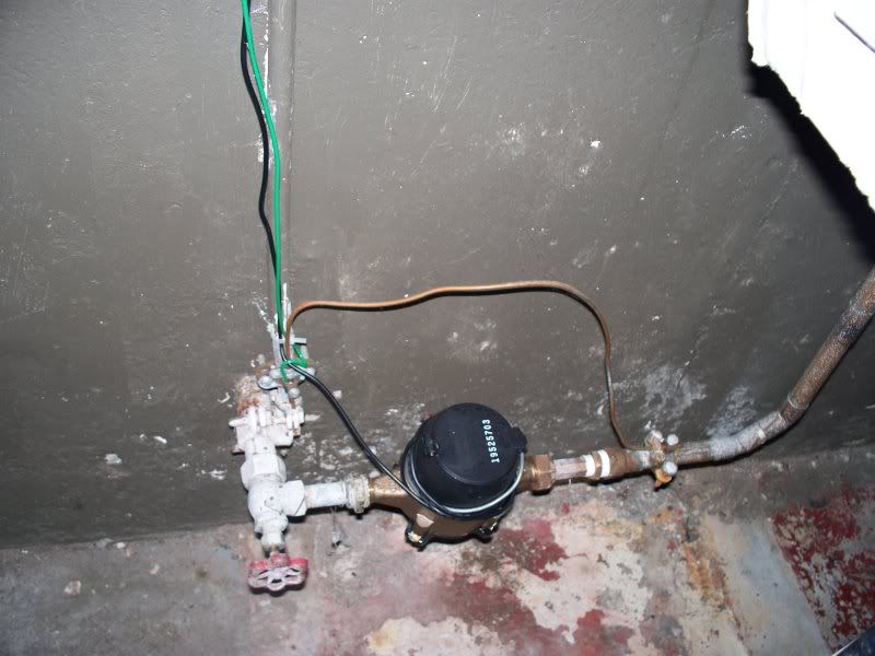

I found where one of the ground wires he put in goes....is this normal?
It's attached to the water pipe that's going to the outside.
  #57
Old 04-15-10, 01:21 PM
Join Date: Feb 2005
Posts: 10,810
Likes Received: 14
At least that part's right...

Idon't see the main ground so is it within 5" of the main ground are is that just the jumper for the water meter? The black wire seems to be the water meter remote reader cable.
  #59
Old 04-15-10, 03:37 PM
Join Date: Mar 2010
Posts: 23
Yep, the black wire is for the water meter. What does the main ground look like? Is it supposed to be by the breaker box? The wire here is coming down from the basement ceiling.
  #60
Old 04-15-10, 04:45 PM
ray2047's Avatar
Join Date: Mar 2006
Posts: 33,597
Likes Received: 13
Yes, the ground wire comes from the main box and IIRC code said add-on ground must be connected within 5' of the main ground. But let the pros weigh in on that.
  #61
Old 04-15-10, 05:02 PM
Join Date: Mar 2010
Posts: 23
Oh ok....the breaker box is all the way on the opposite end of the basement from the water meter, 30 feet maybe. Someone's coming tomorrow to put that ground wire in the wall whew!
