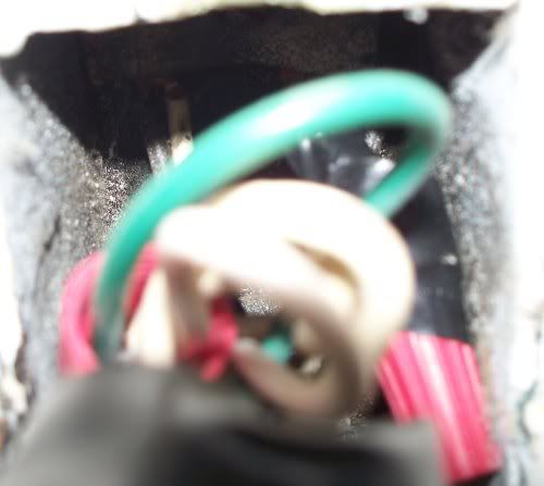

Old 03-31-10, 03:26 PM
Join Date: Mar 2010
Posts: 23
Ok, I took a picture because I'm not exactly sure what I'm looking for
The test lights say that it has correct wiring. I have a multimeter, I just don't know how to use it yet.
I looked at a different outlet where he switched the plug out but didn't ground it and it doesn't have the green wire.

Old 03-31-10, 05:38 PM
Tolyn Ironhand's Avatar
Join Date: Nov 2007
Location: Twin Cities, MN
Posts: 12,937
Received 55 Votes on 48 Posts
Originally Posted by LadyElan View Post
There's a lot of tape wrapped around the outlet. Would it be safe for me to unscrew the outlet to look behind it?
Yes, it would. It would be even safer if you turned off the circuit at the panel.

I turned the circuit off just to remove the faceplate before
It looks like the green wire goes from that red thing to underneath the tape on the outlet. I didn't see green wire anywhere else.
*Thanks pcboss!

Sorry, but the photo isn't very clear. Could you try the macro button when you take a closeup? Sometimes it looks like a flower.

That is wired 100% WRONG! The ground is not to be connected to the neutral wire. If this was done by an licensed electrician report it him to the state board at once.
While the tester will indicate it is wired correctly the ground needs to be connected to a grounded metal box or a ground wire that is run to the electrical panel.

That fix is both illegal and dangerous. You can now have neutral current flowing on any metallic parts and could receive a dangerous shock or worse.
The landlord needs to have this fixed properly.
This is the bootleg ground that Ray IIRC was talking about.

hold up one second though...is that white wire the same one that runs to the silver screw or does it come thru the back of the box by itself.
in 1950s-60s they sometimes daisy-chained a single conductor between the outlets to ground them. my grandparents house was this way
so you gotta check one more time and see if those wires are separate or if they are the neutral wires for the outlet
the only reason I question that is the style of metal box and it looks like there are lots of white wires

She has a green tied to a white. That is wrong period, no exceptions. Follow the middle white wire and you will see where it goes under the tape.

It looks like a bootleg ground to several of us. If a separate conductor had been run to ground the boxes they should have used a green or bare conductor to avoid this confusion.

I got better look today. There are two pairs of black and white wires coming through the back of the box, one pair on each side.
I was telling the guy while he was doing this that I wanted to work on my computers with an anti-static mat and wrist strap and it had to be plugged into ground and then attached to my wrist

While not wrong in and of itself for me tape around the receptacle is a bit of a red flag. Normally it isn't needed and most pros don't do it.

That is one of the situations when a bootleg ground can actually be very dangerous. Anti-static equipment should only ever be used when there is a good, verifiable ground (ideally isolated). This problem is a good catch.

Although I wasn't alive at the time. Im pretty confident that green or bare wire may not have been very common in the mid 1900s
But now that the OP has stated that there are 2 blacks and 2 whites pigtailed we unanimously can say there is a bootleg ground and it must be removed and grounded properly for your computer safety equipment.
