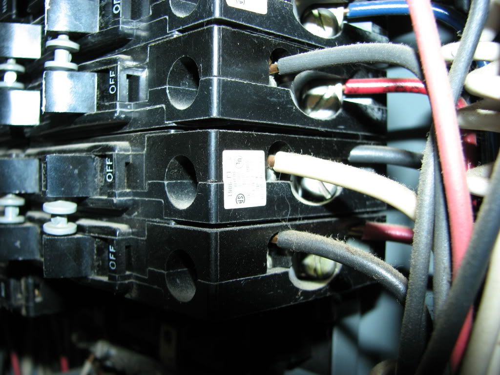

Hi,
We had our dryer installed on one 4 pole 30 amp breaker. Since they no longer make those, the electrical shop sold us 2 30 amp two pole breakers. We are to remove the quad and put one in that slot, and the other will replace a 20 amp that is not in use. The two new ones look just like the 20 amp we are removing. The question is: which wires go where? I ASSUME (but you know how that goes) that the white and black attached to one half of the quad goes to one breaker, and the black and read on the other half will go on the other, and that we should simply be very careful to label everything right for future reference. Am I right or not and why if not and what do I do if not. :-) Pics attached, bad breaker to be replaced is the bottom right. Non used breaker to be replaced is the bottom left. Close up of wiring to old 4 pole breaker.

Are you certain that all four wires feed your dryer? Typically a dryer requires a single two pole breaker. I've never seen one that needs four hot conductors. My guess would be that the other two hots feed another piece of equipment.

Even if it was a commercial 3-phase dryer it would only be a 3 pole breaker. What you had was two 2-pole breakers combined into one. The breaker provided power to two different loads.
Yes, that is probably correct. The red and black should be part of a 3-conductor cable. That cable provided 120/240v to the dryer. The black and white a 2-conductor cable that provided 240v perhaps to a room heater or water heater.

No, you have 4 single pole tandom breakers in these four slots with breaker ties. So you have 4- 240v circuits in this mess. So if you look at the bottom 2 single tamdom breakers with ties on the bottom right, the top wires ( black & white is one 240v circuit ) the bottom wires ( black & red is one 240v circuit ). This goes the same on the 2 single tandom breakers above this one. (Black & red is one 240v circuit) & bottom ( red & blue is one 240v circuit). Hope this helps.

How many circuits come into this panel? With the handle-tied double-quad in the bottom right and the two double-lugged breakers in the left column you might be exceeding the panel design specs. Where do all these 240V circuits go? Baseboard heaters?
Have you thought about mounting an adjacent subpanel?
Fixes that should also be done:
1) Mark white hot wires that go to breakers with red or black tape/ink/paint.
2) Replace that black wire that is nutted to the white and bare halfway up the right column with separate white and green/bare extensions.
3) White neutral wires on the neutral bus should be one-per-screw. Bare grounds of equal gauge may be doubled.
4) I'm not sure what that lone green wire wrapped around the mounting screw below the left column is, but that should be landed on the neutral/ground bus with the other grounds.
5) I don't see any GEC bond to the water pipes or ground rod. Is this perhaps done at the meter can or is there another ground bar in this panel that's not pictured? Is there another panel upstream of this one, maybe a main breaker at the meter?

Nope I'm not at all certain that all four wires went to the dryer, and its just your basic GE circa 2002 cheap dryer, now that you mention it its possible that our well pump is one set of wires. My fiance has a penchant for not saying things in order, talking in circles and not answering direct questions directly. Are all you guys like that? LOL I know its an OLD panel, my fiance has been here around 15 years and hasn't touched it except to reset the occasional popped breaker. So this dryer thing is the first good look and educational process. Probably a good thing! I'm the one around here with the time and inclination for self education helped by wonderful folks like you, but keep in mind I need step by step instructions and small words, lol. And it irritates me when things weren't done right the first time and I have to go through all this to get 'em right, or up to current standards.
Anyway, We did reattach everything the way I originally said, though now from what I'm reading its possible its wrong? We attached the two top wires, a white and black to one breaker and the lower red and black to the other breaker. So now its possible that our black wires are hooked to the wrong breakers?

The top two wires (white and black) are one circuit and the bottom two (red and black) are another. If you kept those pairs together on the two pole breakers, which it sounds like you did, you should be just fine provided the amp ratings of the new breakers match the old breakers. Good job.

Basically, everything that is attached to a circuit breaker should be either black or red. If those wires are not, they should be colored with either paint or tape to be black or red.
Typically black wires are 1,2,5,6,9,10,13,14,17,18,21,22,25,26,29,30,33,34,... you get the idea I'm sure. Reds are the remaining. Black/Red perfection isn't crucial, so long as all wires are black you're OK.

In your picture, two spaces above the AFCI breakers (the ones with yellow buttons) there is a cable where the bare wire and white wire are spliced to a black wire which leads to the neutral bar at the bottom. The white wire should be brought to that bar with another white wire, not black. The bare wire should be brought to that bare with a bare or green wire. Splicing white to bare and connecting them both to the neutral bar with a black is a code violation. Both wires should be independently attached to the bar at the bottom.
Or better yet, in the top picture I catch a glimpse of what may be a seperate ground bar on the right side of the panel under a lot of wires. Land your grounds there, if I'm right, and leave the bottom bar for neutrals.
