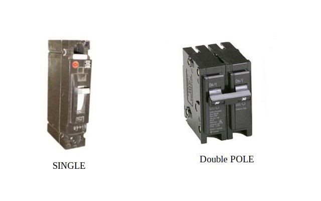

It was actually running before we called the electrician, it just wasn't heating. The dryer repair man said there wasn't enough electricity to power the heating element
Is the breaker for the dryer single pole or double pole? A double pole will often have two handles tied together. What is the number on the end of the breaker handle or breaker?
(Pros I'm wondering if they used a 120v from the fuse box and a 120v on the opposite phase from the breaker box to power this. If they used an exiting 120v receptacle circuit on the fuse box feed then part of the wiring could be #14.)

. It sounds like the dryer only had 1 hot leg and the 120v motor and electronics still worked but the heating element (240v) didnt work. THe panel could easily been mislabeled

The circuit breaker was doublepole, I'll have to check to see what the number on the end is. Like Danny7633 suggests, though, it wouldn't surprise me if things are mislabeled.

Try turning the breaker off and see if the dryer still works. I just want to make sure the wiring is safe.
