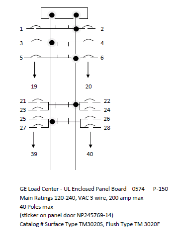

I have a 200 amp, 120-240 VAC, 3 wire main, 40 poles max panel (at my house) that is full but I only need a few available breaker slots. If replacing some of the regular sized 15 amp breakers with some 15 amp THQP breakers is possible I would prefer that over having a sub-panel installed.
I've have two pdfs to attach that show what my panel looks like (But for some reason DIY says I "may not post attchments"). One is how many breakers, amperage and what they for. The other is the electrical circuit diagram taken from inside the panel door.
Taking a look at my pictures would this be possible? What would be the limit of the half-sized breakers?
Even though the panel states that it can use THQP breakers does that necessarily mean they can be used (according to lets say West Virginia code)? Does anyone know if the West Virginia code can be accessed online if not where could I find this info out?

Excuse my ignorance, I'm not an electrician so I'm not sure. My question would be what counts as a pole?
The single 1 inch breakers are single pole (take up one slot)? and the larger sized breakers that take up two slots are 2 pole?
I have 24 breakers, 11 of those are 15 amp (1 slot), 4 are 20 amp (1 slot). 7 of them are the double sized breakers that take up 2 slots (20-100 amp range). And 2, 15 amp THQP half-size breakers. (This house was built in the 70's and I noticed a few months ago that one single 15 amp breaker had two separate circuits connected to it so I separated them via the half sized breakers).

I count 31 poles, or slots as you call them. You probably have a 30-40 panel which means you can get 40 poles by using THQP breakers in those spaces at the bottom of the panel that are designed for them. The drawing on the label inside the panel should show you where you can use the thin THQP breakers.

I wish you could see the diagram but anyway the circuit diagram shows up to 40 poles. 1 through 20 ( I'm not sure what the term is but are separate).
1 is on the left side, 2 is on the right side
3 is on the left, 4 is on the right and so on up to 20.
the lower portion has
21 and 23 are on the left side (together in parallel?) 22 and 24 are on the right side and so on up to 40.
Does it matter where the double breakers are in the panel?
Some are located in the upper and lower portion of the panel. If the half-sized breakers should go on the lower portion is it OK to relocate the larger double breakers to the upper portion?

It appears to me that THQP breakers can only be used for circuits 21 thru 28, a total of 8 single pole thin breakers. Those spaces would be, counting from the top, the 11th and 12th full sized spaces down on each side. All remaining spaces would only accept THQL breakers, full size. That would also work out to a total of 40 poles. The only THQP breakers you are currently using are in the 12th spot down on the left side. It looks like you could pick up about 3 circuits in the panel if breakers were rearranged.
Another thought, you could always remove the 20 amp 2 pole breaker for the well pump to make space for a subfeed breaker and then transfer the well pump circuit to the subpanel. The subpanel would also provide you the single pole breaker space you need.

CasualJoe - On the breaker panel drawing 1 - 20 are the same and 21 through 40 are the same I just drew the first few breaker rows. The 11th and 12th pots on the left are THQP breakers. That's what I was trying to verify was that THQP breakers could be used in the 21 thru 40 range.
What I was thinking of doing was moving the 40 amp heat pump breaker on the lower left side up and installing 4 THQP breakers in it's place than moving 4 of the 15 amp full sized circuits in that area over to the THQP breakers. I would also like to move the 20 amp mr slim breaker in the lower right corner up freeing up that area for more THQP breakers.
I think I asked this earlier and I think one of you might have touched on it earlier is if I counted up all the poles, the 15 and 20 amp full sized circuits are most likely single pole and the double breakers are 2 pole as long as I don't over 40 poles I'm should be OK?
I thought that at first too, but then I realized that would make the panel capable of a total of 60 poles. Assuming this panel was a few years old, that would be very unusual and probably a code violation when it was installed. The GE panels I am familiar with that take type THQP thin breakers are typically called 30-40 or 20-40 panels indicating the total number of poles that can be installed using all THQL breakers or total number of poles if all THQP slots do in fact have THQP breakers in them with the rest being THQL breakers. Regardless, the total number of poes was 40.
Perhaps I should directly ask, how old is this panel? Prior to the 2008 NEC, the total number of poles was restricted to a maximum of 42. I am not extremely familiar with the 2008 NEC, but I remember the 42 pole restriction has been relaxed. Maybe what you have is a panel that was manufactured for use in Canada where there is no restriction on the number of poles.

I'm not sure how your getting 42 poles. I count 40. On the upper left side odd numbers 1-19 I count ten. On the upper right even numbers 2-20 I count ten. On the lower left odd numbers 21-39 are ten and the lower right 22 -40 I count ten. Am I missing something?

Perhaps I have been over analyzing and not looking at the panel schedule. Backing up a bit, if you filled the panel with all full sized breakers, how many poles would you have? Looking at your panel schedule for a minute and forgetting the bus illustration, I count 30. Now, if you filled the lower portion with thin breakers in all the spaces they will fit and leave the full sized breakers above, how many total poles would you have? Now I count 40. I apologize for the confusion, what you have is a 30-40 panel. You can have a total of 30 maximum poles by using all type THQL full sized breakers or a total of 40 maximum poles by utilizing the thin type THQP breakers in the lower area. GI2
Now, your original question. Yes, you could add 6 or 7 additional single pole circuits by changing some full sized breakers in the lower section to the thin THQP style breakers
