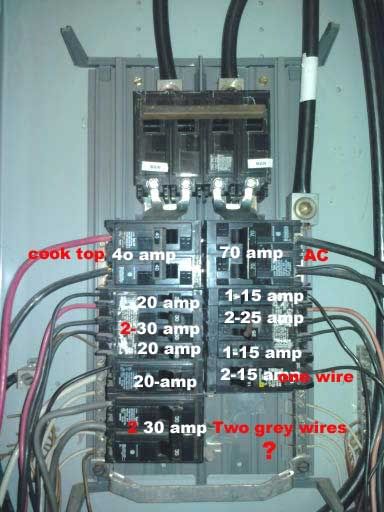

Here is the panel box picture and notes
The 70 amps are the A/c
The 15 amp under the 70 amp supplies the 3rd and end of trailer bedroom and the kitchen there are no dead outlets in these rooms.
The 25 amp double is the water heater, I assume. I know the water heats.
The 15 amp under the 25 amps supplies the middle bedroom and the second bath
no dead outlets in these two the Gfci was dead in bath #2 but It's source is traced back to the gfci in the Master bath.
The 15 amp double on the right with one wire only is the gfci master bath &outside & the # 2 bath
The 40 amps are the electric range
Then there are the three stuck toghether Breakers consisting of a 20 amp that runs the kitchen sink area and this all works Then there are the 2 30 amps that run the electric dryer the 20 amp below that runs the refridgerator and three wall outlets
then this 20 amp below them I don't know what it controls I did not check outside yet. but I replaced this breaker
The two 30 amps at the bottom are supllied by two thick grey wires I don't have a clue what they do.
The outage at the rear or master bedroom appears first as you enter the back door into the home, a cieling light is dead, take a right 2 or 3 feet and on the laundry room wall that makes up one of the master beds wall the outlet is dead then walk into the master everything is dead except the Gfci as discussed earlier. Thanks for any and all help

After replacing all receptacles and switches in the master bedroom and bath including a new GFCI, well the problem was in a switch that like the other ones had the wires pushed in from the rear. One hot was loose on it, after power came on, I immediately wanted to find the circuit breaker it was on, happens to be the missing black from the double 15 amp/breaker it was up on one of the 70 amps so I suppose it wouldn't kick-off when he used tons of lights outside. I've only owned this place for a month, anyway I appreciate everything ya'll did, including getting me to think more directions than one breaker. Thanks to all.

Good you are making progress. You I assume have alreay moved the black off the 70a breaker.

I am glad you are making progess to fix the mess here and with 70 amp breaker IMO that is way too big a breaker for A/C unit it should be 30 amp which it is more common and veirfy the nameplate on A/C unit it should stated " max breaker or fuse size amps ".
The two grey wire possbity for detached garage or well { water pump if you are out in country area } ( if that on well that is too big a breaker )

Yes sir I put the 12 gauge wire on the 15 amp where it belonged.
To french277V
Thanks for all the help and the gfci is working now on the three areas you said it should and the master is working off the stray wire that was on the 70 amp breaker that I will now replace with 30 amp, also just to let you know, there was a well there that worked at one time, now the pump and tank are missing so The grey wires are probably just that as there is no garage just a carport. I will find out and try to get the well back.Thank you
