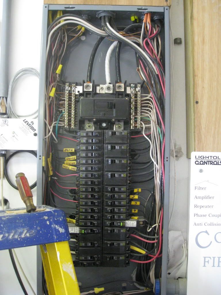

Your right, I guess the inspector let that one slide, because its a 40 slot main panel all slots were used and they ran out of room and put in a tandem in the bottom. Will have to cut and splice into new box to correct that.
Yes, the NEC defiinition apply. There are 3 120v circuits that would be continuous. There would be a 12-13a draw from an air cleaner that would run ~4-8 hours and a lighting circuit that would be on (~8a) at the same time. There could be an a/c draw as well that would be continuous and that would be ~19a. The machinery would typically be intermittent and doubtful of any past three hours straight. I was referring to the 120v circuits being on opposite legs to balance each other(used the wrong term (phase) sorry).
I'm not sure I follow you on the difference between #3 thhn and what guage SER? If both are #3 I see the difference between the two wires being 100 for thhn and 85 for ser using the 60 column for ser and 75 for thhn.
Gutter fill ---> mostly by gut feel, that is, will I will be able to snake the conductors in or not :O It looks like the panel was installed by pro's, but the one thing I would have done differently would have been to have mounted the unit with the main breaker on the bottom, that way you didnt have 3 2/0 filling up the 240v gutter side! In addition to that side having the main feed, there are also 2 10/3 circuits, 2 6 ga circuits, I believe an 8ga is in there as well. That side is kinda no go for pulling three large conductors. The 120 side is a little lighter with only 2 6 ga circuits coming in, but there are about 12 12ga. circuits on that side too. Here are some pics to show what I am describing.
Thanks for your input, pcboss
Last edited by chopnhack; 10-21-10 at 09:14 AM. Reason: added photos of gutter/confirmed 40/40

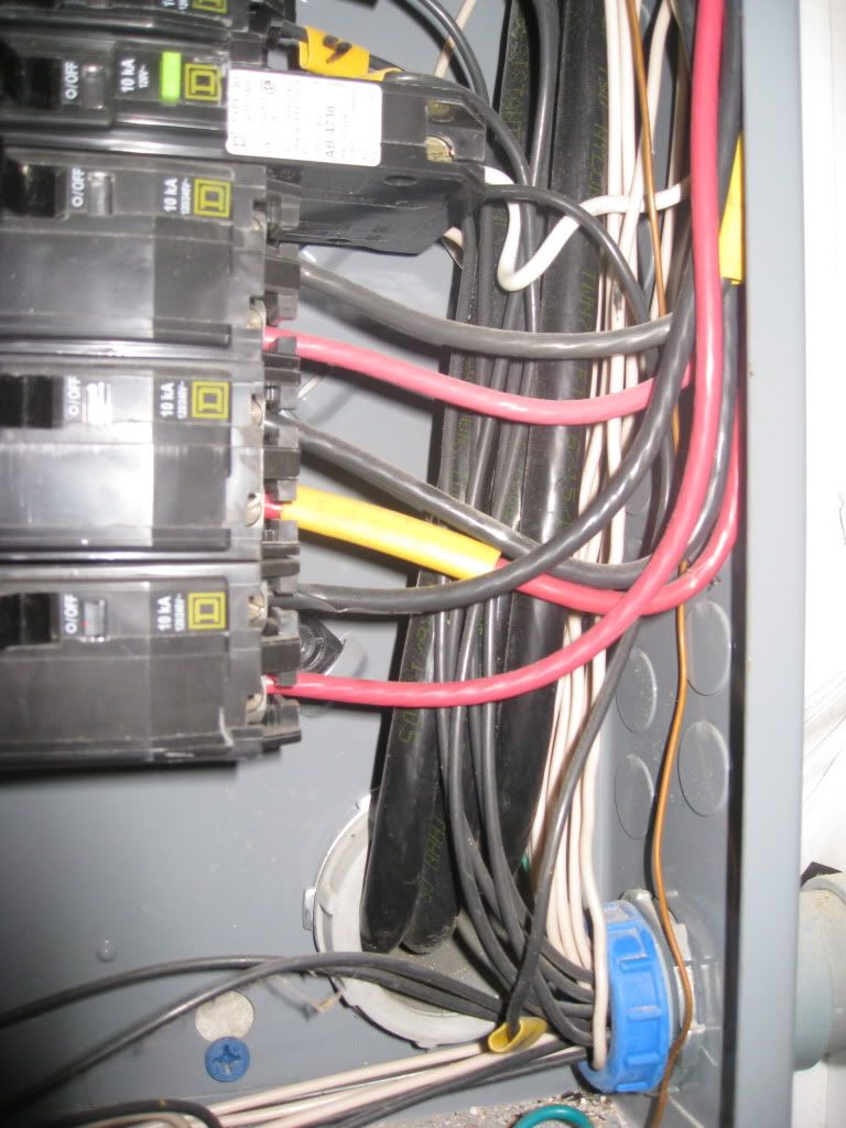

The breaker with the green button is not a tandem. It is either a GFI or AFCI breaker.
The white pigtail goes to the neutral buss and the circuit neutral connects to the breaker along with the circuit hot.
Not that one, keeping going down to the last breaker on that side. The picture is not the greatest but you can see two poles.

What I see below the breaker with the green button are three more two pole breakers. I will look on my larger monitor but i don't see any tandems.
A tandem is two breakers that fit into one space, typically the width of a single pole breaker. A double wide breaker like shown on the top right is called a double pole breaker. These are for 240 volt circuits or for a multiwire branch circuit.
Never mind, I was looking on the right side of the panel. I see the old QO tandem on the bottom left. Thanks Scott.

Bottom left breaker is the old style of QO tandem breakers which is why it fits. The old style QO tandems did not have the rejection tab. Also, the old style has the poles side by side instead of top and bottom.
Ah, there it is, sneaky, sneaky! And I was wondering why in a young box there was this old looking tandem! Thanks for the clarification.

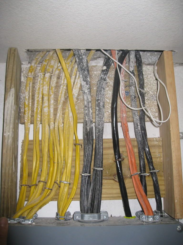

I'm not sure that this qualifies per NEC code, but the pro's that installed the main constructed a chase out of plywood and some 1x pt. The 1x pt was tapconed to the block wall and the various circuits were stapled onto the wood. At the edges of the tapconed wood and perpendicular to the wall, they put 1x4 and screwed this to the tapconed piece and then covered the 1x4 with 1/4" ply. The chase though was left open into the attic, no firestop or anything. Doesn't code say that there are to be no protrusions between xx and the interior cavity unless filled with fire stop or does that only apply to living quarters?

From your description this sounds like a vertical chase and IMO should have be sealed to prevent the possible spread of smoke and fire.

This is more of a building code issue than the NEC.
At a minimum I would stuff fiberglass insulation into this. Perhaps an endcap could be made and the end firestopped.
Can you post a pic of this? This would be difficult to seal with firestop given the size of the whole chase.

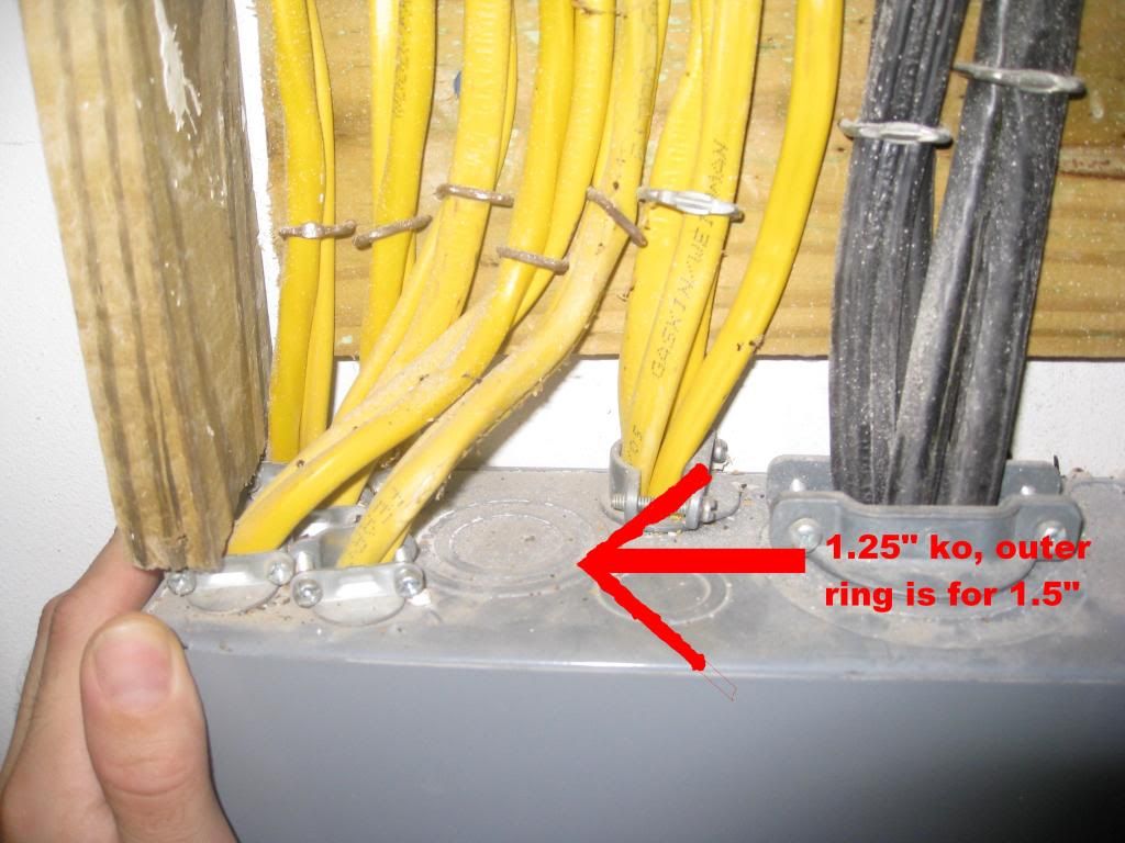

The small cable is for a doorbell and it comes out the right side of the chase. Can you have high and low voltage cables inside the main panel? It would be a cleaner install to just run that through the panel and exit on the bottom.

The doorbell wire should not be run thru the panel.
The connector in the top center and the one immediately to the left are not correct. There are too many cables routed thru them.
I am not sure if the connectors used elsewhere are listed for use with both the round and flat cables at the same time.
RE: the chimney created by the chase, I would stuff the fiberglass near the ceiling and then put a drywall panel over the studs.

Agreed on the connectors, I will have to play with the k.o. configuration. Assuming the other cables stay in place, do you think I will be able to access this k.o.? The front of the chase is covered by 1/4" plywood.

You could remove the staples and finese the cables out of the way and then restaple them within 12" of the panel.
