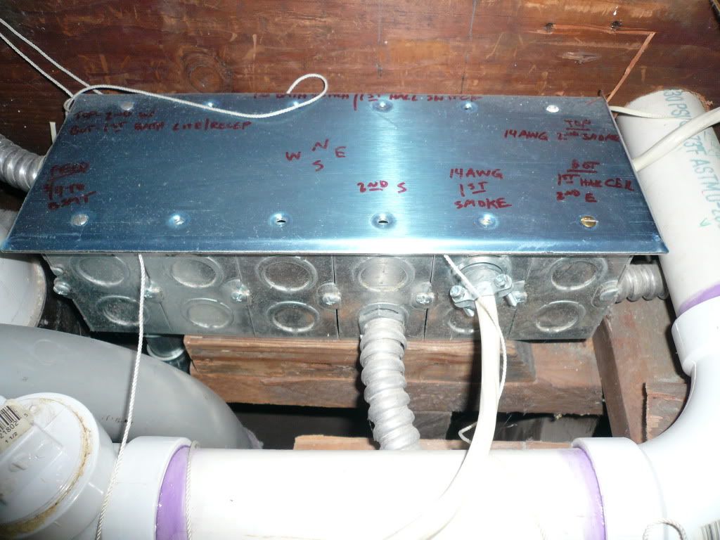

If you want something that you can put a pretty cover on, I can't remember the size of this 6-gang, but it's well over 42 inches:
8x8 = 64
64x4 = 256 cu in
So that's fine.
The bigger the better.
DO NOT SKIMP on the excess you leave for splicing, especially with solid conductors. It will be a lot easier if you leave it much longer than the required 6" or so. When I did the pictured box, I bundled the wires to be nutted and cut them about a foot above the cover plate. It's easy to fold the excess in, especially with 256 inches.
