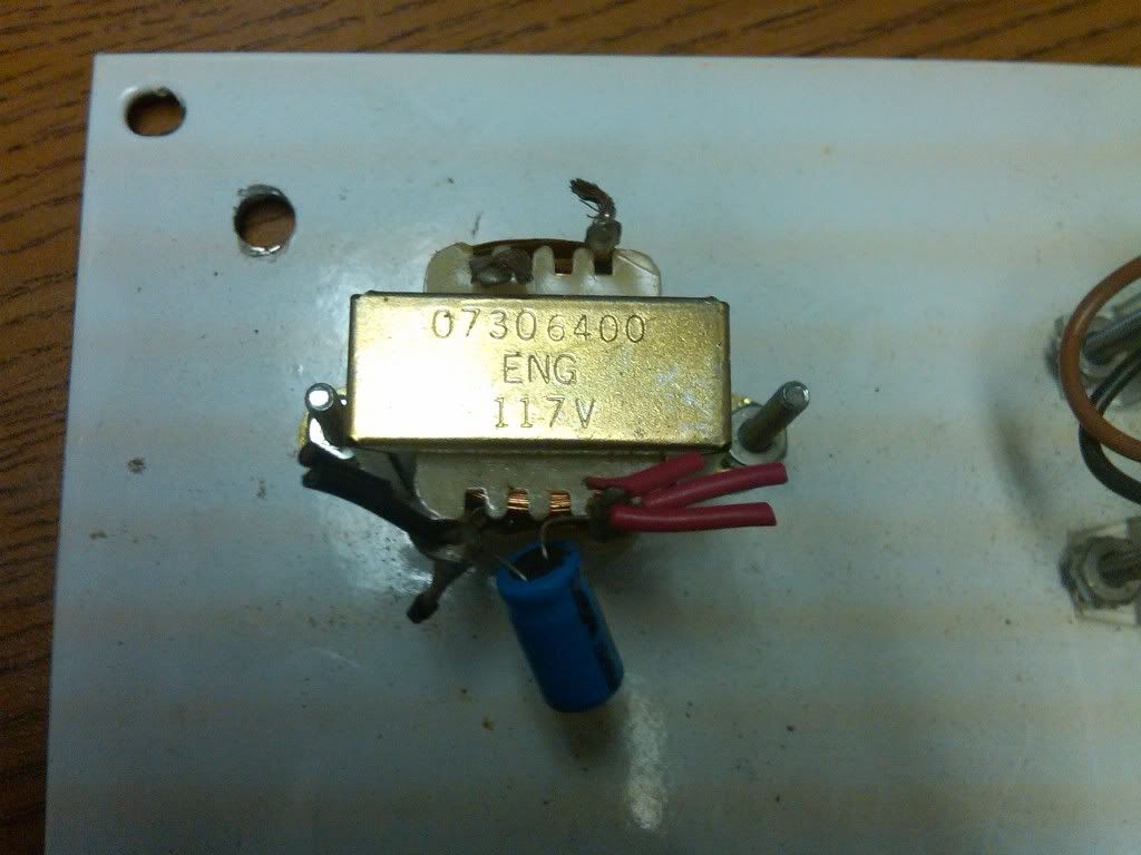

I have seen DC voltage produced by only using a capacitor between + and - off of a transformer and nothing else. No bridge rectifier.
Can I expect usable DC power by doing this?

I measured the power coming off of the transformer with a meter and it was 11.7 VDC and 0 VAC. It does something... Not saying I would use it though.
I would rather not use a wall wort, this is going to be wired in in commercial applications.
You can use a single diode and a larger cap to make up for it but only in low draw applications.

Then there is a rectifier built inside the transformer casing. There is no such thing as a transformer that steps down DC to DC. Nor is there any such thing as an AC to DC transformer. The transformer steps down the AC voltage from 120 to 12, then a rectifier changes it from AC to DC, and the filter capacitor smooths out the ripple. Whether this happens internally or externally is up to the manufacturer. But there is no possible way that a raw transformer can have a DC output.

I will take it apart when I get to the shop. (maybe post some pictures too) But I don't think there is anything inside the transformer. It's just a transformer, no plastic casing or anything. I'll check inside of it, but also I will measure the power coming out of it when I take the capacitor off.

Join Date: Nov 2010
Posts: 7
Here are a couple pictures. I did not see anything inside it.
This is one that is obviously not hooked up.
The thing that gets me is there are close to 100 systems out there using this for dc voltage. (powering 12vdc relays and 12vdc motion sensors) And they all work...

I've seen those before, usually in old portable AC/DC radios and alarm clocks (note the 117v, indicates at least 20-30 years old) The diodes are buried inside near the core. There is no room inside for the smoothing capacitor, which is why it is outside. Unfortunately there is no direct replacement for these. I searched Mouser and Allied and none of the power transformers they carry have rectified DC secondaries. You are going to have to use a regular AC-AC transformer with a bridge rectifier and a cap.
