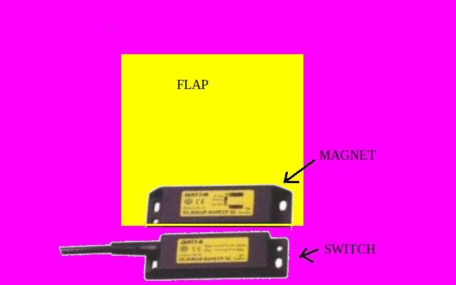

I have a question about a trigger system. I want to make a hockey shooter tutor as depicted in the images below. The puck passes through a hole in some plywood, and sets of a light to reward the shooter. Here are my ideal operation parameters:
1) light is AC - household wall plug, because this will be outside on a rink
2) putting puck through any hole should set off the light.
3) the light and trigger system should reset by itself in a short period of time - 5 seconds or less - to facilitate rapid fire sessions with several pucks
4) I am not an electrician so speak slowly...
Thanks for sharing your thoughts.
Yes, the light will be behind a mesh barrier so shooters don't pick it as target #6!

Or a magnetic switch because since there is no contact it might hold up better then a micro switch in the long run. The micro switch will take a minor hard pounding each time the flap moves.
I'm thinking there should be some type of timed latching relay so the light is on a full five seconds but that is above my skill level.
I'd sugest both a light and a klaxon horn but that would probably require a biger battery and more on time.

With a magnetic switch you would mount a small magnet on the bottom back of the flap and the switch immediately below. You would use a NC (normally closed) switch. The magnet holds it open. When the flap with the magnet moves the magnet away the switch closes.

Good idea. A magnetic door switch is slightly more expensive than a micro, but the lack of (external) moving parts will make it more reliable. I, too, thought of garage door safety sensors, but even the raw parts (photosensor) are much more expensive. Plus, the puck could slip through the beam without breaking it.
I still like the idea of a soft plastic or rubber flap instead of a hard one. As an added benefit, the damping it provides may eliminated the need for the netting at each hole.
Nix the idea of inserting magnets into the pucks. The magnets would have to be very beefy to produce a large enough field to trigger a switch from a distance of 3 or 4 inches.

The magnetic switch will work. It controls the relay so very little current is handled by it. My only concern is the magnet side of the switch. I would use small brass (not steel) machine screws (bolts) to help hold them on and bed them in a little silicon sealant. If the plastic ears proved to flimisy in use even with the sillicon I would put an aluminum strap over the magnet to hold it on.

I would suggest a piece of bungee cord stretched tight across the flapper. Some hardware stores sell it by the foot.
I would not mount a magnetic switch on steel but I could be wrong.
The switches need to be parallel wired not series wired because they are NO (normally open). There might be a way to use NC switches and series wiring with the relay but without seeing the wiring sheet I can't say.

Seven 1/4-20 bolts for each hinge?!?! My friend, you know how to build things for hockey players!
Switches wired in series means that all of the switches have to be on in order to turn on the light. Your drawing shows the switches wired in series, a.k.a. "daisy chain".
Your switches all need to be wired in parallel. That way, any one of the switches will turn on the light.
Here's the way I would wire it:

I think I have ordered the wrong magnetic switches . The two parts of the switches will be together at rest (potential ambiguity in my original diagram). Based on the wiring below in your diagram Rick, I would need N/O magnetic switches? If you assumed I have N/C switches, all is good.
If you assumed I have N/O switches I have two options:
1) go buy some N/O magnetic switches (likely would go this route)
2) mount the switches so they are offset at rest so the magnet swings by the contact instead of being together at rest. QUESTION - If I do this, do I simply move the wire to the beacon from the N/O contact to the N/C contact on the timer?; or is the wiring completely changed?
Ray, I tried a bungee to hold the flapper tight to the hole, but the flapper actually bounces back when the puck misses the target but hits the surrounding board. If the flapper just dangles, all vibrations are only transmitted to the hinge pivot, so there is no movement as a result.
thanks.

You can use a multimeter or even the beacon and power supply to see if they are NC. Just test for continuity with no magnet near. If you have continuity it is NC with no magnet.
Does that help?
The switch at your original link was NC. Surface Mounted Wired Glazed Door Window Magnetic Sensor Switch Alarm
