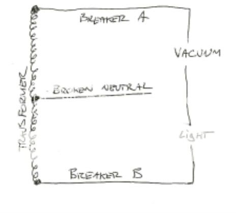

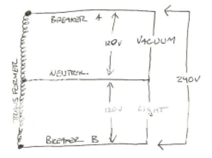

3. Somehow, the circuit between the living room and the bedroom are connecting, at least at one outlet. I believe that is the source of the stray voltage. The problem is that I can't figure out how. All I know is that when the vacuum cleaner was plugged in, the lights in the living room came on.
These are classic symptoms of an open neutral in a multiwire circuit. You also mentioned that the two breakers are right next to each other. Also a sign of a multiwire circuit. If you want to confirm this, and you feel comfortable doing so, remove the panel cover. From the two breakers you should find 2 colored wires (not white or green) grouped with only one white. This would be a multiwire circuit.
Maybe these pictures might help (Please excuse the poor drawing ):
This picture is a normal multiwire circuit. Current flows from the breakers, through the light or vacuum, and then back on the neutral. The neutral does not get overloaded because it only carries the imbalance of breaker A and B. (Note: Yes, I know current flows both ways, I'm just using the KISS method )
This picture shows the same circuit with a broken neutral. As you can see there is still a path for current to travel but it requires two things (the light and the vacuum) to be connected on the circuits. These two items are now in series on the circuit, and there is 240 volts across the circuit. This is why the light came on when the vacuum was turned on as it completed the circuit. The resistance of each item will determine which of the two 120 volt devices will take the hit but I think we figured out it is the old/new fan.
I think you need to start taking things apart and find the bad connection.
