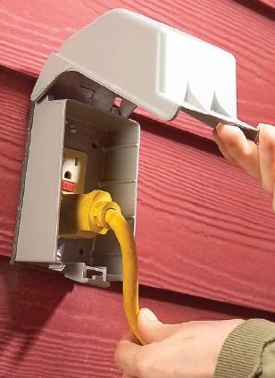

I have an outside dual wall receptacle which I use to plug in small drills, saws, etc. During the Christmas season I use it to plug in outside Christmas lights -- not many. Just a spotlight and a string of lights on the shrubbery. It's always worked just fine. Tonight when I plugged the lights in, they didn't come on except for a tiny glow in the spotlight. But most puzzling of all is that a small, square amber light about half of an inch in size, located in the center of the receptacle is on.
What on earth does that indicate? It must be trying to tell me something that I should know, such as alerting me to some hazard.
Everything looks just fine in the circuit box -- no tripped switches or anything.
Would appreciate any responses, comments and suggestions.
Thanks in advance ...
notsohandy
I took another look at the receptacle. I think it's a GFI outlet. It has two buttons. One says reset and the other says test. The amber light is about 1/8 of an inch in size.

Just reset that outlet with the yellow light.
YouTube - 809 GFI Reset
If it does not reset you have another issue.

It is a trip indicator light and i find it very useful. when my outlet cover is glowing red and my +2,000 chrismas lights are off, i instantly know it tripped.

Ground fault receptacles do not trip on overloads, only when there is an imbalance of current flow between the "hot" and neutral conductors.
Yes, moisture is a common reason for ground fault receptacles to trip.

I don't know what is causing it to trip unless moisture collects on the plug-in prongs during rainy days
Are you using an in-use cover?

i left out that it trips every time it rains. my receptacle and my field-assembled extension cords have in-use covers.

It is covered. Moisture is probably not getting into the receptacle.
During the day, when the Christmas lights are not plugged in, I leave the cord to them lying on the brick front porch near the receptacle. Maybe the male plug gets moist and when I plug it into the receptale, it trips. Is that likely?

is it covered when it is being used? are you using cords and lights approved for outdoor use? they could be the problem.

I can understand you don't really like the GFCI but I am sorry we will not advise you anything which it will break the NEC code requirment and the GFCI do protect you and prevent any serious electrical shock.
I rather live with few tripped GFCI instead the serious isuse.
The code is allready written couple code cycle back and you have to use the inuse cover to prevent any moisture get into the receptale and with some of older receptale the cover gasket can go bad and get alot of moisture in there to trip the GFCI.

I would suspect the spotlight - unless the gasket is perfect, if its pointing up, water will get in there.
Absolutely. It only takes a split second to trip the GFCI. It could even be the way you're plugging it in. If you angle the plug so the two blades make contact before the ground the GFCI will trip. It may be one of life's little annoyances to have to reset that GFCI every time you plug in the lights, but it is keeping you safe.

Cheapo spotlight is likely culprit
Thanks to all for the helpful responses.
As tribe_fan said, it's probably the gasket in the spotlight. It's old and tilted upwards and exposed to drizzling rain. I need to upgrade to a more substantial, heavy-duty light.
