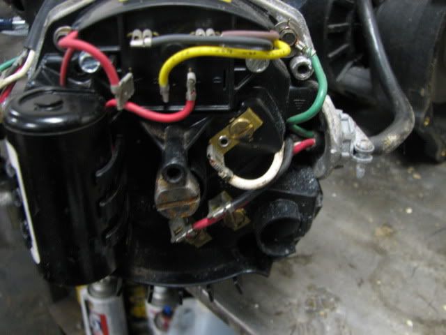

Hi, i have a ge 5kcr39un motor and i would like to know if it is reversible and how to do it if it is. Thanks

What voltage and phase is the motor? What leads do you have available in the wiring compartment? Is there a wiring diagram on the compartment door?

Can you identify which of the wires goes to the capacitor (cylinder on the left)? I can't quite tell from the picture.
Some A/C motors can be reversed by changing the wiring of the start windings and run windings. The trick is identifying which type of motor this is and which windings are run and start.

Most AC motors can be reversed IF both ends of the start and run windings are available. Only permanent magnet type DC motors can be reversed by swapping the supply power polarity. Larger DC motors will have both wound field coils and wound rotors and these require changes with the internal wiring to reverse.

hi, i tried to send a flick but havent figured that one out yet. this particular motor is a two speed, 230 v. it also says 3450/1725. does this mean it can be run as a 120 motor? the outlet and inlet wiring shows two reds , a yellow a black and a brown wire. the plug wires are blck, red , white and green. i know what those are. so two questions: is it reversible and can it run on 120? wish i could show the pics. okay thanks

Unforetally this motour is not reversable at all I don't have the chart with me but the nameplate info stated that is not a reveseable at all and this is a true two speed motor and no it is not capable to run on 120 volts at all due this motour did not list the HP on the nameplate and the way the current drawage I am pretty sure that is that is a least a 2 hp rating on high speed while low speed more like 1/2 HP. { it will be pretty close but it not have actual rating on the nameplate }

SO........can you see my pics? curious. okay thanks for the info. i have one more motor that is a four horse off a spa that i could use but it is also 230 and it says "non reversible " on the side. however, before i thought about it i hooked it up to 120 and it seems to run really well and shows 1.2 amps (which i think is really 12 amps) could it be that this motor is able to run at both voltages. the wiring plate goes like this: b is empty white is line, black and white is line and a is empty. might this motor already be hooked up for 120 if it runs this well? thanks for your help tommy

A 240 volt only motor may start on 120 volts as long as there is no mechanical load but it will not continue to run with a mechanical load.
You MAY be able to take the motor apart, find the common connection between the start and run windings and re-connect the coils but unless you have some serious experience with electric motors you can easily get into trouble attempting this feat.

morning........thank you for the info. i need a motor for my table saw and i just had these layin around so i thought i could use them. first off they turn the wrong way and secondly they are the wrong voltage. so.........guess im off to the store. lol. thanks again and to everyone that helped me here. im sure i will have more questions as time goes by. tommy
