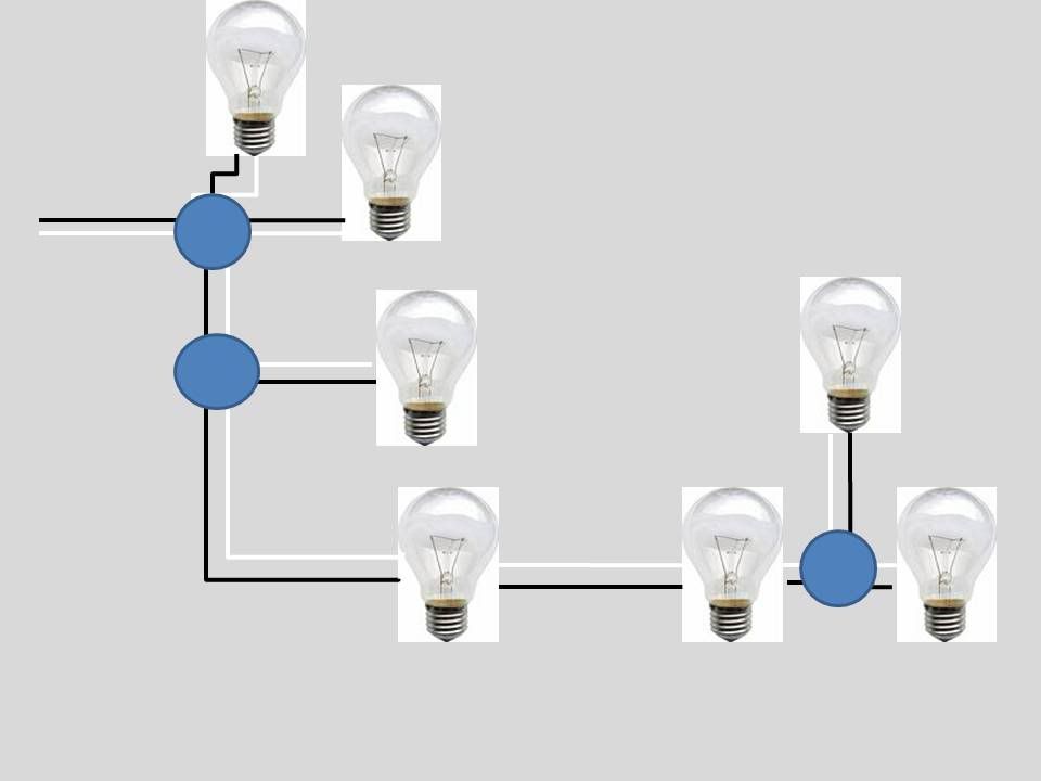

Hi, just to follow up on the parallel diagram, do the lights need to connect directly to each other in sequence or can I branch off in an electrical box to, say, two lights, then run the line on to additional lights? If this doesn't make sense I can send a diagram.
You can branch off just watch you don't exceed box fill.

So this is good, right?

Circles are boxes with splices

Yup! you just need to keep the boxes accessible.

But you don't need extra J-boxes. The J-boxes the lights mount on can be used for that purpose.

They're fluorescents. I can do the splices in the fixtures, but I think sometimes I will save on cable by having a junction box (plus I can add more lights). Make sense?
Yes.
