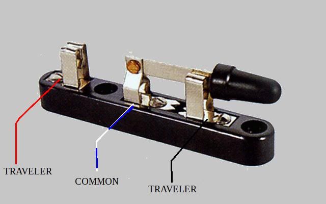

You can use any color wire you want except green or bare. The switches simply transfers line or load from one traveler to the other. The common of one switch goes to load the common of the other switch goes to line. If both line and load commons are connected to the same traveler the light is on. If load common is to one traveler and line common to the other traveler the light is off.
Imagine this knife switch is your three way switch.

Ray,
Ahhh Ok I see... So whatever I choose to use as the "Traveler" I just need to make sure they are both on the same screw right? For example if I use RED on the Right side brass screw of switch 1 I wire that to the right side brass screw of switch 2.
Switches don't have lefts and rights and different manufacturers may use different arrangements of the screws. The travelers are interchangeable. It doesn't mater which screw on each switch so long as it is one of the two travelers screws.
