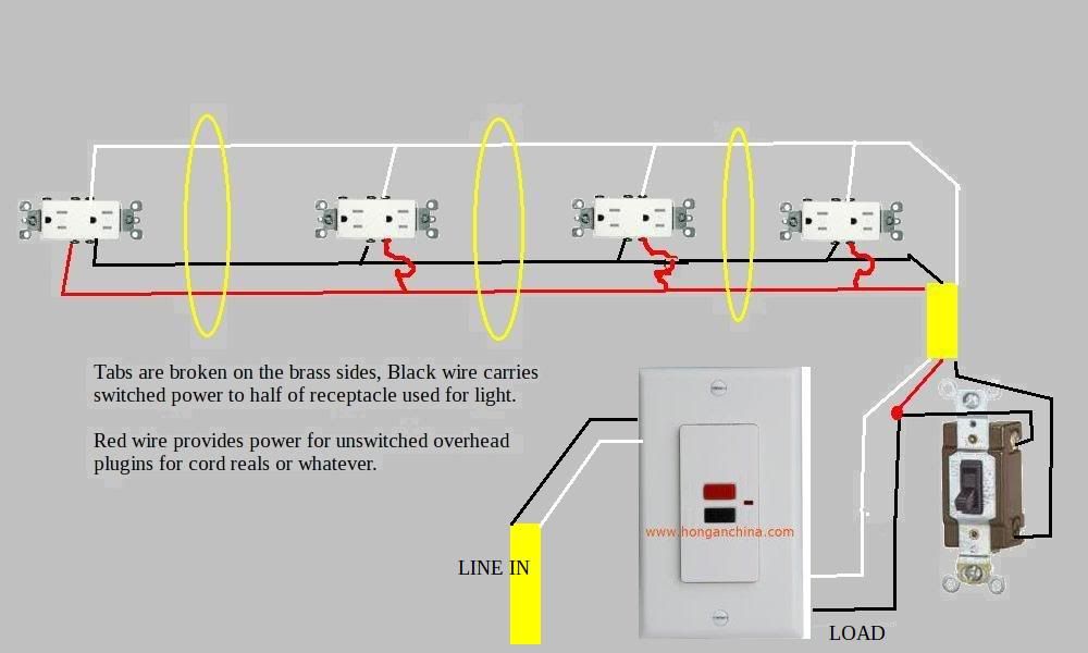

Can someone give me a wiring diagram, I want to run 4 flouresant light fixtures and at least have about 6 outlets. Let me know what all I have to do to pass inspection as far as wire size, how to run wire, etc.

Can you provide some more information? What room is this in? Are you pulling a new circuit? What will the receptacles provide power for?

How many light switches and where will the switch(s) be located?

one switch for the lights, this is for my garage and it will be coming from a sub-panel i put in previously. the switch would be next to the service door entrance.

This is in my garage, there is a sub-panel already run to the garage, from the house. The recepticles will provide power for music equipment, pa system, drills, air compressor, computer, tv.

Will the light fixtures be "hard wired" or will you be using shop lights which utilize a cord and plug?

Best practice to run the lights on a separate circuit. Do you have room in the subpanel for two breakers.

Cord and plug is what will be used for the lights.

I have room for 6 breakers in the subpanel.

I would run 12/3 w/g from the light switch box to the location of each light fixture. This way you could use half of each receptacle to operate the lights and use the other half as an "always hot" receptacle.
Also, run at least one other circuit for wall receptacles.

I know to run 12/3 wire, just want a simple wire diagram for these. I ran the wire from the garage, in conduit, to garage sub-panel, I figured that out with you guys help, and got it done correctly, so hows about a wiring diagram?

Power in goes to the line side of the GFCI load side goes to the the switch. The Blank GFCI and Switch are mounted side by side in a double gang box,
A GFCI switch or GFCI breaker could also be used.

I prefer the switched to be red and the unswitched to be black.

Yes that is the way it is usually done. I just got it backwards but either way is OK.
